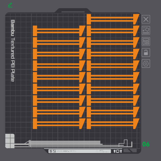

I’ve been cloning parts to fill the print bed, but when I try to arrange them, there always seem to be odd gaps—gaps where I know some of the parts should fit.
Could this be something that changed in a recent update? I’m not entirely sure, since it’s a new part I’m printing, but logically, if they fit, they should still fit. It’s almost like the usable bed size has changed in the software. I’m running the latest version.
I’ve also noticed that when cloning, the orientation matters—since the software won’t auto-rotate the parts, it limits how well they pack. I already know that the Auto Arrange function doesn’t work great.
For example, I manually placed the parts in a way I knew would fit and then tried using Arrange to tighten up the layout. Instead, it threw several parts off the plate completely, requiring a new plate setup.

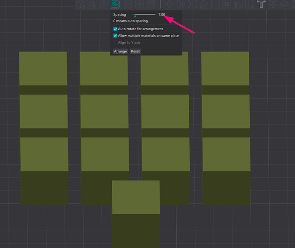

Picture 3 shows the result after using Arrange.

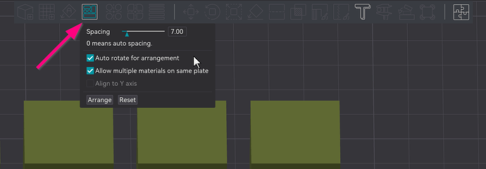

Picture 4 shows my manual layout before arranging, which actually slices and prints just fine.

honestly this has been something i’ve always experienced. the auto-arrange seems to really be hyper-aggressive on giving things enough space.
your best bet is to hold shift and use the arrow keys to very carefully align them OR do what zack does in this video ( https://youtu.be/B4bMm8w1rZY?t=619 ) at 10:20 where he aligns things using tiny spheres if what you’re trying to align isn’t something that’ll happily print in grid formation.
if i were to wager a guess its hyper-aggressive because a single failed part could take out the rest of the print and that likelihood increases the more the plate is filled so it tends to err on the side of caution. you probably already know that tho.

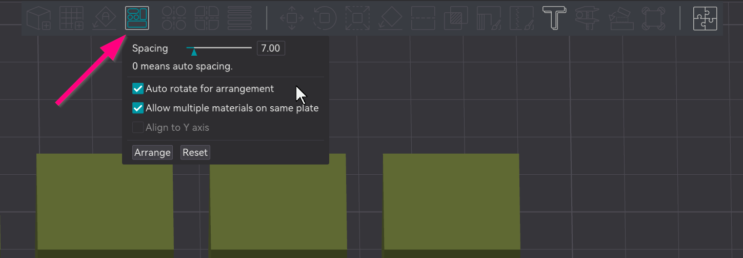

The last 2 pictures showing just the arrange function and it cant even sort that out correctly.
yeah. :\
not much can be done i’m afraid. you’d think with a company that won’t shut up about how its printers have AI detection for stringing or failed prints and how they keep pushing makerlab AI generated nonsense that they’d have a smarter auto-arrange but nope apparenly not.

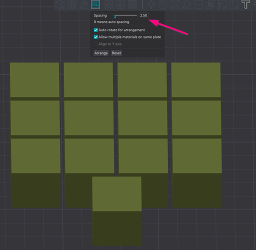

The auto arrange feature can be influence in the arrangement icon menu. Have you tried varying that?
