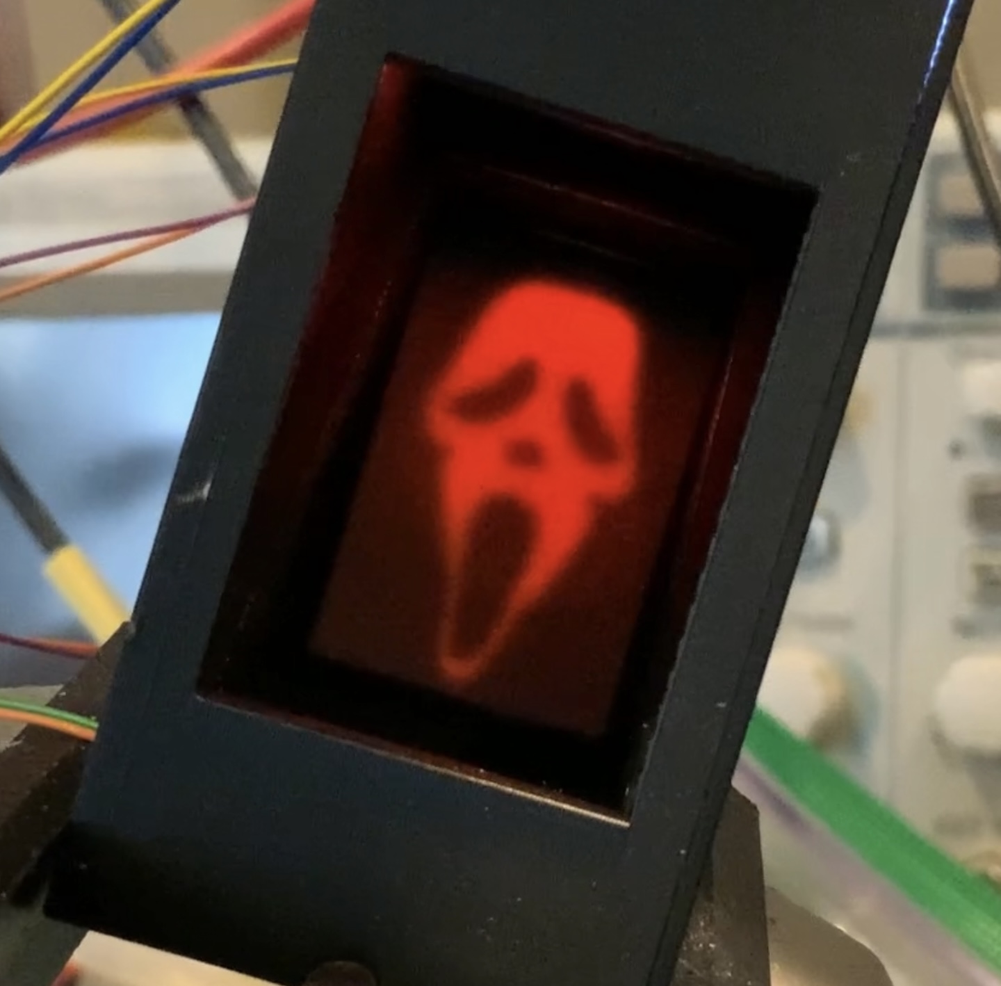

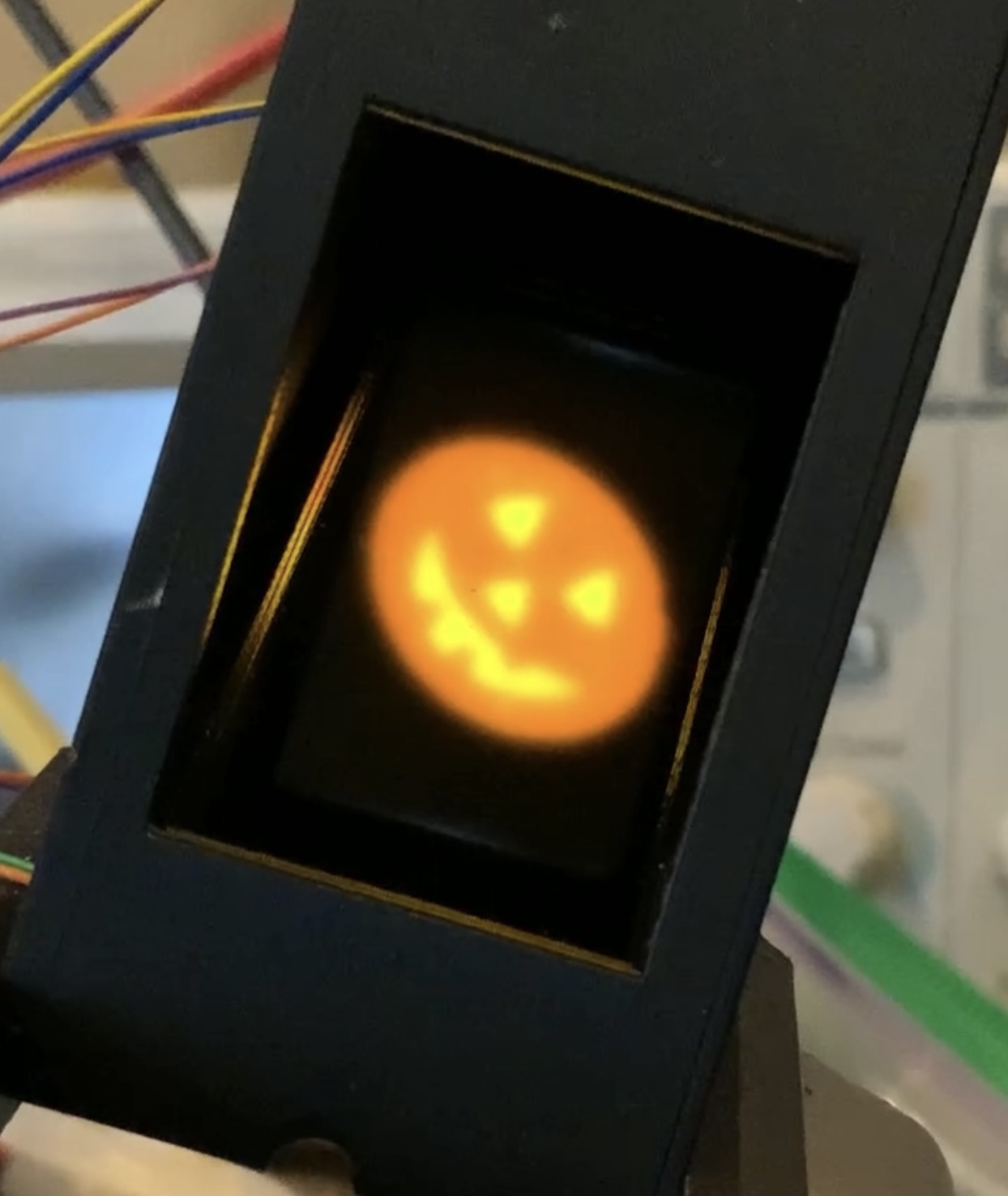

Unfortunately the movie is way too big but here’s the latest in my workshop… Two stills and an image of the device. The portal is 22x32mm. The goal is to use it in diorama-like things. LEDs under PWM control and with a group of these you can do things like imitate a flashlight, room lights turning on and off, and having one or two images be available with no moving parts - just which LEDs you light up. A microscope cover glass is used as the image combiner/beamsplitter. You can also do two-frame animations by alternating which LEDs are on and which are off, do spooky effects like lights flickering and going out, etc.
