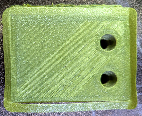

New P1P owner. I have had the printer for a week and have gotten 55 hours of really great quality prints from it. However, 2 days ago, I started having problems with the first layers not going down properly.
Not sure what has happened. I have tried doing a calibration, first through the Bambu Studio interface and then through the panel on the machine, but nothing seems to work. I also tried switching the 0.4 nozzle with a 0.2, but the problem persists. The machine has also started having problems with simple overhangs:
Before it was printing overhangs like this without any problems.
Any thoughts or suggestions?

Is the cooling fan working? Is the hotend heatsink fan working?
Move the bed down some and position the head in the middle, heat the nozzle up to 220 and extrude, does it look normal?
Have you tried different filament? What kind of filament is this? Is it dry?
Try drying that filament.
Your first layer pics gave the vibe that maybe you need to clean the plate (plain dishwashing soap, HOT water, clean nonabrasive pad - it cant hurt, just do it anyways) but that last pic is really off. That overhang looks to be only like 45degrees and its a horrorshow! Dry the filament, clean the plate, do a machine calibration (menu → settings → maintenance) and give it another try. Perhaps flow RATE calibration too.
What filament type/vendor is it?
The heatsink fan is working, but I found the parts cooling fan disconnected. Not sure if that happened while I was stripping down the extruder.
The green filament is Eryone CF-PETG. I have tried other filaments with the same results. One element of the print will have a bad first layer, all of the others elements will be fine.

And doesn’t matter the brand, it’s wet.
If that’s CF-PETG, it needs drying. And after that, you should do a temp tower test, and think about making a selection that is lower than your current temp.
CF PETG should be able to take those overhangs like a CHAMPION. Something is wrong!
Also just cuz CF - you have replaced your stock P1 nozzle with a hardened one, right?

This is classic contaminated plate. Those voids are fingerprints.
For a comprehensive explanation and a set of diagnostic methods to prove to yourself where and how badly your build plate is contaminated, reference this link:
Textured build plates are great but the conceal dirt. Here is an example of fingerprints and their effect on a smooth plate where it is much more obvious.

@zogthegreat, I think you had 3 issues:
  • partial clog because of chopped carbon fibre, when it retracted or released the pressure at nozzle when changing print direction, that piece carbon fibre chop rearranged itself and this time went through the nozzle and clear the clog.
  • dirty build plate and/or bed temp not hot enough, or maybe a bit too fast on first layer, PETG wants to print slow
  • part cooling fan may not work or not enough cooling → bad over hang

I took your advice and dropped the filament into a food dehydrator over night. It seems to have done the trick.
Yeah, I’m used to klipper, which I think is better to Marlin/Octoprint, although I was using Octoprint for my Sovol before I converted it to klipper. As for hair spray, I can’t find one without perfume and the ones with perfume triggers my allergies.
As for my print cabinet, it was a matter of necessity. My printer is in my bedroom and about 1m from my bed! I need my beauty rest!
Thanks for the tip and the link. I washed down my build plate with dish soap, (can’t find Dawn in Canada), and then again with IPA. My prints are adhering properly now.
I did the temp tower as you suggested, (and as I should have done with a new printer!), and I increased my temperatures based on the tower results. Getting really great prints now. Thanks!
