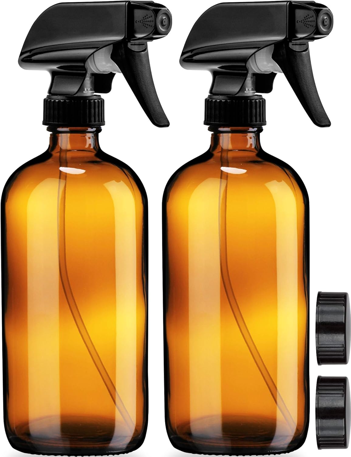

In addition to that, get a high volume sprayer which will flood the surface of the plate. This is much more effective than using a rag and will wash away the contaminants with a forceful blast. Here’s two examples that I found effective. One is made of glass and the other, wide mouth. They both have a jet option which is useful and acts almost like a pressure washer.
This one has the highest blast pressure and is designed to be used with harsh chemicals. The only drawback is the narrow neck of the bottle.
https://www.amazon.com/dp/B01LXTNPFS/
