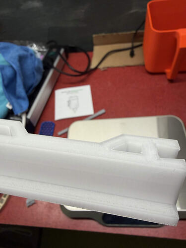

Here are some photos of a bad print, the fuzzy lines even have a gradient from “good” to “bad” fuzzy top its sorta “anti-ironing” i think it could be the auxilary fan doing the oposite of what it should do.

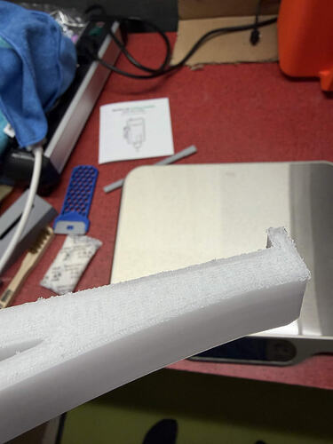

I know its not great visible here but this is another issue i saw with the piece nearest to the auxilary fan.
My next thing will be probably that 45* difuser model someone made for the h2 series. I would think this could help you out too.
I think the new beta version includes a fix:
Improved motor noise-related surface defects at low speeds.
As for me i used the default speed profile, maybe that is at least the fuzzy top layer
