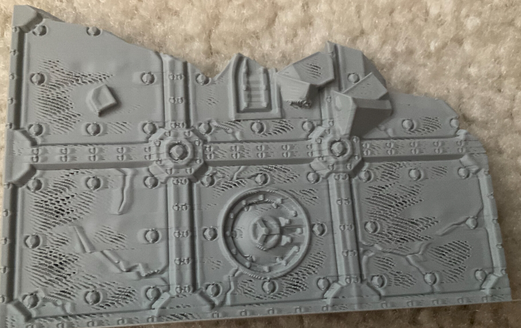

I just did the flow dynamics and flow rate calibration on my p1s. Everything was looking much better on my prints, until about 3 prints later. Suddenly it’s missing the layers, it’s ruining prints because of of extremely noticeable print lines. At some points it just doesn’t adhere and you can see through it. Other times the filament just starts fraying. It just slowly gets worse. First the lines are suddenly noticeable. Then, it’s as if it missed layers. Then it suddenly just doesn’t work at all. Please let me know how to fix this. I have a .4 mm nozzle.
0.16 fine quality
Black pla and gray pla
Nozzle: 215
Heatbed: 55

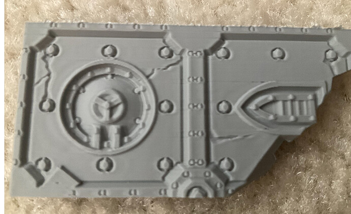

Print lines become noticeable

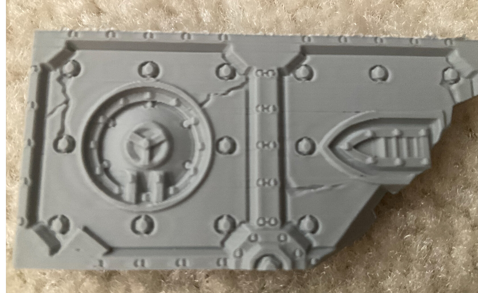

It’s now just missing lines (this is after the print before)

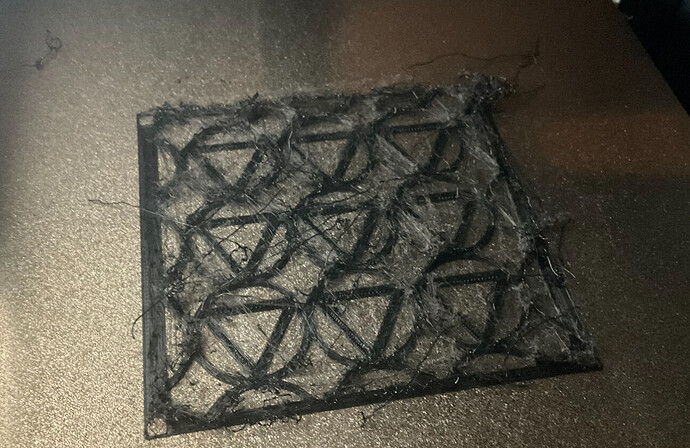

The last print just completely failed.
I am scared to print more things because it seems to only get worse.
It does look like a nozzle clog.
Nozzle/Hotend Unclogging Procedure for X1/P1 | Bambu Lab Wiki
I have never had much luck with anything other than the “Hot hex wrench” method though. And best to do it 2-3 times in a row, just to be on the safe side.
Other causes for this type of error are usually too much friction in the PTFE’s, dirt/dust/residue in the extruder or (very rare) really bad filament (i.e. far from round).
