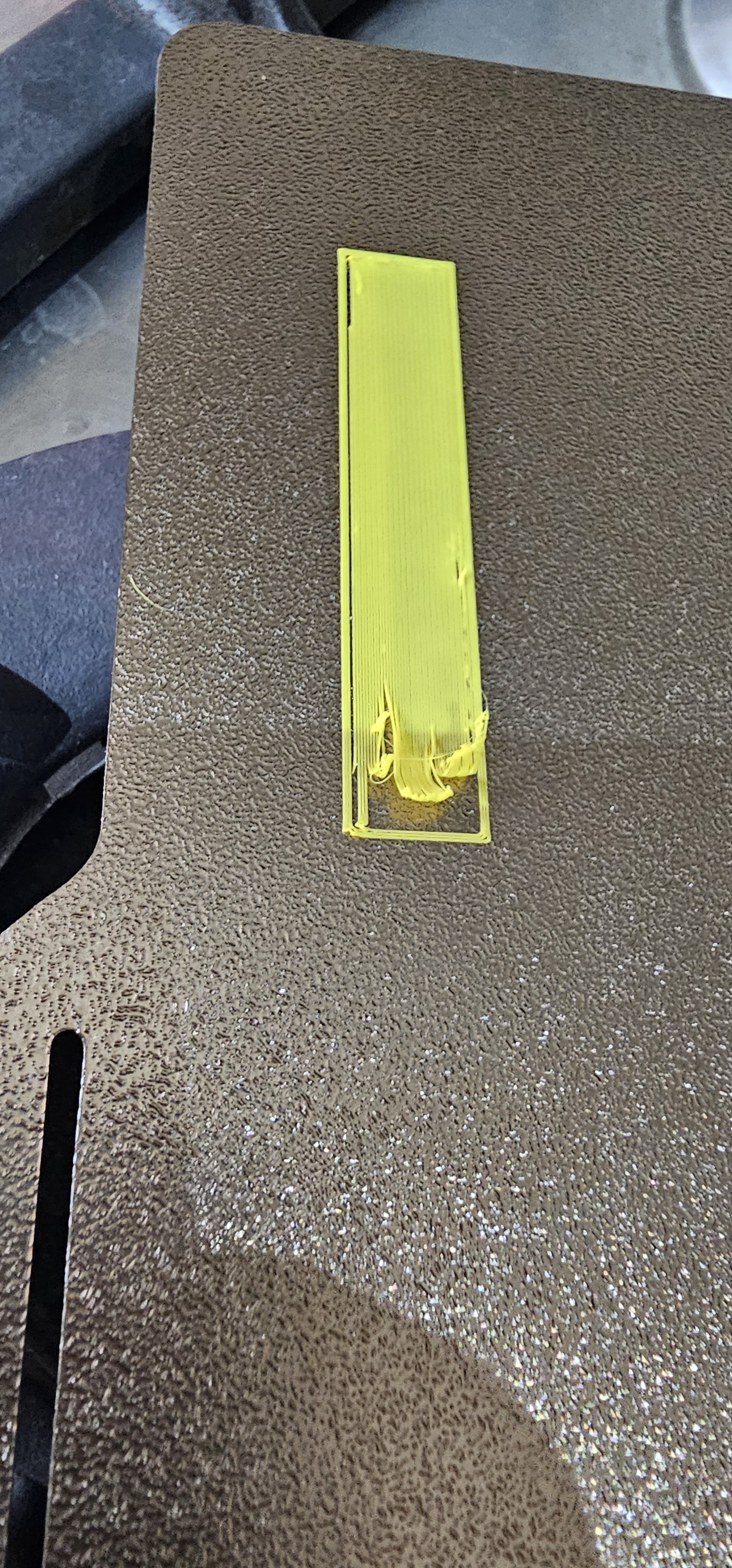

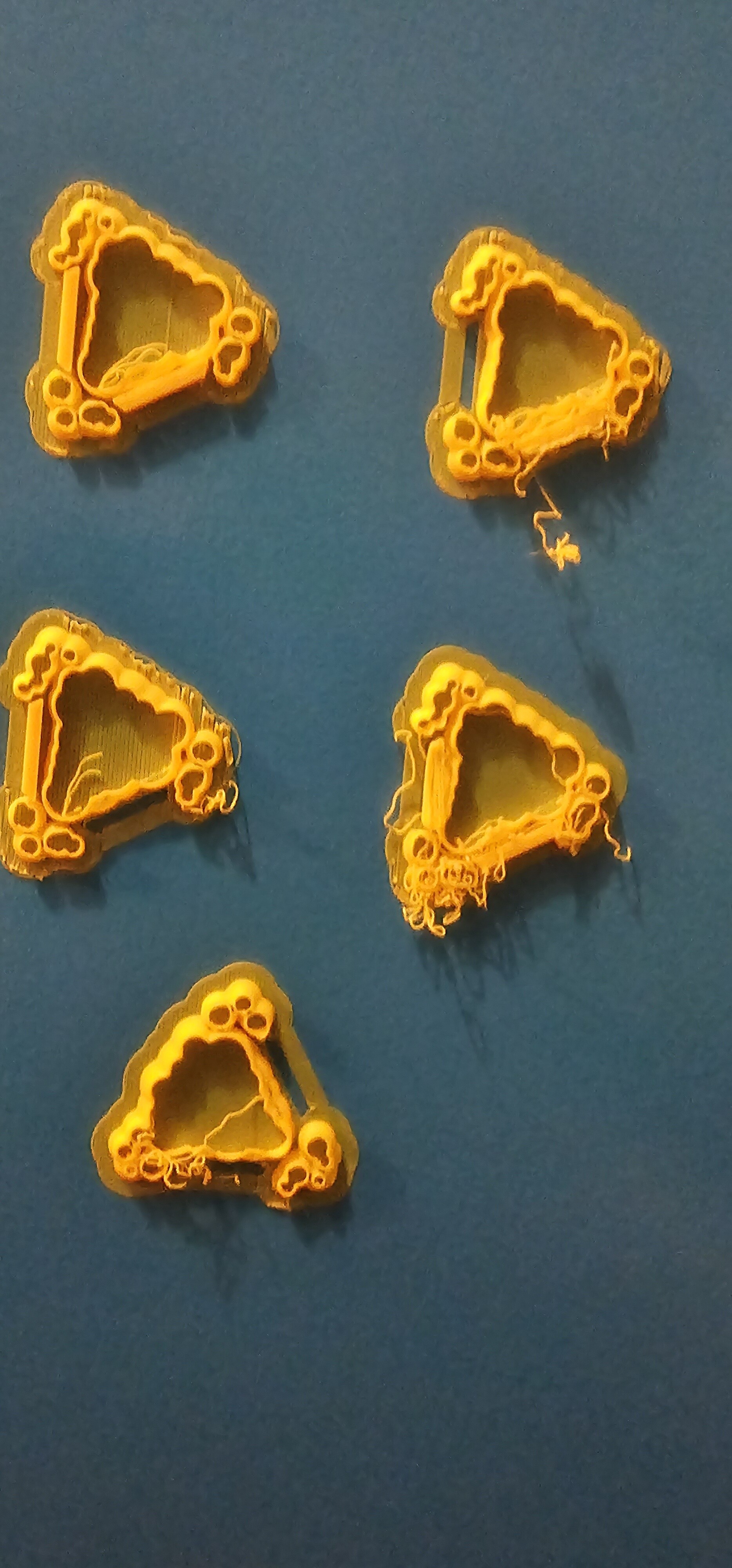

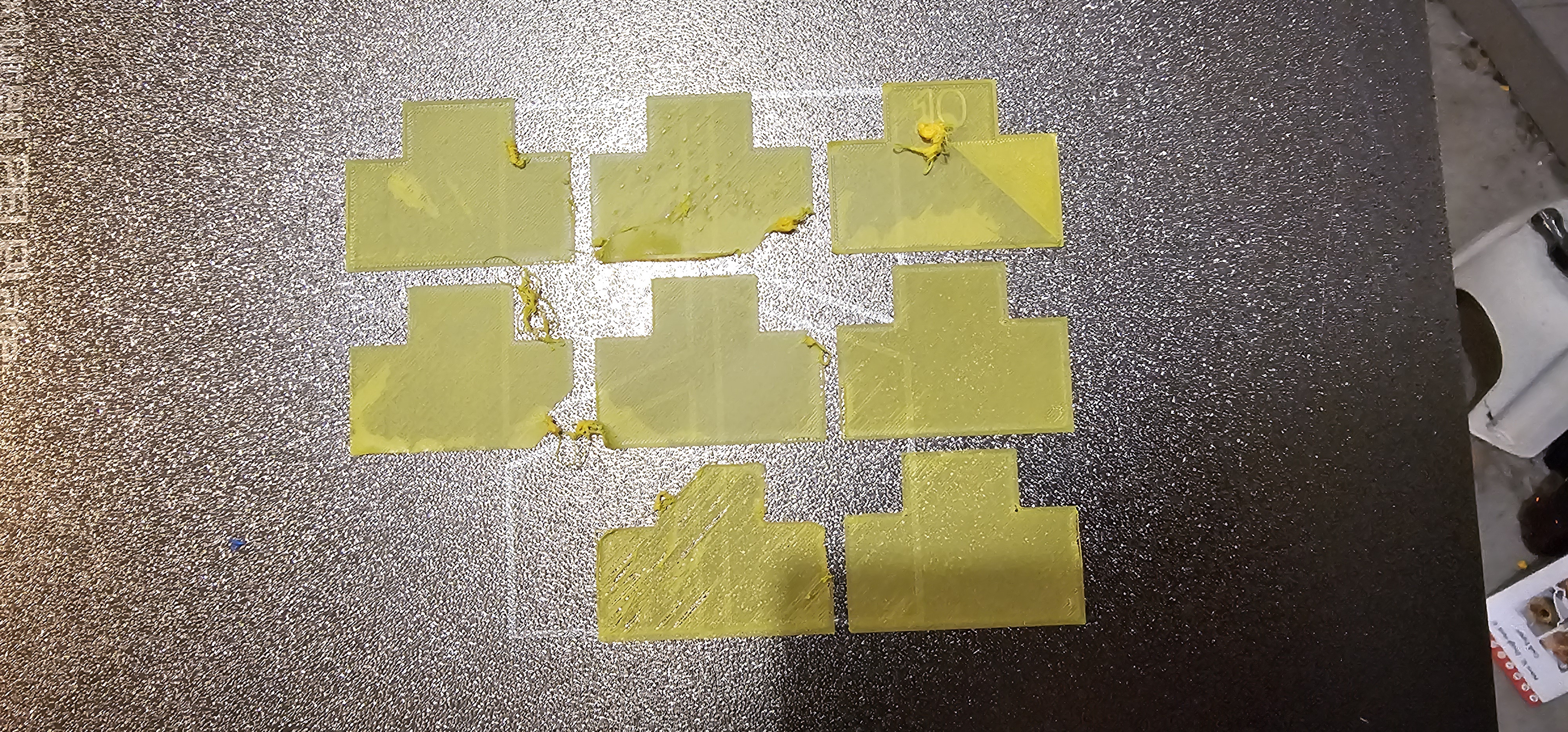

I’ve been printing a bunch of board game components using a 0.2mm nozzle with no problem. P2S, Bambu PLA
Suddenly, I can’t get a print. Bed adhesion fails, and I get stringing. It looks like the nozzle might be scraping the first layer because right from the start there’s some parts of the first layer in the air, and there are scrape marks too.
I’ve done the calibrations, even used a brand new nozzle, switched build plates to the Biqu Cryogrip, no change. No idea why it’s suddenly not working?
I have recently cleaned and lubricated the z-screws but I can’t see how that would impact it.
I’m using the 0.10mm profile (previously I was setting it myself at 0.08mm with no issue)
I can’t even perform flow calibration successfully. I have dried the filament (several times),
Interestingly, the problems usually occur most on the left side of the build plate (and I do have an airflow deflector in place)
0.4mm works fine (well, I’ve had some stringing, but I had also played around with support settings so wasn’t sure if I did something wrong there)

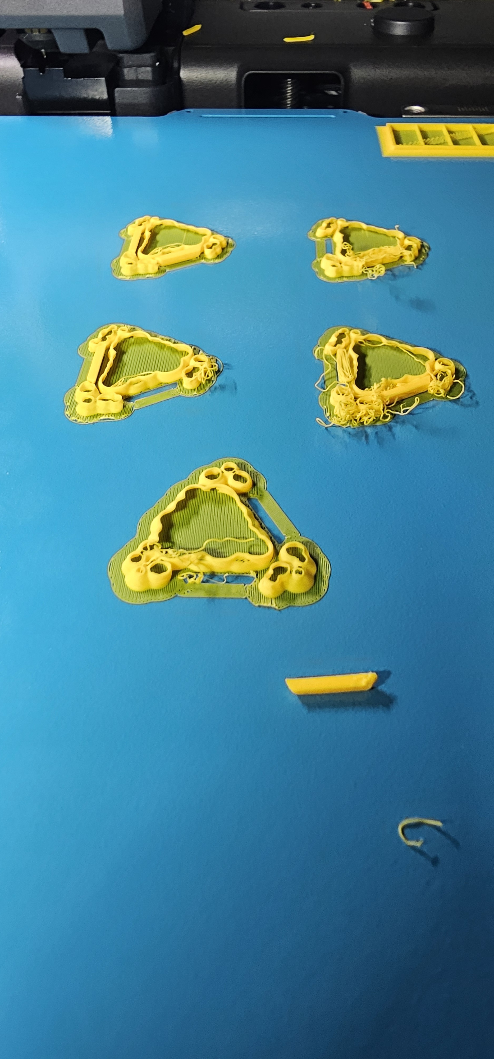

Have you tried re-printing one of the files that succeeded before?
Yeah, printing the same file i did before.
I just dropped the temp down to 220, that seems to help but still doesn’t explain the change, and still not perfect.
On a 0.4mm my flow rate seems to have changed too….doing the calibrationi now have to select -5 when it was 0 before
Apologies if this is overly obvious, but have you cleaned your print plates?
Adhesion improves dramatically with a little dish soap and hot water, and the amount of oil required to ruin it is nearly invisible. I’ve learned to only grab mine from the edges.
