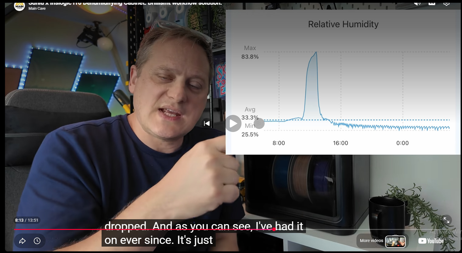

I had posted this earlier in the thread when the only info available was from the youtubers posted on the sunlu website. Now, looking back on it with benefit of @mzip’s screen capture from CNC kitchen for comparison, I can see that I had misinterpreted it. Originally I had thought the big 80%+RHY spike was from him opening the cabinet door to maybe add some filament or something and that each of the subsequent oscillations was a regeneration cycle. Based on what we now know, that seems wrong. Instead, I’m now assuming that the huge spike in RH% was incurred during a single regeneration. Although roughly double the RH% magnitude, the time duration would be more consistent with time interval spent regenerating that CNC kitchen observed in the screenshot that @mzip posted.
So, with that as the new frame, one question would be why was the magnitude of the RH% spike so much worse (neary double) than what CNC kitchen observed? Another question would be: just what exactly are those much smaller humidity oscillations that happen afterward? Is it the chamber fan cycling on and off to ensure a uniform humidity inside the cabinet?
I remember that now. A few things - his baseline is way high - 33% or so - so that’s a 50% RH spike compared to around 25% RH jump in the CNC video that had a baseline around 15%.
I can’t say for certain, but it could be the humidity spike is bigger because the sieves are more saturated with water. When the sieves get heated there will be more water coming off them than in the CNC video which had the sieves starting regeneration from around 15% RH.
On that sawtooth pattern after that, hard to say. It’s not even that regular for it to be a fan cycling until after some hours it looks. Maybe some kind of electrical interference or something?
Maybe eddies and currents in the cabinet from the fan? With a 33% baseline give or take, there would be lots of water moving in that cabinet and maybe there’s a wet spool away from the sensor that has water get wafted away or something? Humid air is buoyant so it could be bubbles of humid air being generated in the cabinet?
All a reach. I suspect the sawtooth is real but explaining it is hard.

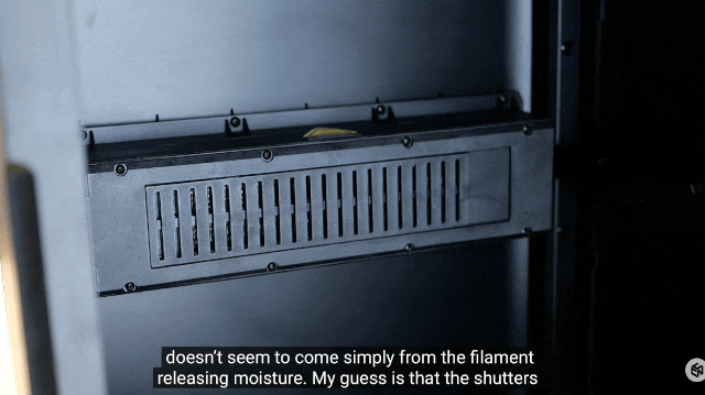

I went back to CNC Kitchen’s video, and he corroborates this:
sunlu-fiadc-i10-interior-vent
(which brings us back to Mzip’s observation that sliding doors can have a decent seal, but that’s dependent on careful design and precise manufacturing & assembly processes. I suspect Sunlu decided that was not a hill worth climbing.)
But we may be able to help it out some with some silicone oil or very light grease depending on compatibility. Down side is that would probably attract dust especially considering there is a fan keeping air circulating. Thinking about the dust aspect I doubt I’d ever try silicone oil though.
If it’s a problem though, @krellboy’s backpressure idea would be clean.
And outside the box a little, depending on the leak rate, slow filling of a balloon in the cabinet would also supply backpressure by displacing air. With a balloon it wouldn’t need to be a dry air source that inflates it.
