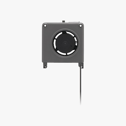

Kevin, how did you make out? It looks like you ducts may be melted (not a part that can be ordered). I need just the duct(s) for the part cooler. Do I need the entire hot end?
If you have an H2S, this is what you want. Click on the second image, not the first.
If you have an H2C/D, go with what @Steve_KA5YFC said.
This is an H2S thread, so I’d assume they want H2S parts.
That’s for the H2C/D only.
Yeah, I realized that it was for the C/D but I couldn’t find the thread again until you commented. My bad. Deleted.
Thank you. When I had visited there, the slide showing the sled-look to confirm the part was not showing for me.
