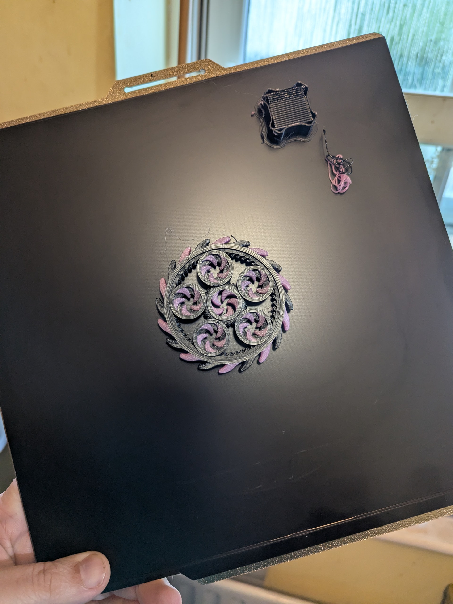

Printing black filament on black garolite is very hard to observe on the built-in camera with the default lighting. It’s all too dark to see any detail. I definitely need to upgrade the X1C lighting before I run into trouble.

I am new to Bambu, I have only had a P1S now for 2 weeks. For the first week, everything was awesome, just hit print and walk away. I’ve been printing strictly PLA to get familiar with the new style machine. This lasted about 4 days, every single print since, failed, it would not stick to the plate, no matter what I did. I tried washing with dawn between, cleaning with IPA, hairspray, brims, fan speed, different filament, nozzle, everything I could think of. With all my Crealitys, my best luck was glass, the black ultra flex magnetic, and G10.
The only luck I’ve finally found is a raft (which I’ve never used) and slowed everything until the 5th layer, down to 50 mm/s. I’m still having to wash the plate every other print, but no hairspray or anything.
Is this normal? Does the G10 and glass work as well with the P1S? I’m just looking for options, and praying I can speed back up to default settings.

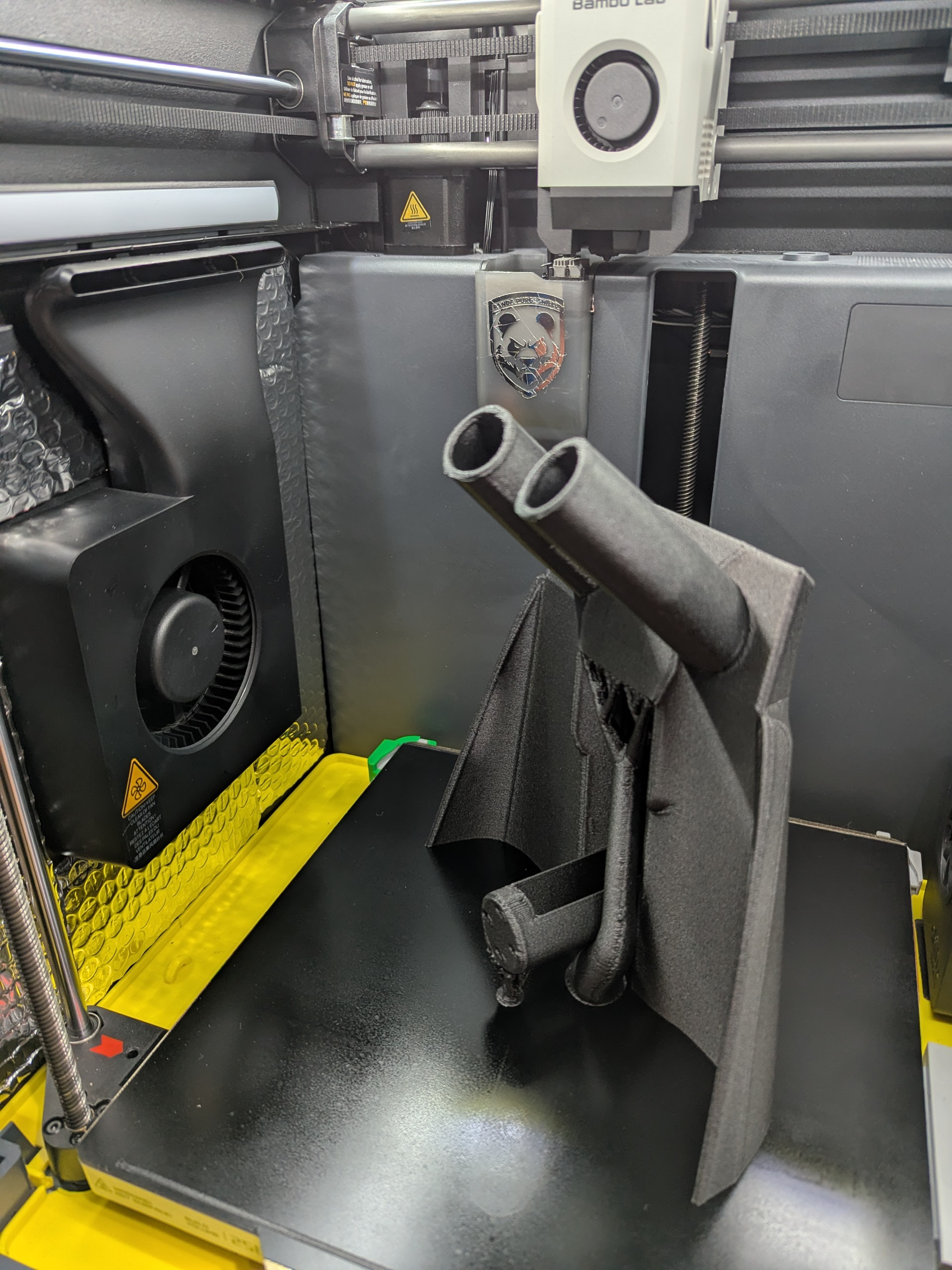

I’ve recently made a G10/FR4 garolite plate which has been working really well for everything I’ve thrown at it, so for Nylons I wanted to give G11/FR5 a go. Can anyone recommend a supplier who ships G11 FR5 to the UK? Preferably, I’d be after a sheet 0.3-0.5mm thick.
The G10 sheet has happily accepted PPA-CF, PETG-CF, PETG and ASA. I’ve not tested ABS/CF yet but I’m sure that’ll be fine. The PPA-CF had 3DLAC spray on glue since my reading leads me to believe that’s prudent, possibly for warping and possibly for easy release. No ears or brim was used on the PPA-CF.
If you wanted to make your own I found a 0.3mm thick and adhered to a cheap steel plate using 3M 300LSE Double Sided Adhesive Tape. All prints came from modded P1S with heated chamber add-on and some insulation. No warping so far with 55C chamber.

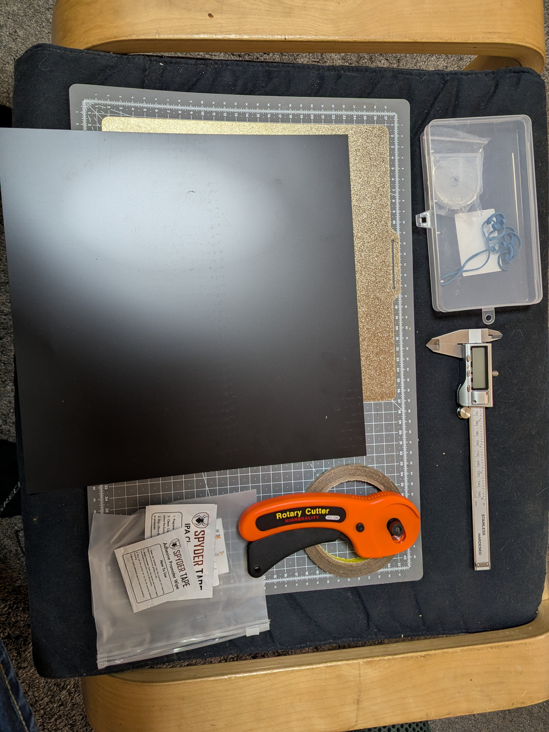

Now that I can add photos, here we go.

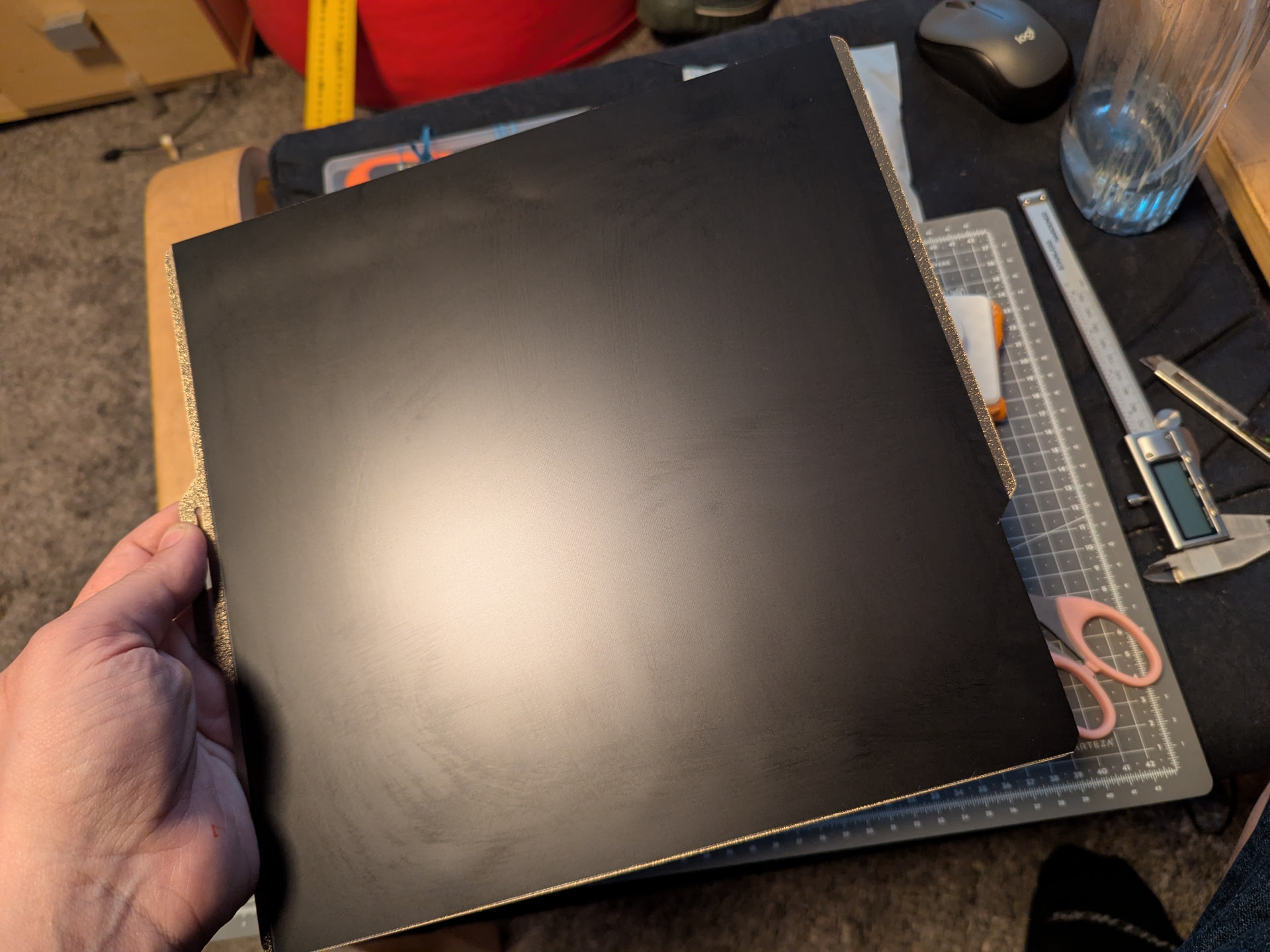

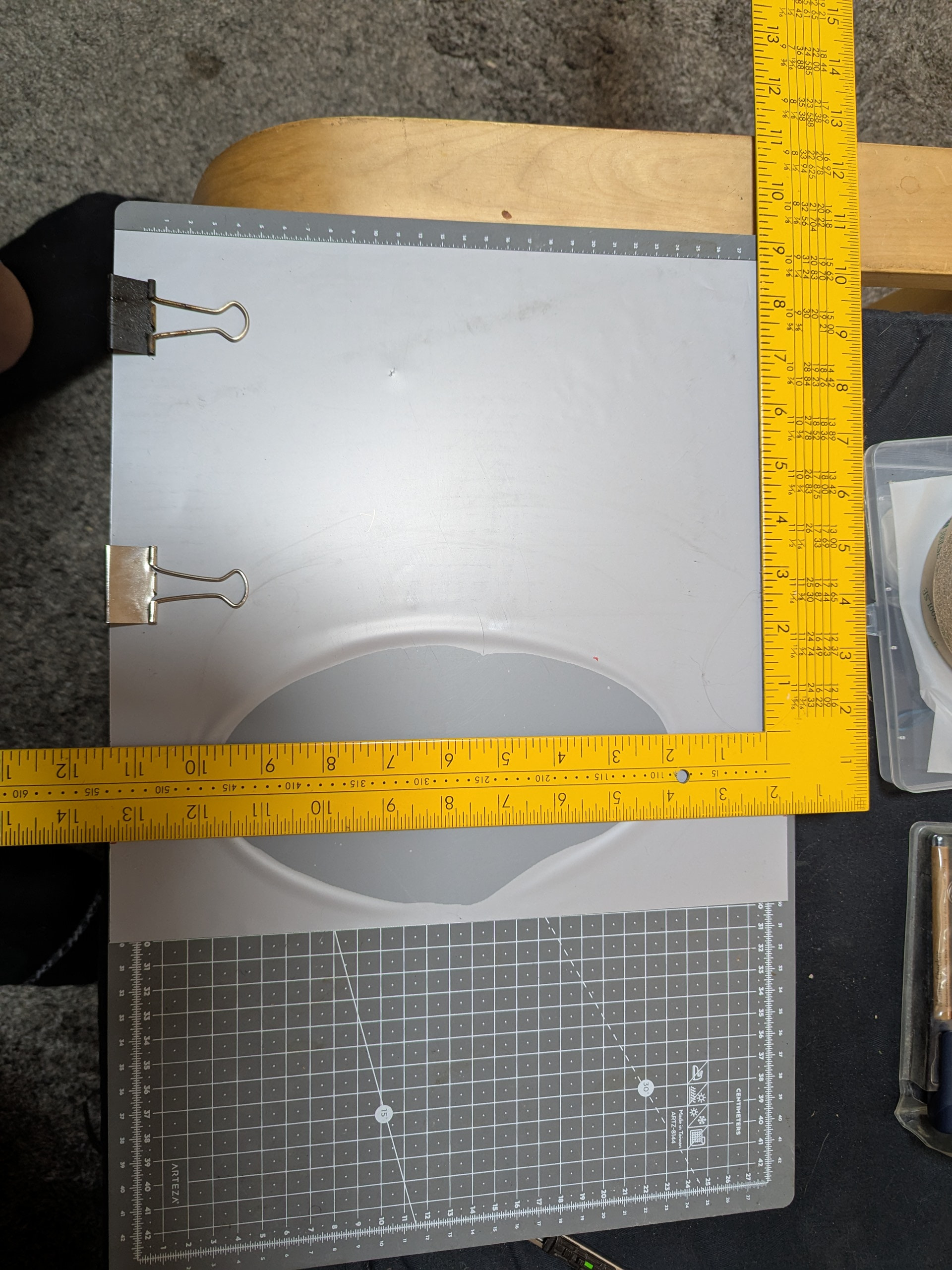

Gather your parts. The 300mm square sheet needs a trim and I’ve no CNC machine :stuck_out_tongue: The roller cutter wasn’t needed in the end, I just ended up scoring along a straight edge with a sharp blade and it snaps off fine. You can also use sharp scissors if its this sort of thickness.
Measure twice, cut once :slight_smile:

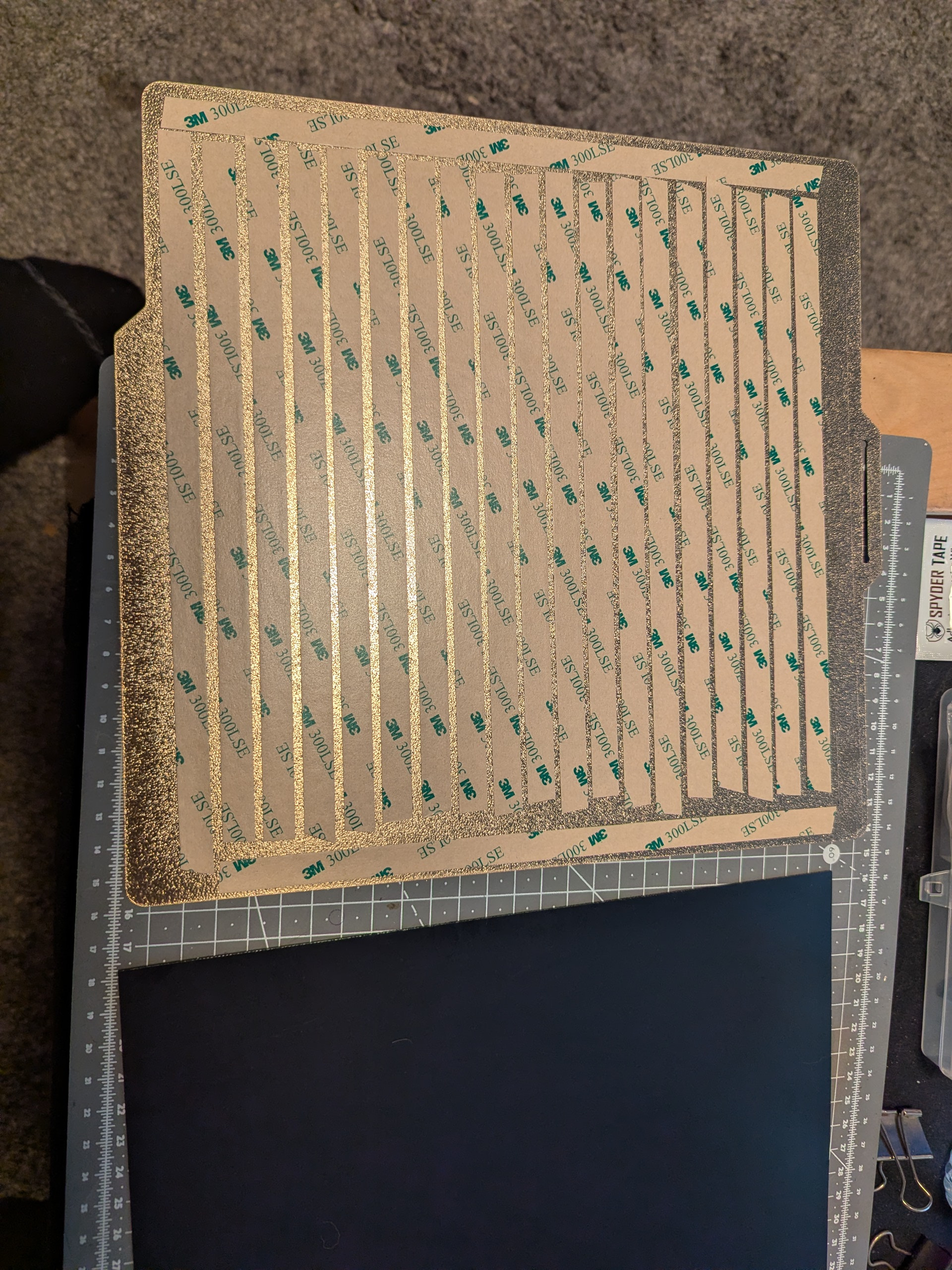

3M adhesive carefully placed. Don’t let any tape overlap as this will make for an uneven surface. Use the supplied cleaning cloth/ISO on your cheap sacrificial SS plate. The tape is a bit finicky to peal off so make sure you’ve got the nails for it or some tweezers.
Trimmed sheet around the edges and finished. You can clean the sheet with ISO or window cleaning spray. It’ll be fine with glues too which I do recommend for nylons, but everything else just comes away once its cooled.

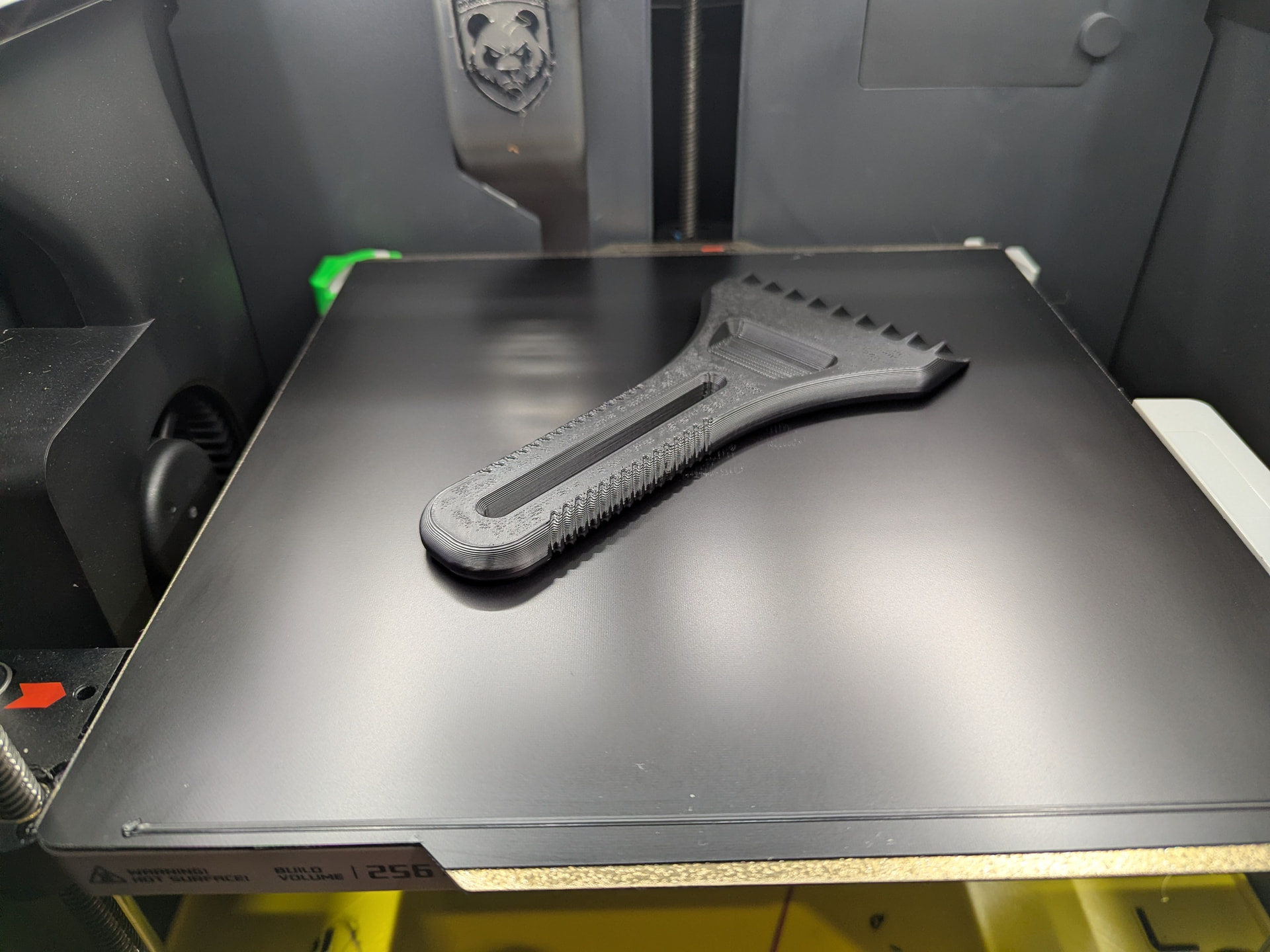

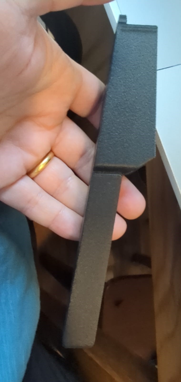

ASA first test print, no chamber heater yet, just used the bed to warm up to 38C

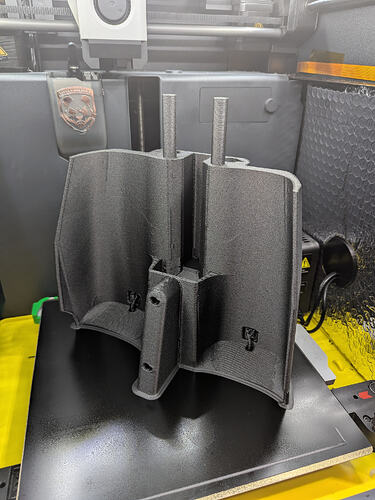

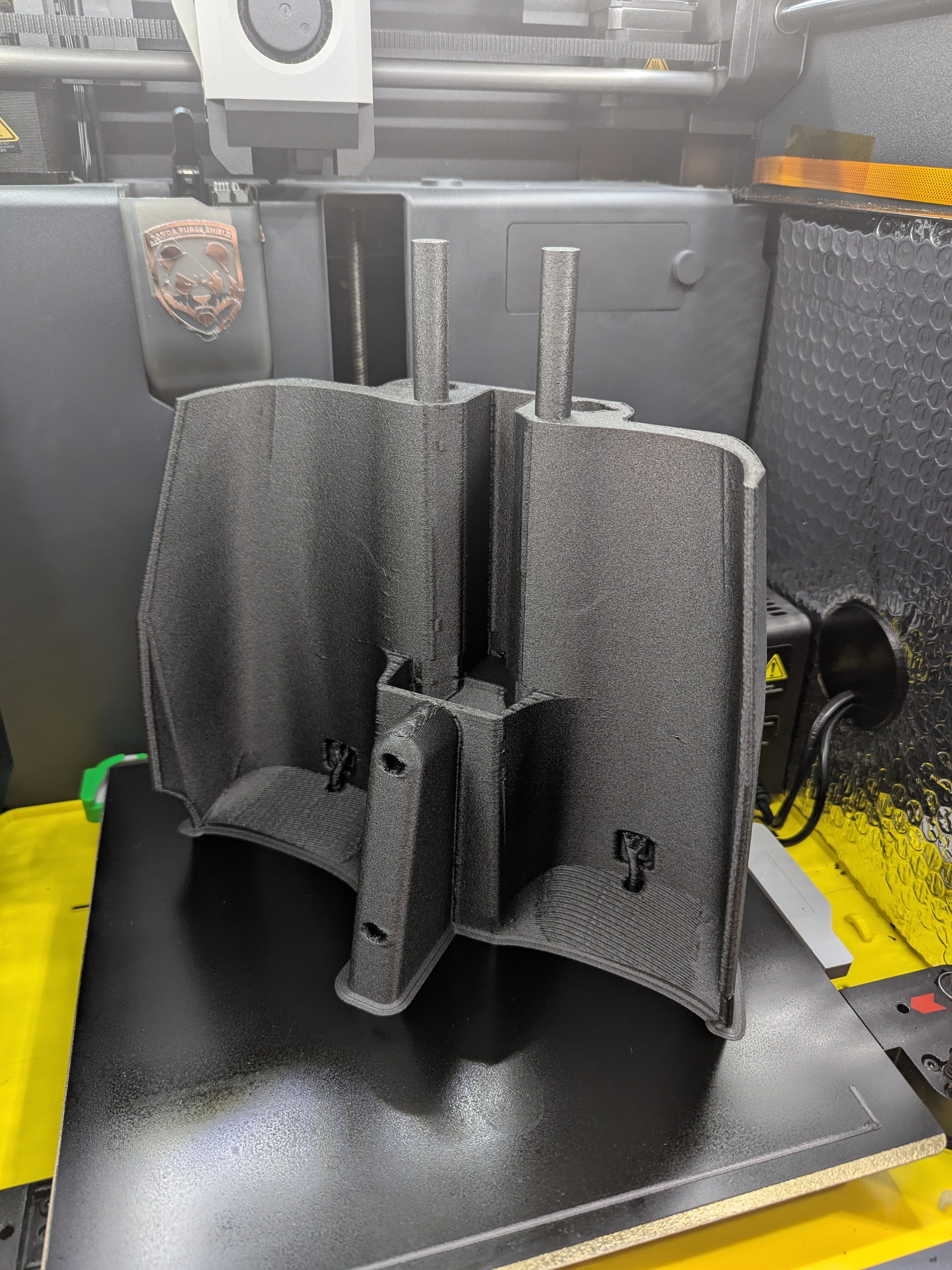

First PPA-CF part. This is after installing insulation and heater to get the chamber up to 55C consistently.
PPA-CF (first large piece had brim, but realised didn’t need it after that)
2nd PPA-CF part, no brim

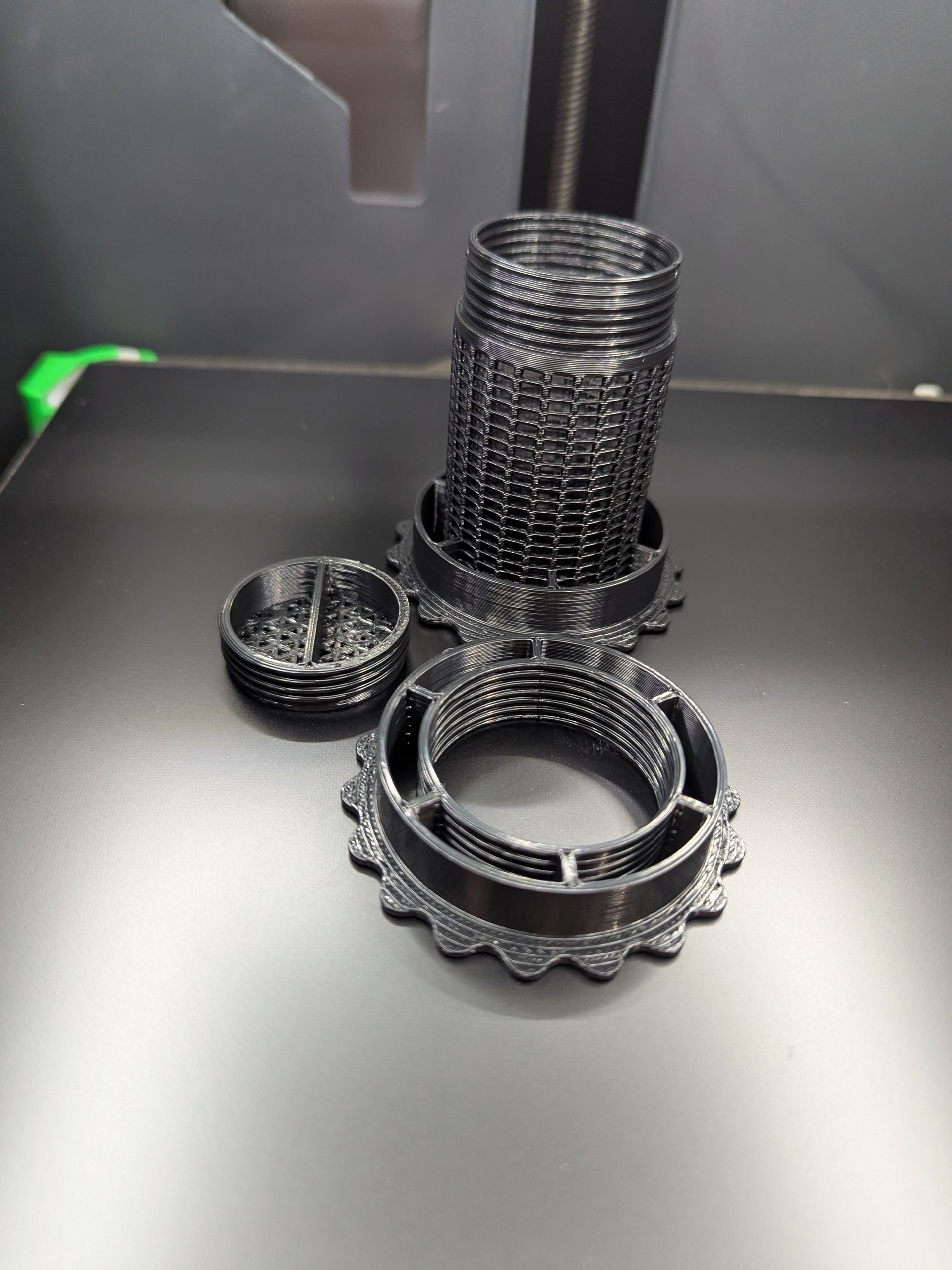

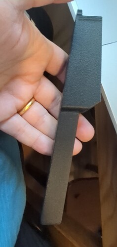

PETG-HF
ASA
