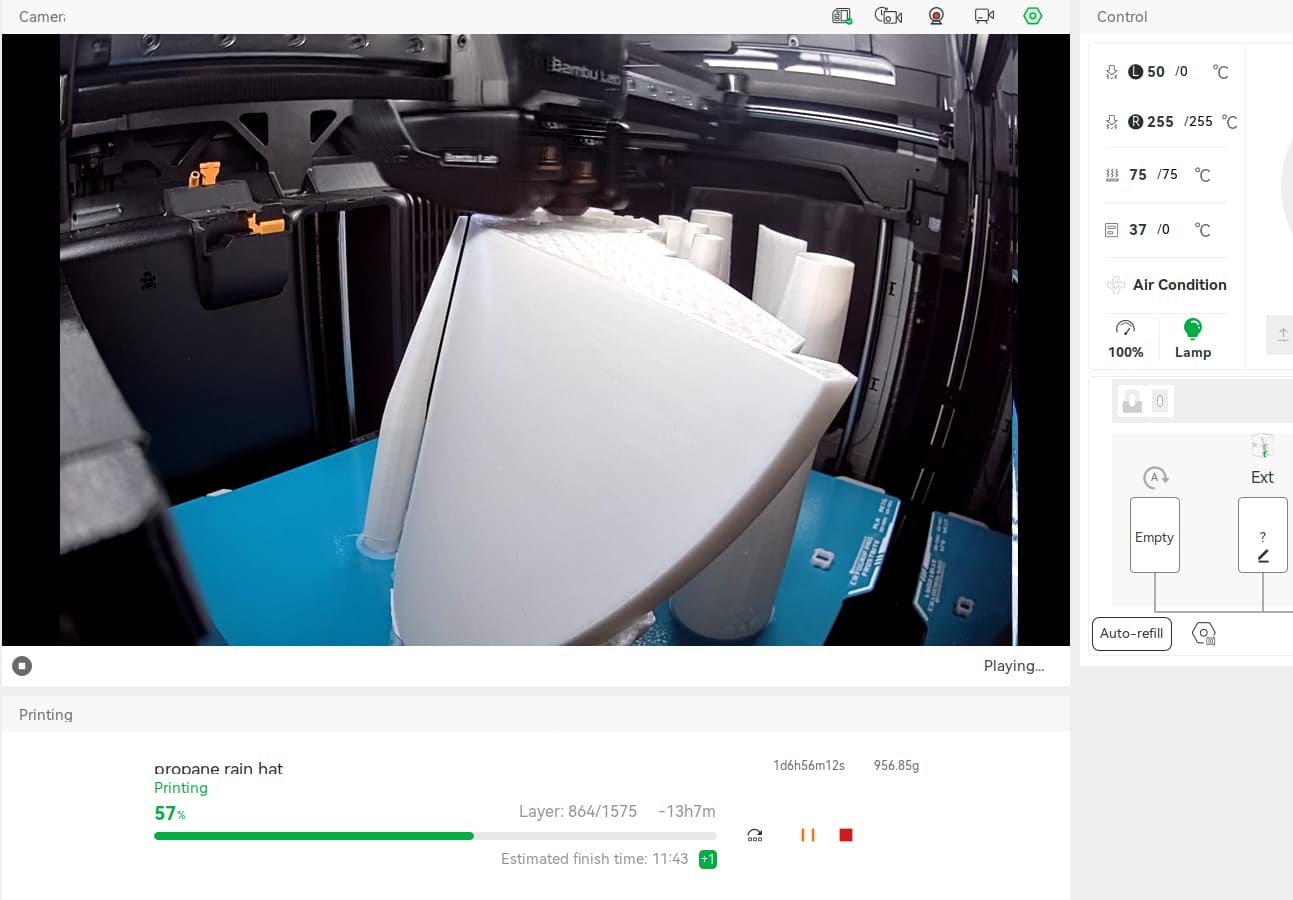

I’m a bit more than half-way through a 31 hour print, and so far my Sunlu HS-PETG is sticking well to my brand new Frostbite Pro H2D plate:
I’m new to it, so I hope I’m not repeating old news, but I notice people are referring only to their “Frostbite” plate, not their “Frostbite Pro” plate. Maybe this is just shorthand, but if not, be aware that the pro plate is alleged to have better adhesion and be more resilient than its non-pro predecessor.
As suggested by the flyer that came with it, I’m also running mine at 75C for improved adhesion. I’m pretty sure higher hotend temperature on the first layer also helps strengthen the adhesion.

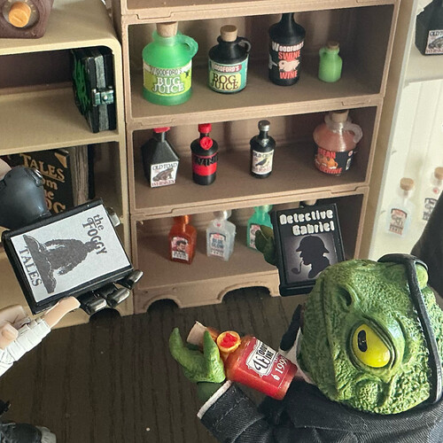

The Bambu Lab Supertac having too much adhesion that sometimes breaks the part or nearly pulls off the plate surface is exactly what I am looking for. I have a need to print parts as small as 5mm poles with no brim as well as large flat parts with no chance of warping. The Frostbite will do most of the time but not as much as the Supertac. I’ve had small parts fail on the Frostbite that never fail on the Supertac. I love to have to ripp the part off the plate. It is definitely not for everybody but for someone like me that prints miniatures in 1/12 scale the Supertac pays for itself.
Example, I print these tiny bottles and jugs with removable wood pla cork. The bottles are translucent with glow in the dark colors inside for the liquid. I also print lots of books in parts.
