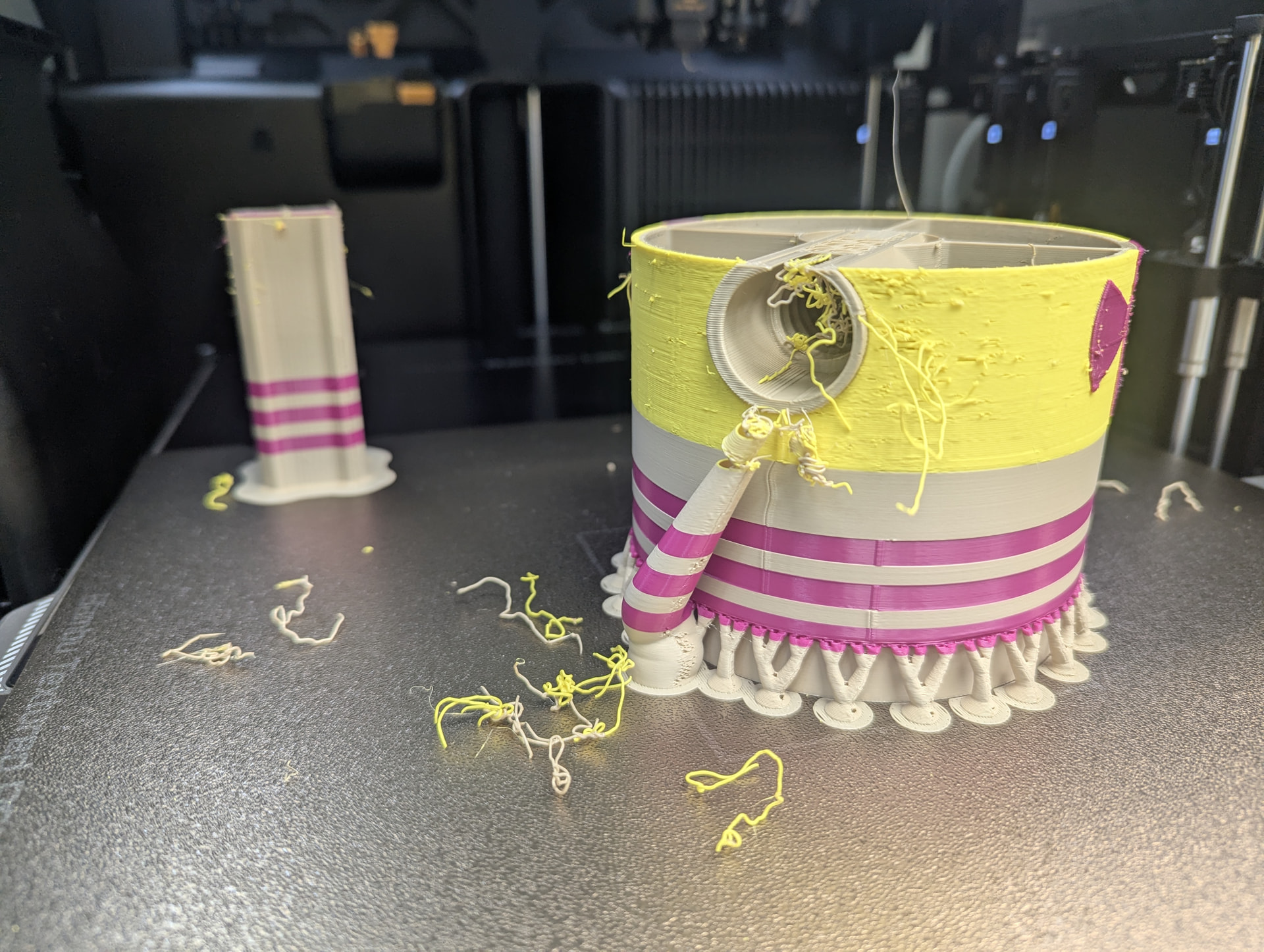

I hope someone can offer some direction. I have a part that I have printed successfully many times, 12 or more, and never had a problem like this. Here is knowns, H2C, All Filament brand new, All Filament Dried 6 hours @ 65C. Then put in Printer, Same problem happened with other colors, filament from other mfrs. All Filament PETG. No Support Filament Used. First part of print looks good and always has, get to point where Yellow kicks in and problem starts. Changed Suppliers of Yellow thinking that was it? Think I many have adjusted something in Support Settings inadvertently. Did not want to upload a lot of data or info with request or permission. Hope someone can shed some light on this for me. Thank you for any help you may offer.
That yellow looks like it’s flowing really badly.
What specific filament is it?

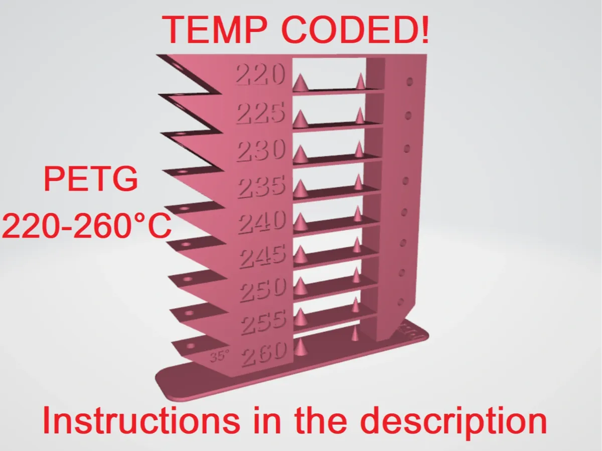

Have you run a temperature tower to see how it’s looking at various temps?
I’ll be perfectly honest, yes your yellow has an issue, but all of your colors have extrusion issues - overextrusion at corners, really excessive seams, issues at color transitions, etc.
I think pressure advance and flow calibration for all your filaments is in order.
Thank you for getting back to me. This filament is PETG from Push Plastic. I had another Yellow from a off brand which I thought was the problem/ Sorry I don’t know how to run a temperature tower, but I will find out and do so.
Here’s one you can try:

Thanks for the link, will run it and see what it shows. Did a Print Calibration before I started that print., Doing Flow Rate Calibration and Flow Dynamics, now..
