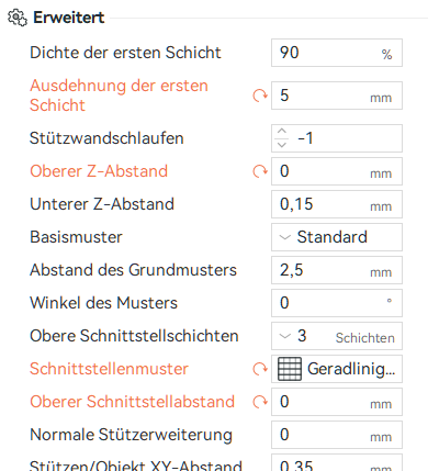

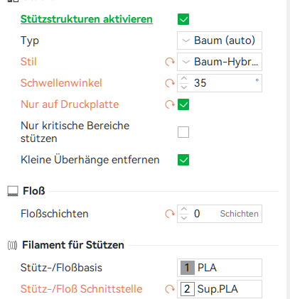

I have experienced massive spaghetti and adhesion issues with the recommended settings for the filament on the X2D.
I’m only using the Support for PLA filament for the support interfaces but they wont adhere neither to themselves nor to the pla at all and instantly cause spaghetti failures.

I can generate guaranteed spaghetti and total mess in the printer using this filament; but apparently I can neither add links here nor upload images of the settings…
And settings are virtually the same as described in the wiki.
So I’m absolutely lost on what is going on other the filament being trash :confused:

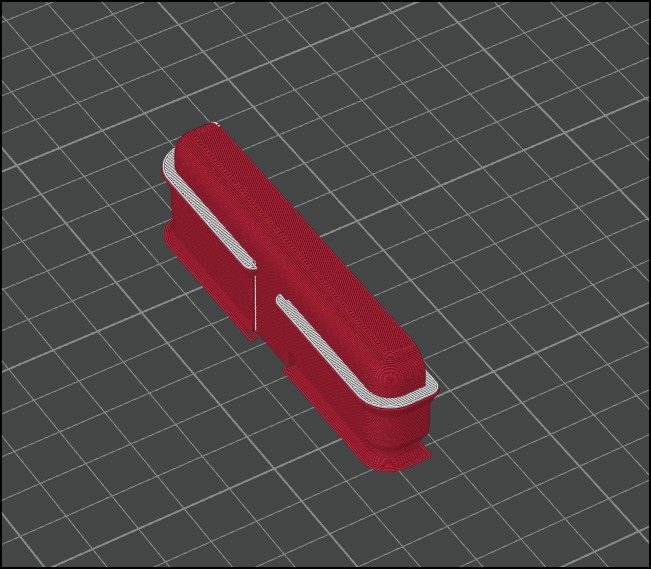

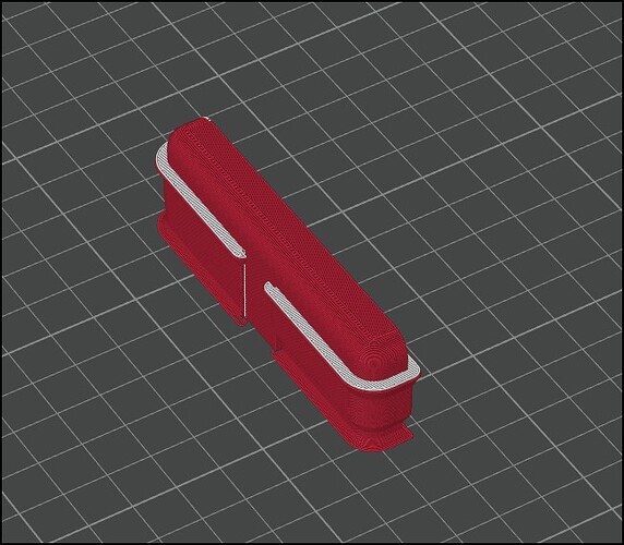

The Support filament will only ever be one single layer. It will use the regular filament to build the support until it gets to the final interface layer and will use the Support filament there.
So this is a T shaped object in red ABS. White is the support layer filament.
Yes that I know and to my knowledge the settings have been adjusted to account for that.
Setting Screenshots
excuse the german language, but should be pretty much the same as in english.
