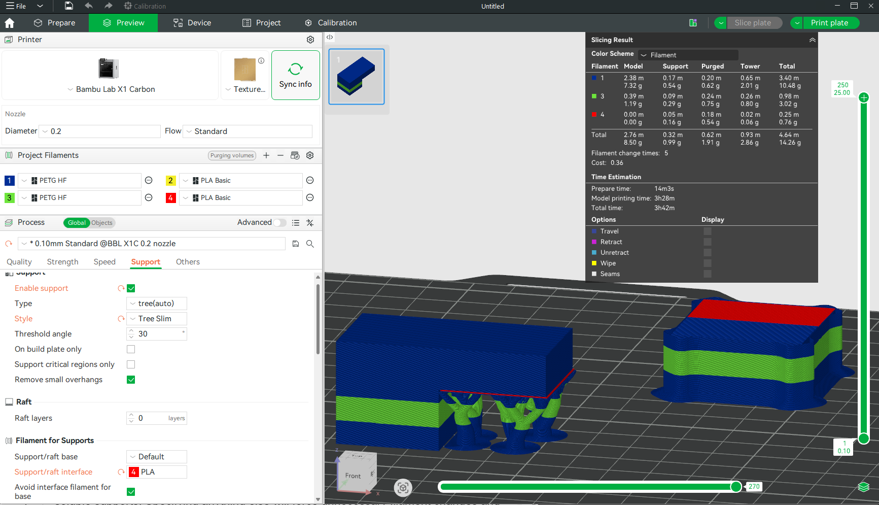

So it appears that if I change the support from tree back to normal, the support filament will work.
It seems that it will not work if you’re using tree supports.
I think the problem might be that in the default settings there is an empty layer on top between support and model. So there is no interface support, because support never touch the model. You have to reduce this top empty layer to zero (sorry, not able to look at the exact naming in Bambu studio right now)
Check the settings for Top Z Distance and Top Interface layers. Then check in the slicer if there actually is any material calculated for support.
EDIT: Also check if Top Interface Spacing is set to 0.
I received a response back from Bambu and it appears they have changed the slicer behavior in regard to Tree Support interfaces.
Previously, at least from what I recall as a newbie, when you changed the support interface from default only the base would use the default filament, and the tree (including attach points) would use the specified interface.
Now it appears the base and the tree are using the default filament and ONLY the attachment points of the tree to the model will use the specified interface filament.
This change was likely made to speed up printing by reducing the # of filament changes where there was no benefit in terms of model removal.
I have replied back to Bambu to confirm my understanding regarding the behavior change.
Honestly, I think my problem was that I did not restart bambu Studio. Once I closed it out and reopened it it seemed that everything was working fine.
Just a heads up -
I was just playing with Tree supports (OrcaSlicer). PLA and Support W. Changing the Support Interface only, not the Support Base.
Found if I chose Tree (auto) > Tree Slim, it would not do Interface with the Support W. All other modes would do it.
So, Interface Material is available for Trees, just not for Slim.

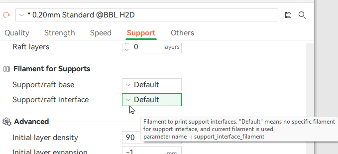

I just got my H2D and I see people here using the term ‘interface only’
I’ve printing using PLA as a support and I’ve got the external HT loaded with the PLA
The model is printed in PETG-HF
Can someone plz tell me where the ‘interface only’
So that means if i choose PLA for Support/raft interface and PETG-HF for support/raft base…..then only the interface will be PLA and the rest of the supports will be PETG-HF….Is that correct?
Yes, though if the model is PETG, I would leave the support base as Default and change only the interface to PLA. Specifying a support base filament is usually only used for soluble supports. Specifying anything else will force unnecessary filament changes and purges. Default will use the same filament and color as the current layer of the model.
Selecting a PLA support base for this small PETG model increased print time from 3hr 42 min to 19hr 40m.
