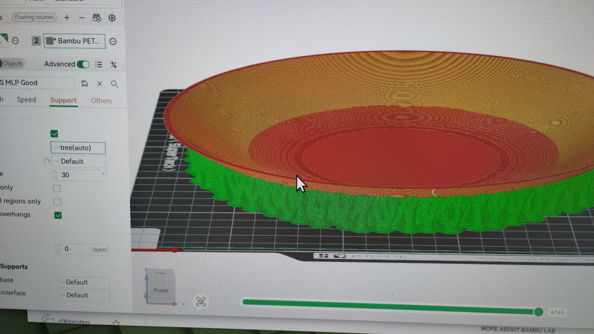

I’ve had my P1S since early spring and have completed some basic projects without any real issues, just the typical learning curve. However, this stupid little dish is fighting me. It’s a cover for my window exhaust fans, and it’s about 230mm in diameter and 25mm deep (flat bottom with slightly parabolic sides). Basically, it’s like a small dinner plate. I’m using dry, PETG-HF with the same settings that I’ve used successfully many times before.
Printing it on its bottom works, but no matter what support type I pick, it uses a ton of support, and when I remove the supports the quality is awful.
See attached photo from BS. I’m a bit pissed that this simple dish has me perplexed. Any ideas on how to print this properly?
If possible, I would redesign it so the underside has a steeper angle to it. Or flip it upside down and make the bottom (current top) flat.
You could also try printing it on its edge, but that would probably create its own issues.
Yep, a steeper angle (>40 degrees) on the sides would eliminate the need for support. Unfortunately, the shallow dish shape (parabola) is how the fan is shaped where this cover would attach. I did try printing it on edge with heavy brim and less support, but it was just to flimsy and created disastrous shaking. I have thought of making the bottom completely flat (preserving the dish shape inside), but that would look weird in place - I might try it though. For now, I’ve just ordered some cheap 9" dinner plates with about the same shape and will use Velcro in the center. Thanks for your ideas.

Also, Tree style supports sometimes are not the best support choice when addressing your issue. Sometimes the Normal option will give you a better result.
Yes, if I try printing this again, I will reduce the layer height, and make the bottom just flat, requiring no support. It will look a little funny but might just get the job done. … Good suggestions. BTW, I did try using normal supports with no improvement.
Next time try “normal” supports and choose “snug”. I’ve found that to be better than tree on curves that are continuous. I haven’t printed a parabola yet so take that with a grain of salt.
A simple bevel might be a good compromise between a curved and a flat bottom. As long as the bevel angle is greater than the support threshold angle no supports should be needed. An inner-outer wall order will also help.

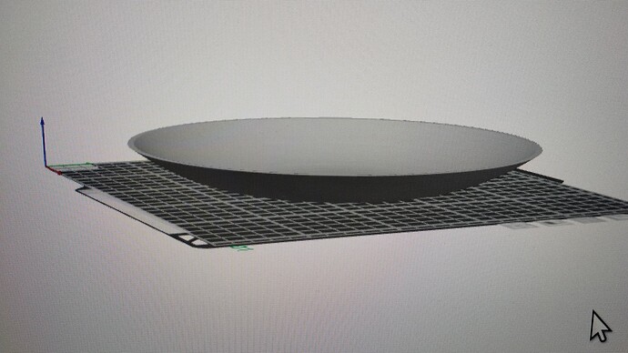

One entirely different solution is to consider splitting it in half and printing it from the new centre on the build plate upwards. Using the great drawing from @lkraus, the pink section would be on the build plate.
The positive is that the curved surface would be very smooth. The resulting seam will be a negative. This can be mitigated to some degree with the design and filament choice.
This would require designing a method to affix the two halves together.

I especially like Ikraus’ plan, and here’s a fantastically easy way to slap that on your current model
Or whatever angle your filament/temp/profile does well.
Since the only overhung areas are these sides, no extra thought needs to be done :smiley:
