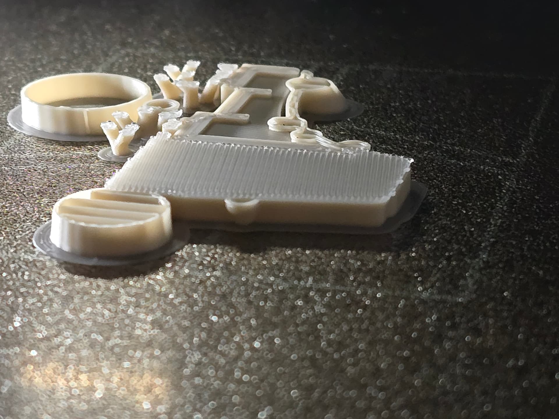

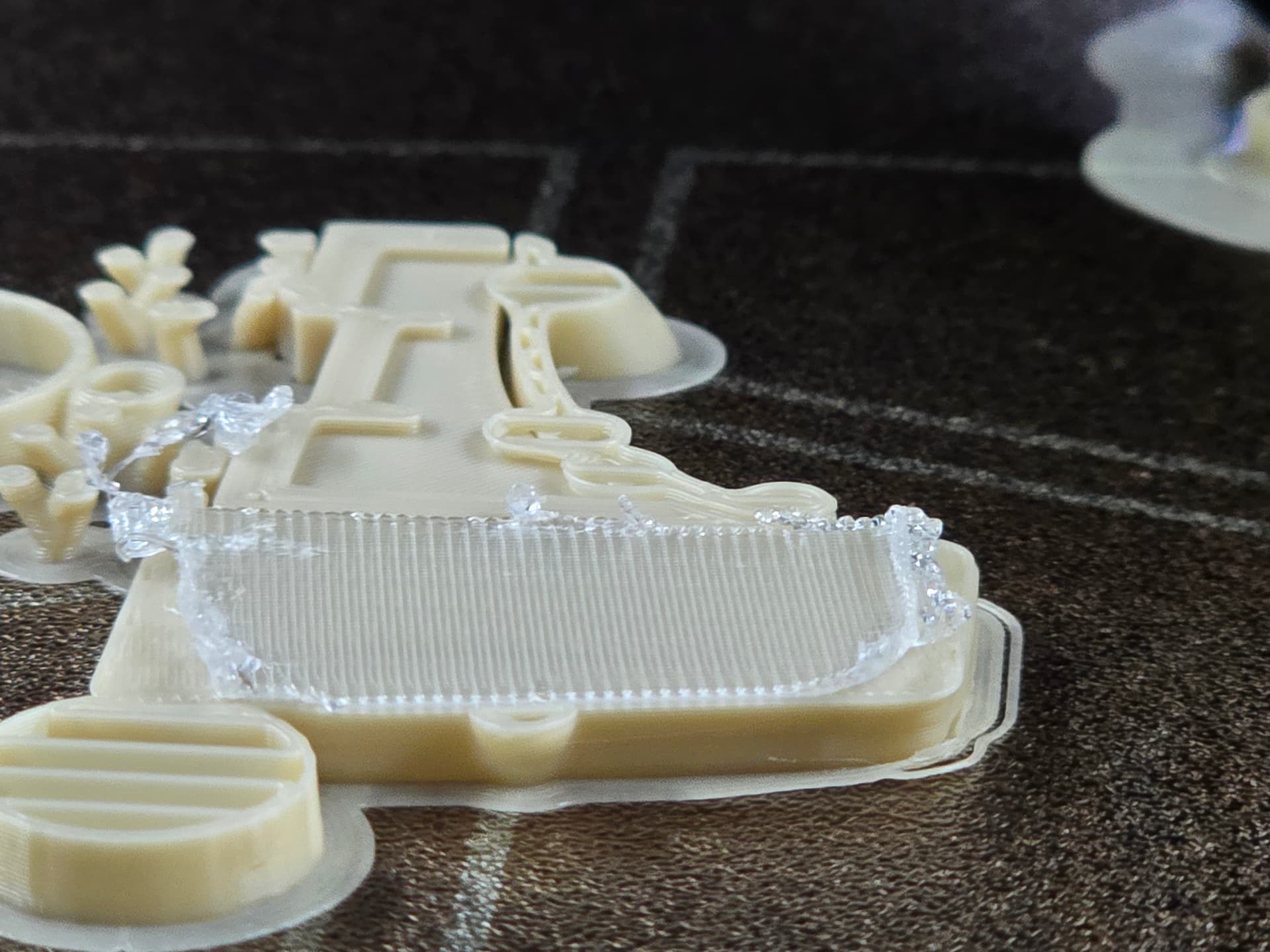

I have a model that I am printing in PLA and it has some overhangs and I am using the Bambu PLA/PETG support material and it isn’t sticking properly to the base.
It has happened 3 times in a row on my H2D and I am not sure what is causing it?
I printed the same file earlier on my X1C and it didn’t have the same problem. Later in the print, because of this issue the Prime Tower will get some raised edges and then get knocked over making the print fail. Any ideas?

I am using it for only the interface. The bottom layer you see is the PLA Tree support. Thanks
I dried it a few weeks ago and kept it in sealed containers, but it has been out for a few days while doing the prints. I will try that on the next print.

To combat the blobbed edges, 1. try calibrating your filament (even if it is from bambu the flowrate can be messed up!) 2. In slicer, go to Quality and hook the “REVERSE ON EVEN” parameter, which will reduce/prevent the raised overflowing edges.

You can also see the support material there is curving, which means temp is
not maintained. If you use PLA and PETG, they need to be at almost same temp. I print PLA on 240 and PETG on 260 when i combine them.

I am getting the same issue on my H2D with Bambu support for PLA/PETG and PLA-CF. I ran the same support material on my X1C and it was fine. I’ve since dried the support material (again), no difference.
I’d already had a clogged left nozzle with this support material, which I cleared, and it still had the issue of support material not sticking to the print.
I then tried a new nozzle, which seems to resolve the issue for at least part of the print, then the nozzle collided with a support. Getting frustrated.
The right nozzle prints like a dream.

Slow it down and lower the cooling for the support filament. Set the interface speed to 60 or even 40.
I’m running into this same problem on our H2D with both the “new” PLA support and the support for PLA/PETG. Just using it for the interface layer, it balls up and strings and sticks to the nozzle instead of laying down on the print.
I did a flow dynamics calibration for both and got crazy numbers:
