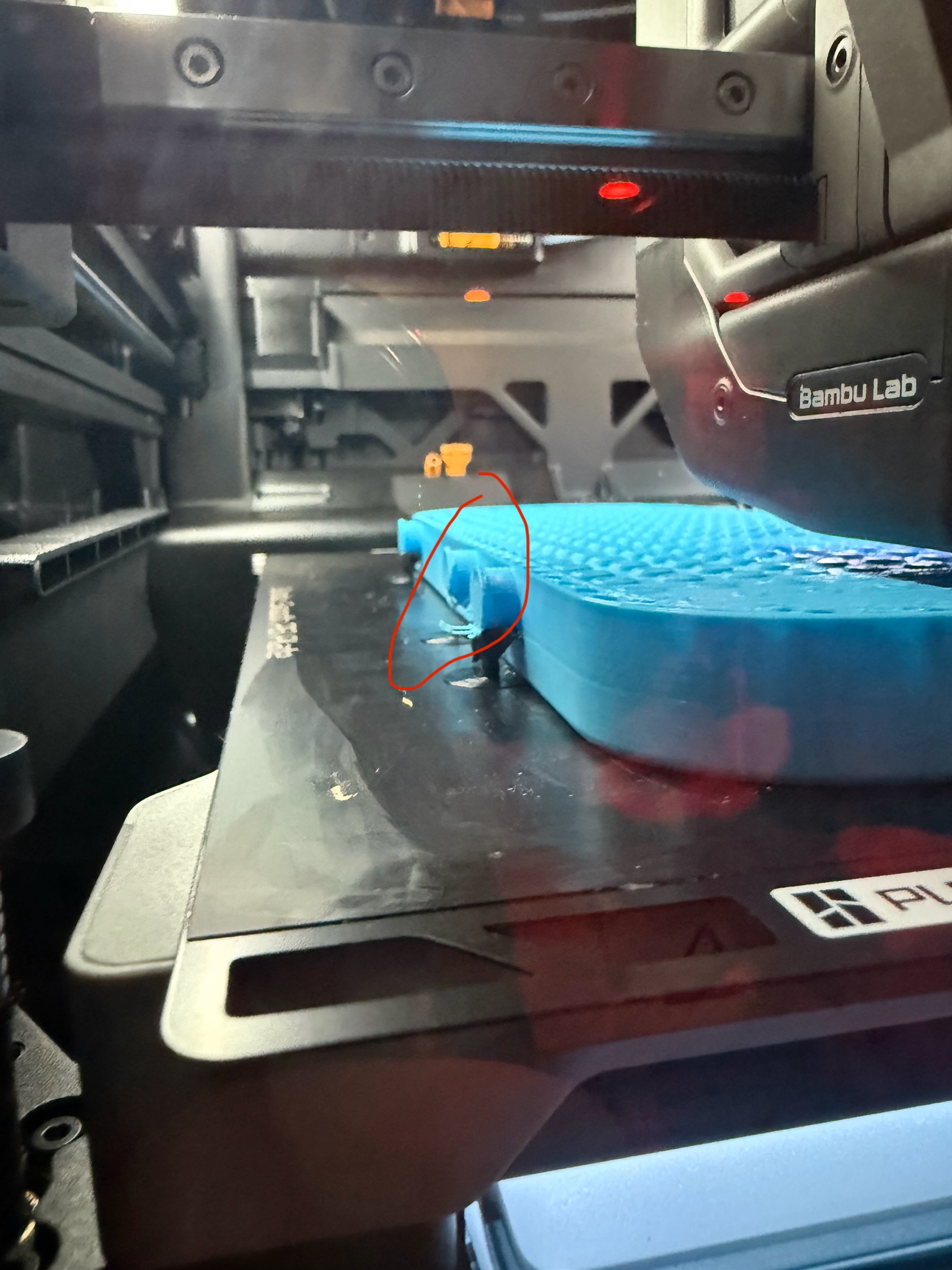

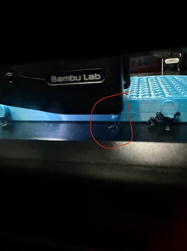

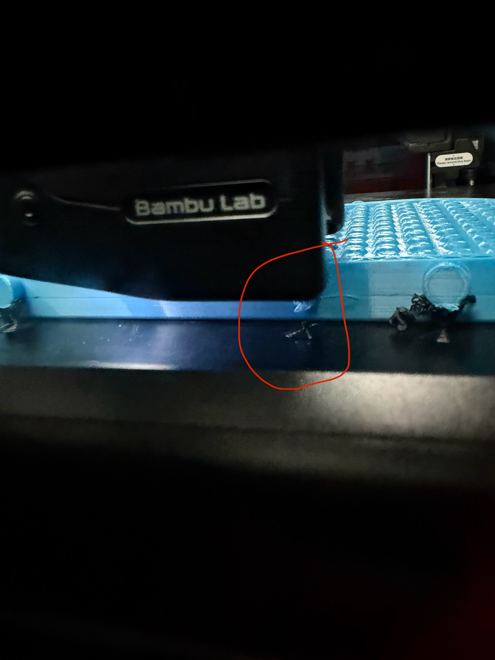

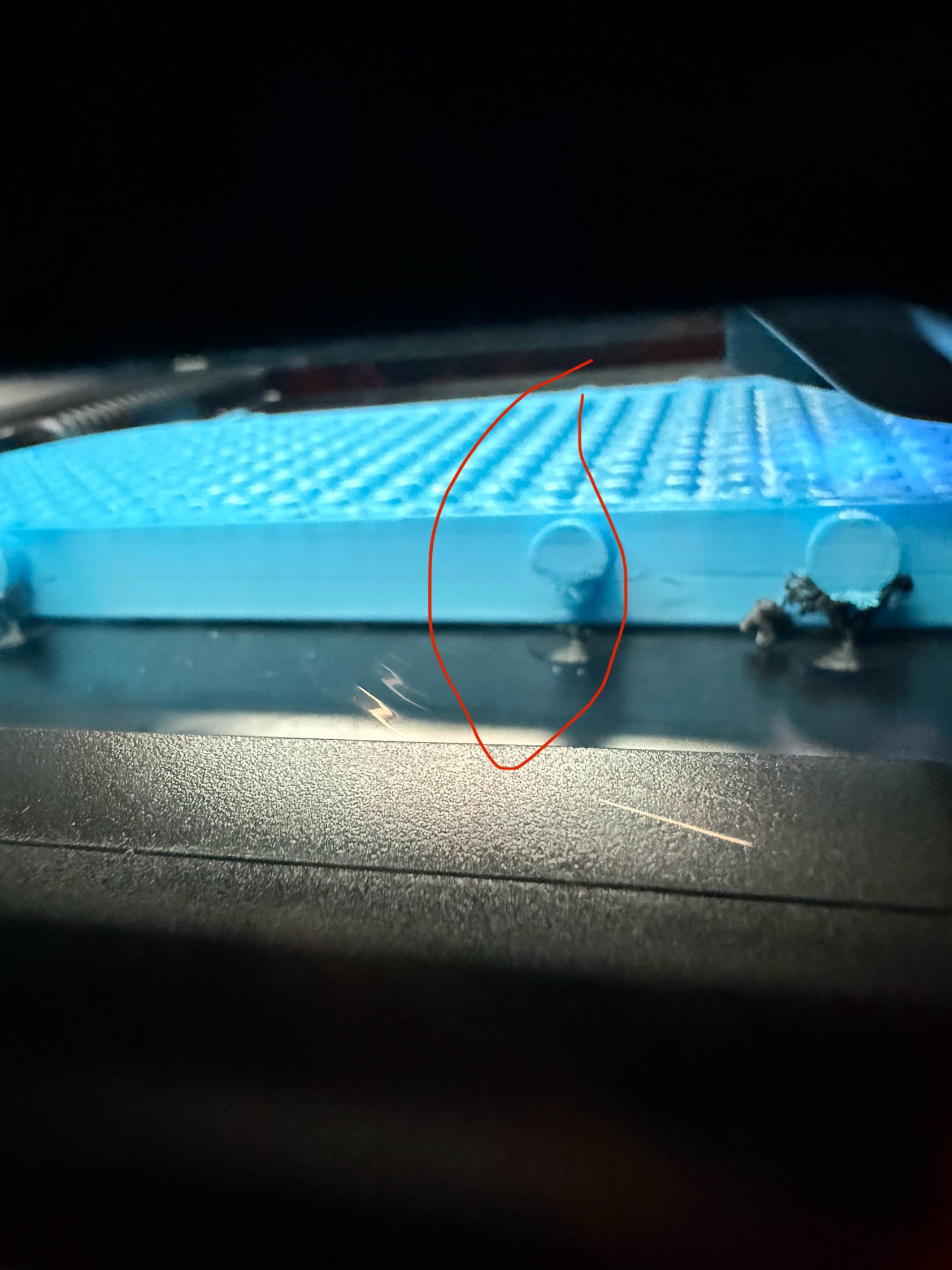

Anyone else finding their supports snapping off more often mid print on the H2D?
What material are you using for the part and what for the support?
The blue is TPU 90A and the support is pla.
But I’ve had this happen with pla support on pla too. I feel like the printer shaking is knocking the tree support loose. Maybe I just need to use more support walls.
It’s a known issue that has been talked about a lot on the H2D. I myself have not yet experienced it because I don’t often use supports but the few models I do use supports on its been working. But i have seen there is a lot of complaints about the issue exactly as you are describing that the supports come loose around the interface area, that the print head knocks them off, etc.
In Bambu Studio 2 the way supports work was changed. It’s my guess this had to do with the H2D. Especially tree supports generate differently. Load up an older file and you will find the tree supports now are different.
So far there has not been any fix that I know of.
Thank you for that information. I have noticed the change in tree supports. Glad it’s not just me. Hopefully a slicer fix will come out soon :slight_smile:

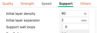

I also experienced the same issue, after I increased the Initial layer expansion from the default of 2 to 6mm and setting the Support wall loops to 2 I as able to succeed with my prints. Might give it a try and see if it helps. If nothing else, it will make it harder for them to get knocked off.
