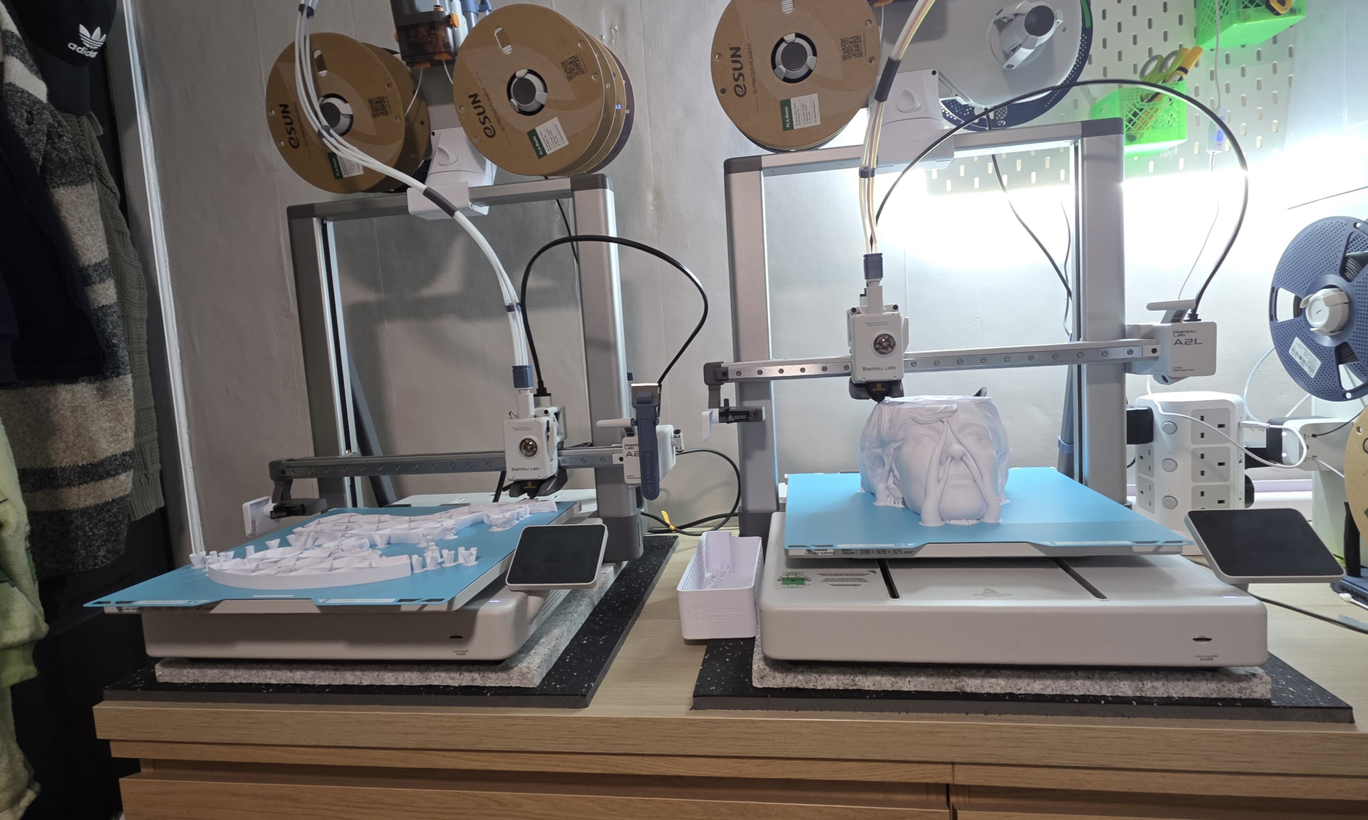

Got a small issue regarding supports on my A2L, issue is they seem to keep breaking. I have no issues with them sticking to the plate but as they get further up some seem to snap. I’ve also noticed if the support is coming off the model rather than the build plate you can be your last buck these will snap.
I’ve tried moving the z hop but this didn’t help, is this a matter of making the supports stronger when using the bed slinger or am I maybe missing something?
I haven’t had this issue with the same file in my X2D or P1S so I’m assuming this may be a bed slinger issue here.
I have It mounted on what I would consider to be a solid structure so I’m assuming this isn’t a vibration issue

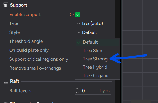

Have you tried using a different type of support like “Tree Strong”?
Hi, I did switch to this but the supports looked overkill for what I was doing. I haven’t ruled this out as an option but I thought perhaps there may be a setting or two I should be changing before going in with the strong supports… Appreciate the comment and reply :+1:t2:

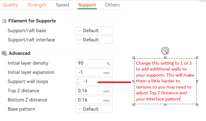

Try this:

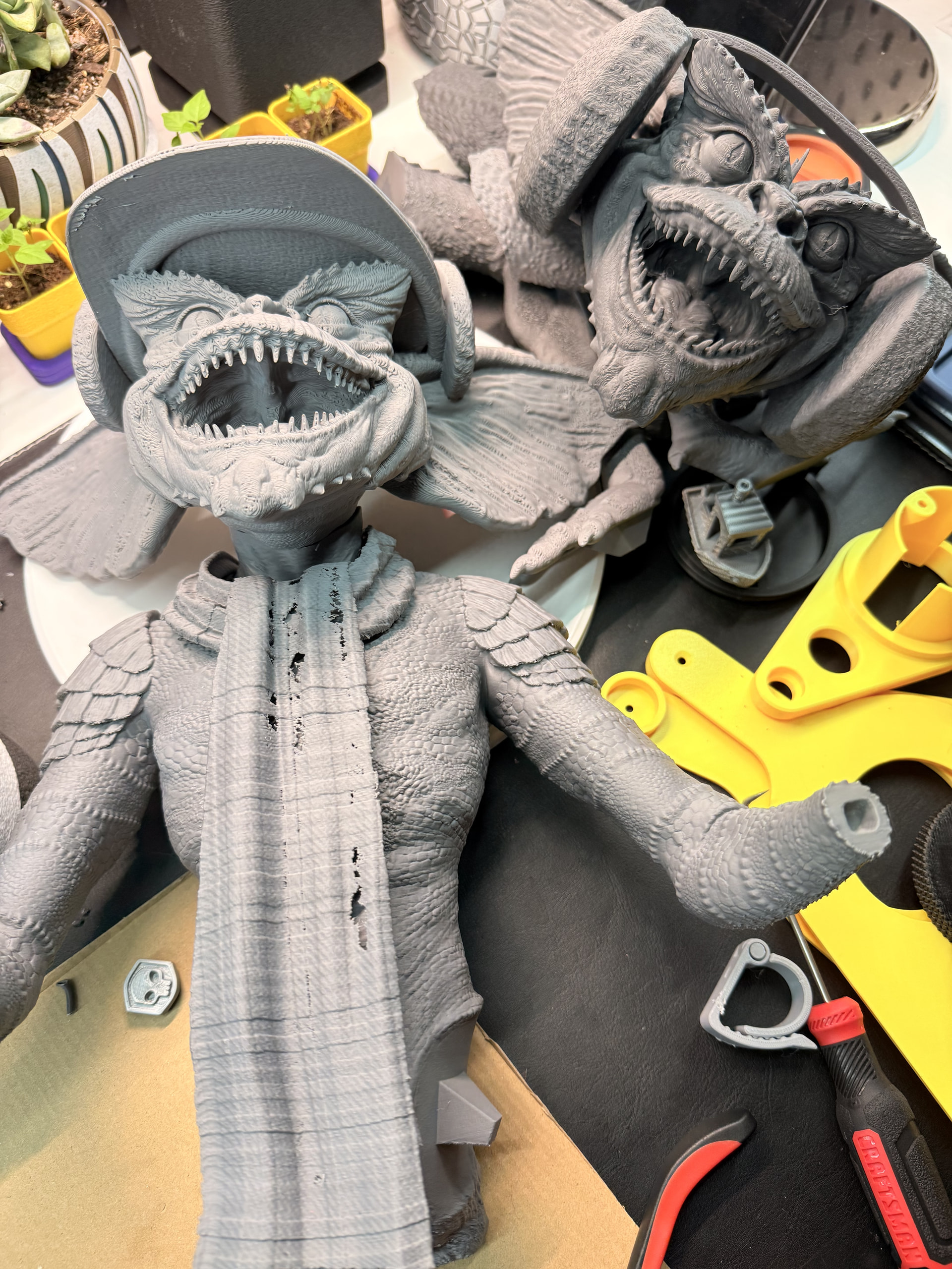

I’ve been working on 26 - 30" Gremlins and this was the specific setting that fixed my supports from breaking. I’ve done more testing with supports in the past two weeks than I want to admit.
It sounds like the movement of the bed could be putting extra stress on the taller supports, especially when they are attached to the model. I’d try increasing support density or contact strength and checking the support interface settings before changing Z-hop further.
As @Ulade mentioned, check your wall count.

As for the settings, I have tried this. I did make them stronger, no doubt but unfortunately they still got broken.

I have thought about temperature myself, more so it’s not happening on my enclosed printers. The room is pretty warm though but obviously the open bed is still exposed.
I have this feeling it’s due to either open conditions or movement, Purley because it’s the only things that make sense to me
I think it’s movement buddy, but I’m not sure how to add further prevention. It’s sitting in a fairly sturdy unit but I can feel movement/vibration if I lean on the bench and the printer is running.
I’m not sure if I can fit some other kind of foot to the printer like my X2D has to compensate for more movement as it’s basically just sitting on what seems like high density foam pads

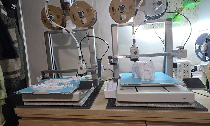

On the subject of vibration/movement. I have been doing a bit of research and some people are suggesting putting Eva high density pads on the workspace then a slab on top, rest the printer on this. I have went out and bought these items to give it a go.
I’m not sure if I mentioned but I have two of these A2L printers next to each other on the same area, although I still get snapped supports even if I’m running just one
Yes, applying extra mass is usually the cheapest and quickest way to tackle vibrations. And below the mechanisms Eigenfrequency, pretty much the only means anyway. When my X1 was living in the shed, that was also my way to go (simple paver).
I did not use the eva foam though. Although it has been a couple of years since I dug unto my old textbooks, I remember spring stiffness being key for tuning rather than damping.
But it protects the table top and should give some freedom of movement. With the additional mass on top of it, amplitudes are much smaller so only little freedom of movement is needed.
Just make sure to run the printer calibration again after the new set-up. Otherwise print quality can suffer as the printer is optimizing a vibrational environment that no longer exists.

Well, seems to have done the trick, I have had zero issues since this setup. Kinda blows my mind it worked but hey-■■, fingers crossed it stays this way :crossed_fingers:t2::joy:
