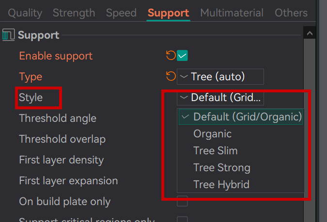

One thing you can try is increasing the tree support branch diameter. In most slicers this can be pushed up to around 10. This results in much thicker branches, which makes the supports significantly more resistant to being knocked over by nozzle contact or airflow during the print.
There are tradeoffs. Thicker branches use more filament, increase print time, and are harder to remove once the print is finished. You gain stability during the print at the cost of more material and more cleanup effort.
Standard values:
Max values, see how fat the stalk became:
You can also experiment with the style of support based on Tree-slim or tree-strong.
