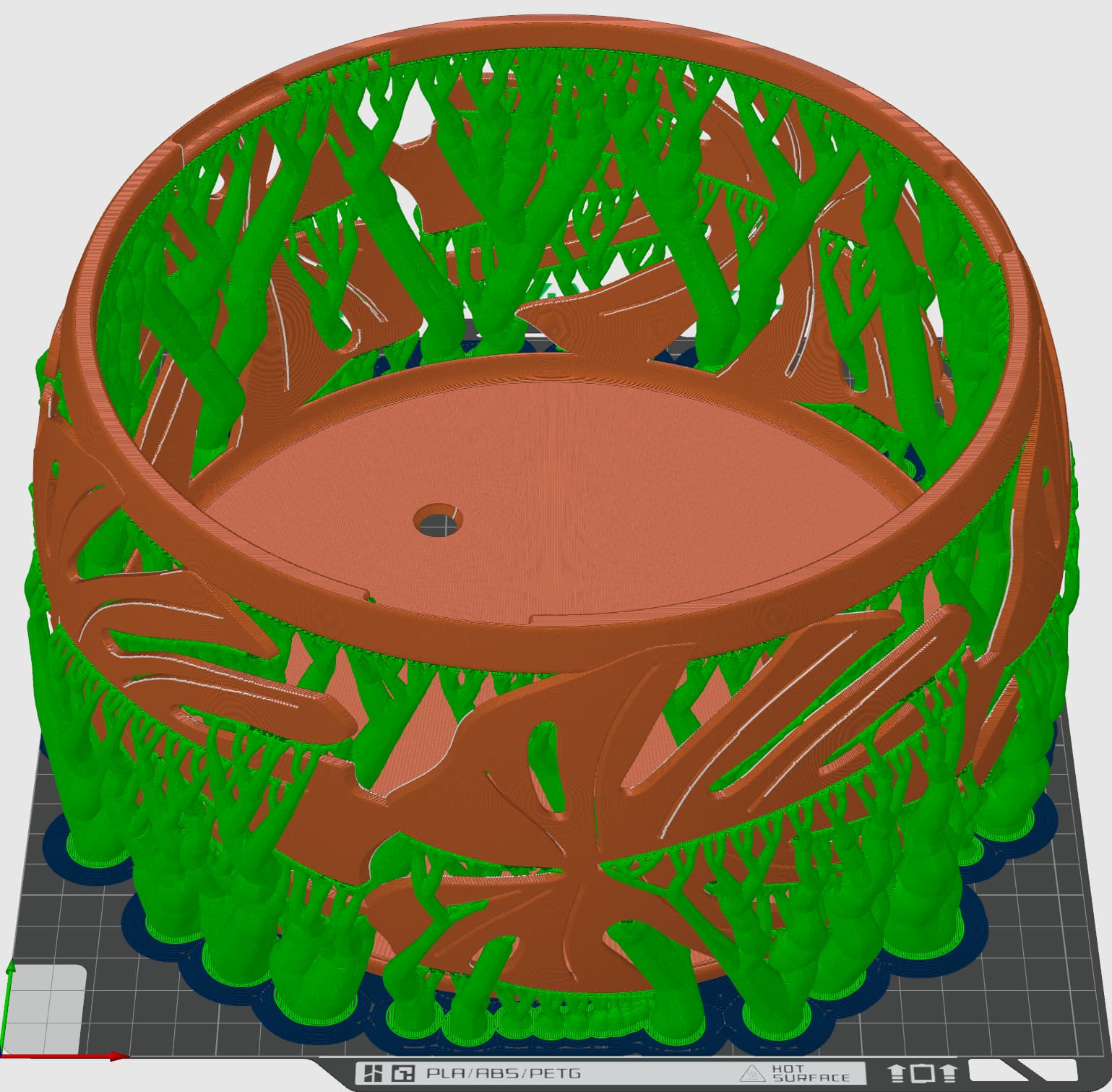

I have a VERY large model I’m trying to print (37 hours). The base is round and the diameter is almost the maximum size the build plate can handle. The object needs a lot of support (total print 450g of which 150g is support). I’m using Organic tree supports which seem to give the best result in the slicer. All attempts described below used matte PLA. I also cleaned the build plate between each attempt.
Attempt 1: Got about 30 or 40 layers in and then a large portion of the support structure detached from the build plate and fell off. I had to cancel. Here I used mostly default settings but made the speed of the first layer about 50% of default.
Attempt 2: Here I added a 5 mm brim (this is the maximum I can set because of the size of the print). When printing the second layer one of the circles for one of the supports tore off and that support could no long print.
Attempt 3: Same brim and speed settings, added some adhesive on the build plate along the outside edges of the build plate where the supports print and increased the build plate temperature by 5°C for the initial layer. Same result, one of the tree bases tore off while printing the second layer.

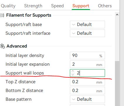

Attempt 2: Check this setting
I will try this, but I did watch the print very closely the third time and while I have that setting set to 0 which I believe means auto, it was printing two loops for each support wall.
Changing it will cause it to always print 2 loops.
Yes I realize that and I will try it. My point was that the issue of tearing the base of the tree off the build plate occured even though it was printing two walls.

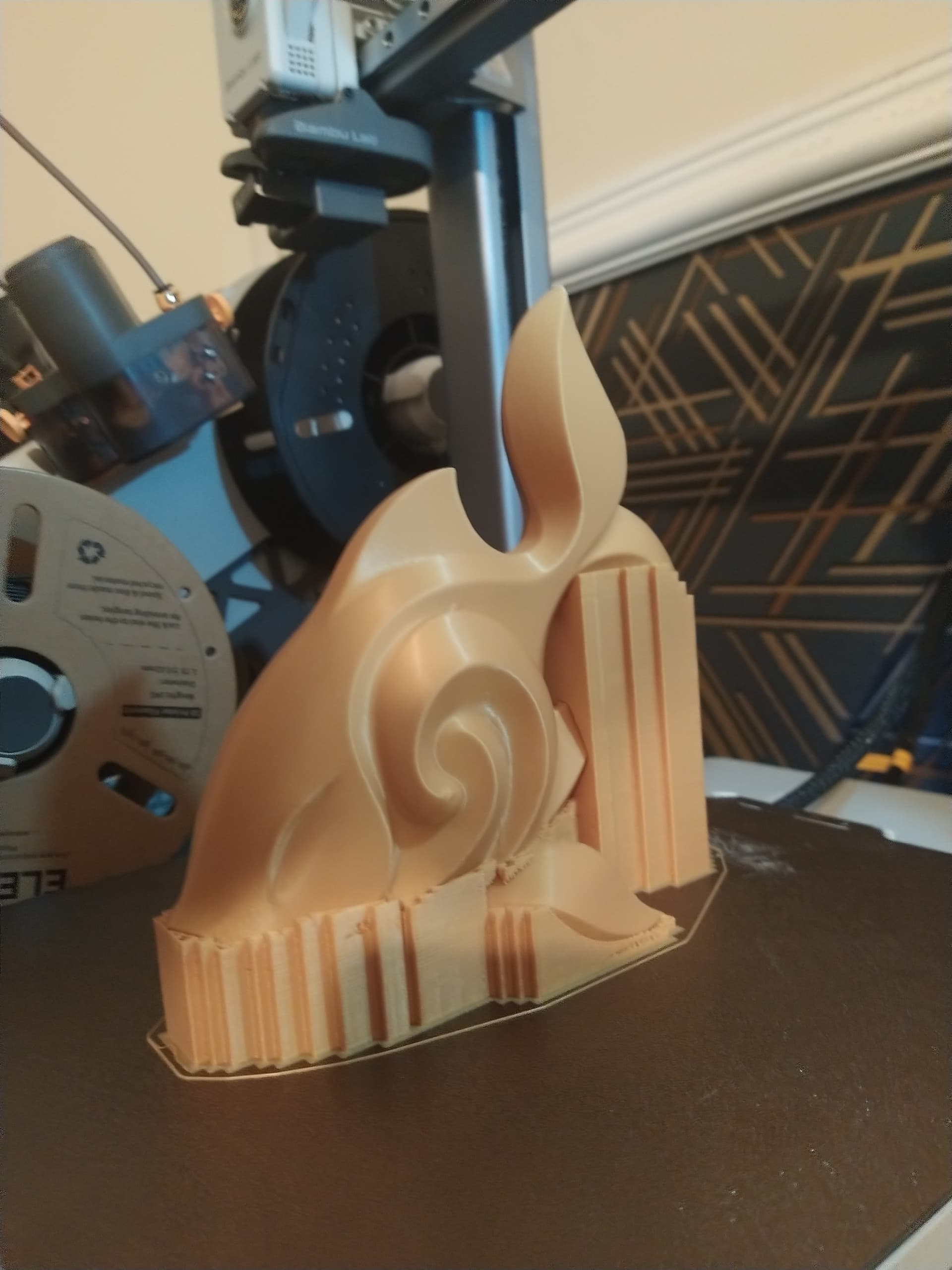

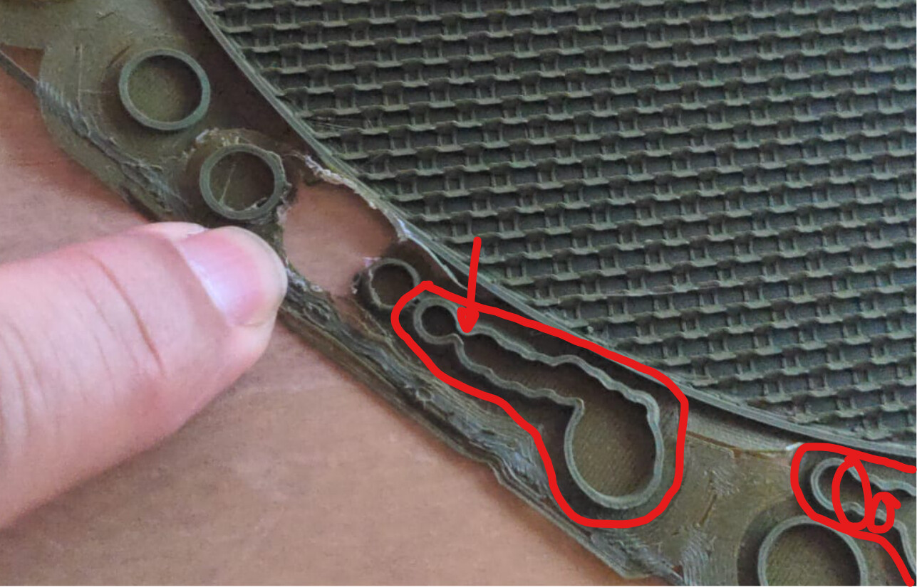

Turns out I did take a picture, unfortunately not on the build plate but you can see the problem. There is supposed to be a base of a support tree where I’m pointing. I watched the first layer get printed without issue but by the time it got to the second or third “ring” it ripped everything for that support (brim and center) off the plate.

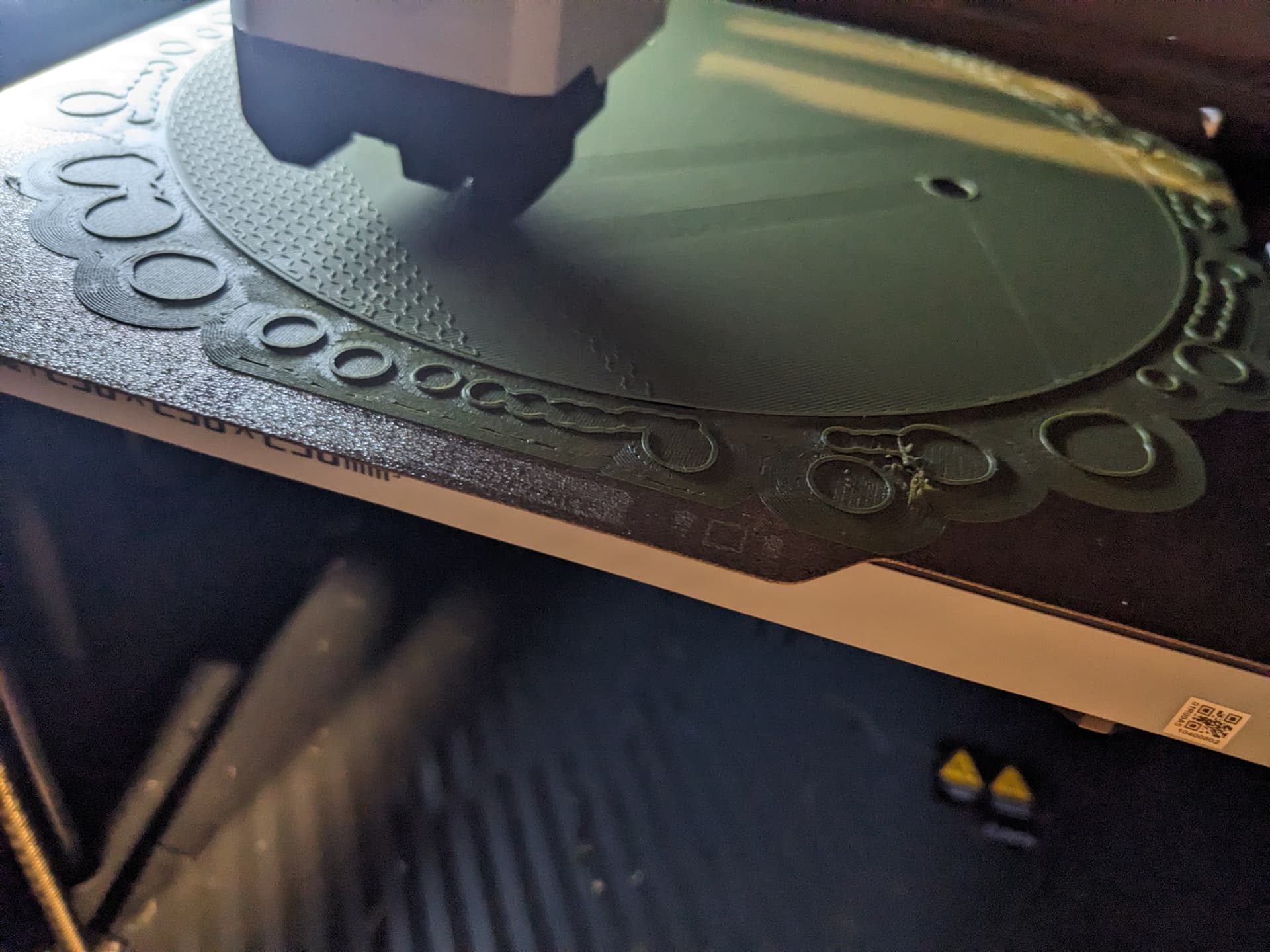

It has only happened on the front edge of the plate. Twice to the left side of center and once to the right. Also note that all three times the support that detaches has its brim over the initial purge line. Wish there was a way to turn that off!

So… just wondering what I would do with this challenge and error.
I think I would first still dry my filament (again).
- Not only because I would definitely want to rule that out for good,
- but also because curling (in particular at low layer heights, within the heat bed influence) is my first indication that there’s some moisture in it.
- And there’s some obvious curling on the insides of the tree’s to the right of your finger. That kind of defect is the root cause for ripping off the trees when the nozzle collides with it. No collision => No sideways forces => no tearing out trees
- I have also had all my open rolls of filament go bad when particularly impressive thunderstorm front rolled through. It barely took 6h.
- PLA Matte is more prone to increased moisture uptake due to the increased pigmentation giving a much larger internal surface area.
But indeed, there is something else to consider. The front, in particular close to the door gap can see some drafts and hence temp drops.
- It may be worth to tape the gap closed (will not help against trees ripped out on the sides though)
- and keep the chamber warm. If you do not have much of a heat creep risk (i.e. few retracts per layer, no ironing), you can target as much as 35-39°C.
- It may also help to heat soak the printer ahead of starting a print.
- And of course, you can increase first layer heat bed temp by 5°C and 1st layer nozzle temp by 5-10°C. But it does not look like you have an actual adhesion issue (besides the purge line being in the way).
- Finally on this topic, I’d go slow! It may be painful to see longer print times, but I learned quickly that nothing is slower than having a fast print fail. Again. And again… Going slow is also a good strategy to counter curling.

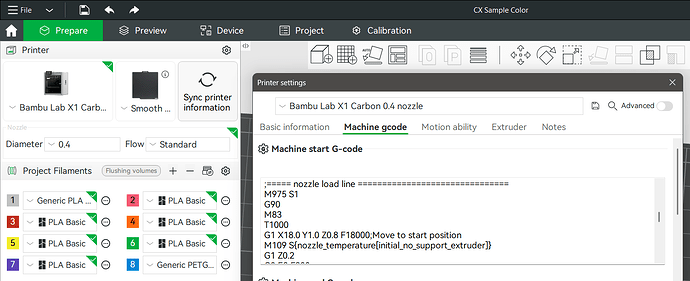

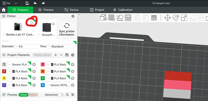

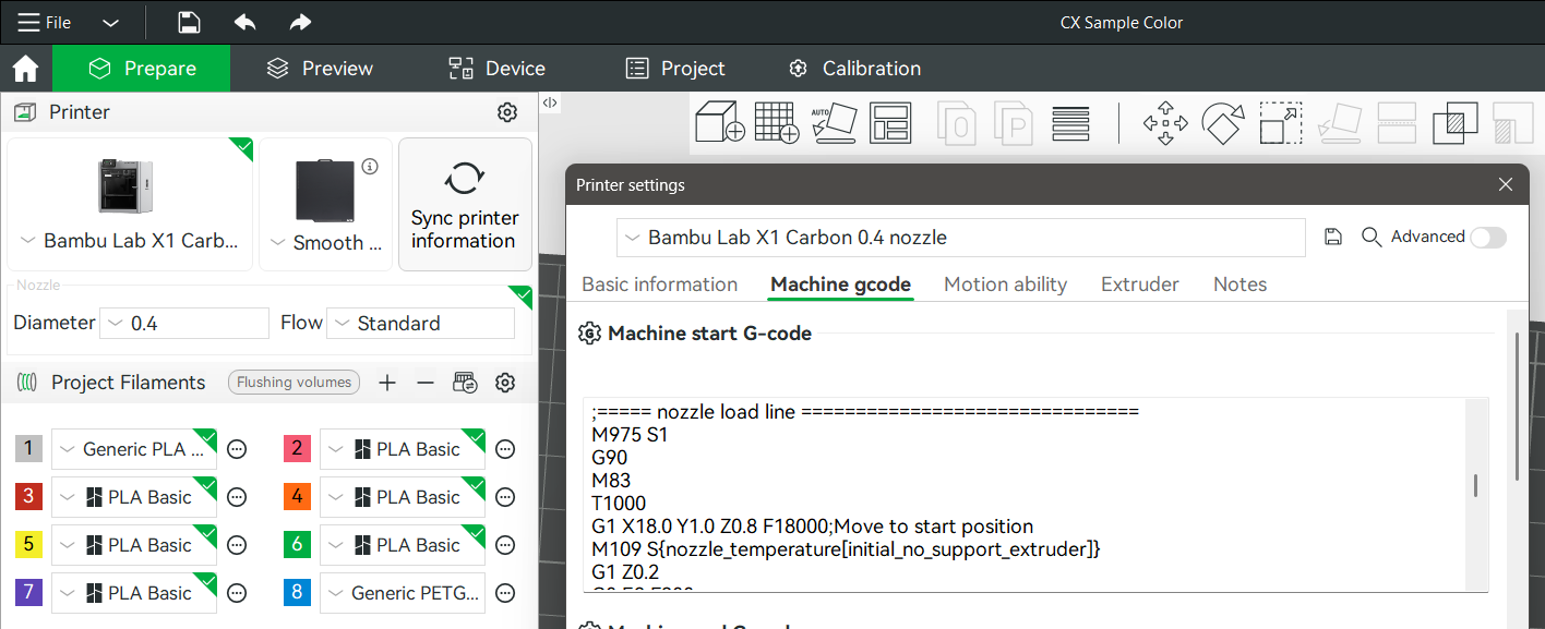

As for that pesky purge line being in the way, I do believe that you can edit it out in the Machine Start GCode. The icon comes up when you hover the mouse over your printer symbol.
Note that I have not done it myself so be extra careful if you choose to go this way and do your own research considering possible errors and consequences!!!
As my X1’s Start Gcode is a bit overloaded with the cali pattern, I am not quite certain but I believe you need to look for the code below:
;===== nozzle load line ===============================

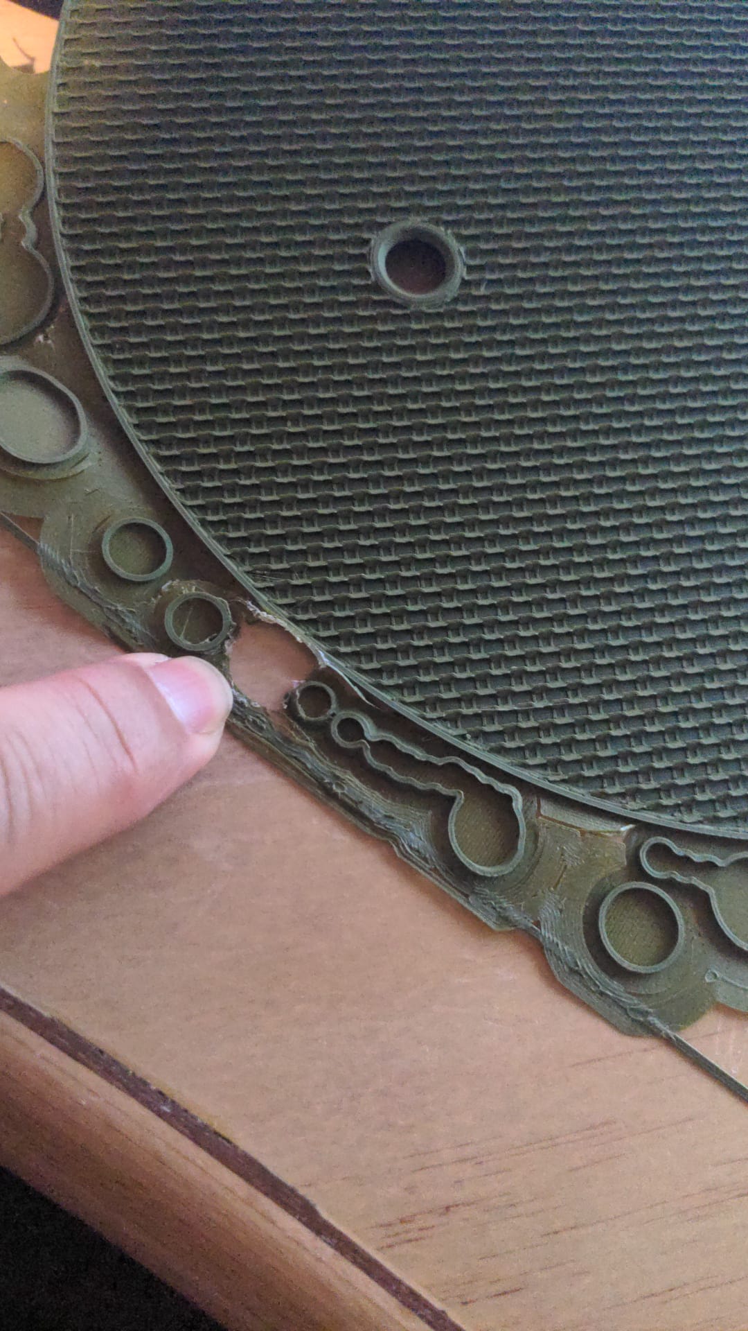

@EnoTheThracian Thanks for taking the time to look at this. I’m doing another print now and made it to the third layer with no issues so far🤞🏼. I have the overall speed down to 50%, the aux fan down to 20%, and I figured out how to stop the prime line from printing. I think that the curling you highlighted is from me peeling that failed print off the bed in contract here is a picture of what I have right now
Actually now that I look at the picture I do see some curling on the left but it isn’t causing an issue right now. We will see how things go.

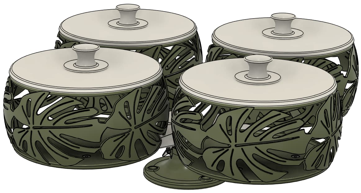

In case anybody is interested this is what the print looks like.
and this is an image of the whole device I’m making for my daughter.
By far the most complicated thing I have ever designed and printed.
