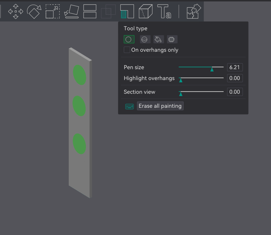

But then I created a “cube”, with a 3mm x15mm base, 100mm tall.
I can paint supports anywhere on any side or corner, but there are no supports after slicing.
I also made the shape 200mm high, still no support generated.
I added the tall tube to the plate with the “cube”, the tube had supports, the cube did not.
Makes no difference if I use Studio or Orca.

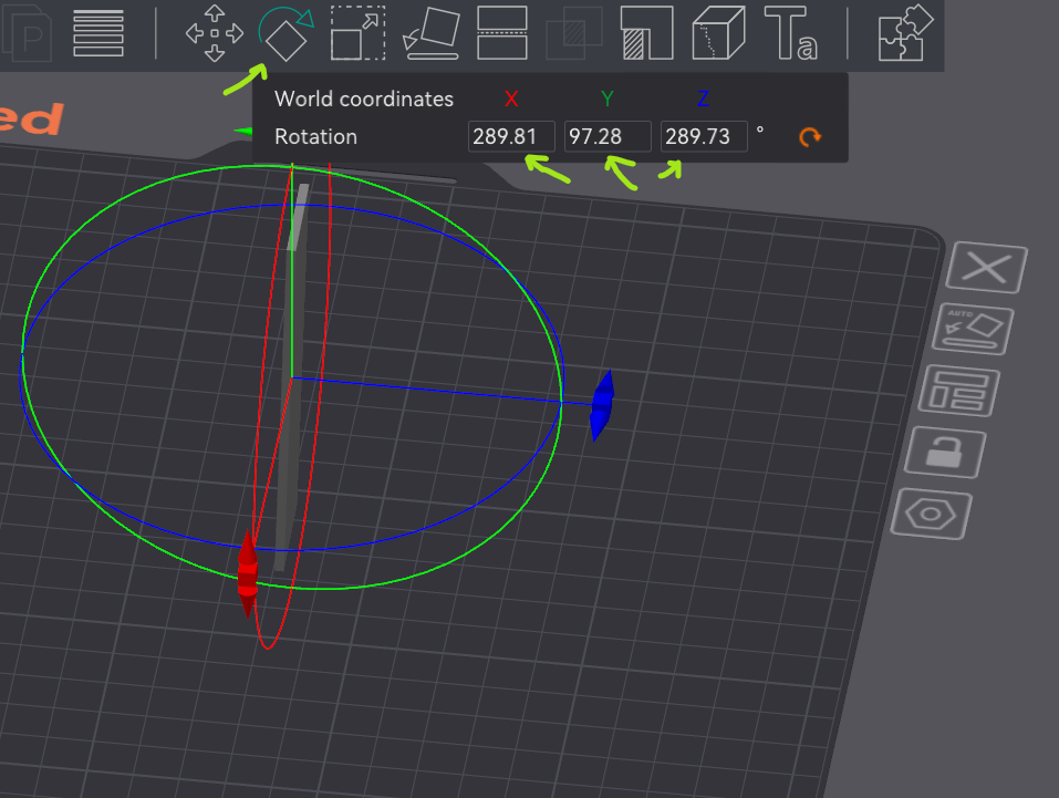

I’m assuming you already tried organic manual supports and let me guess, the slicer ignored you. That’s because based on your screengrab, it looks like your fin is perfectly vertical. The slicer ignores this because it thinks that a vertical fin doesn’t need support.
Mind you, there may be a better way but this is the one I used. Note that it only works for the side being pulled on by gravity and it may distort other parts of your model. But at list for your fin, supports will be forced to print.
So here’s one way I used to get around this.
  1. Take the whole model and use the rotate tool to move the model off it’s vertical access by just a small amount. This will force the slicer to work for you not against you.

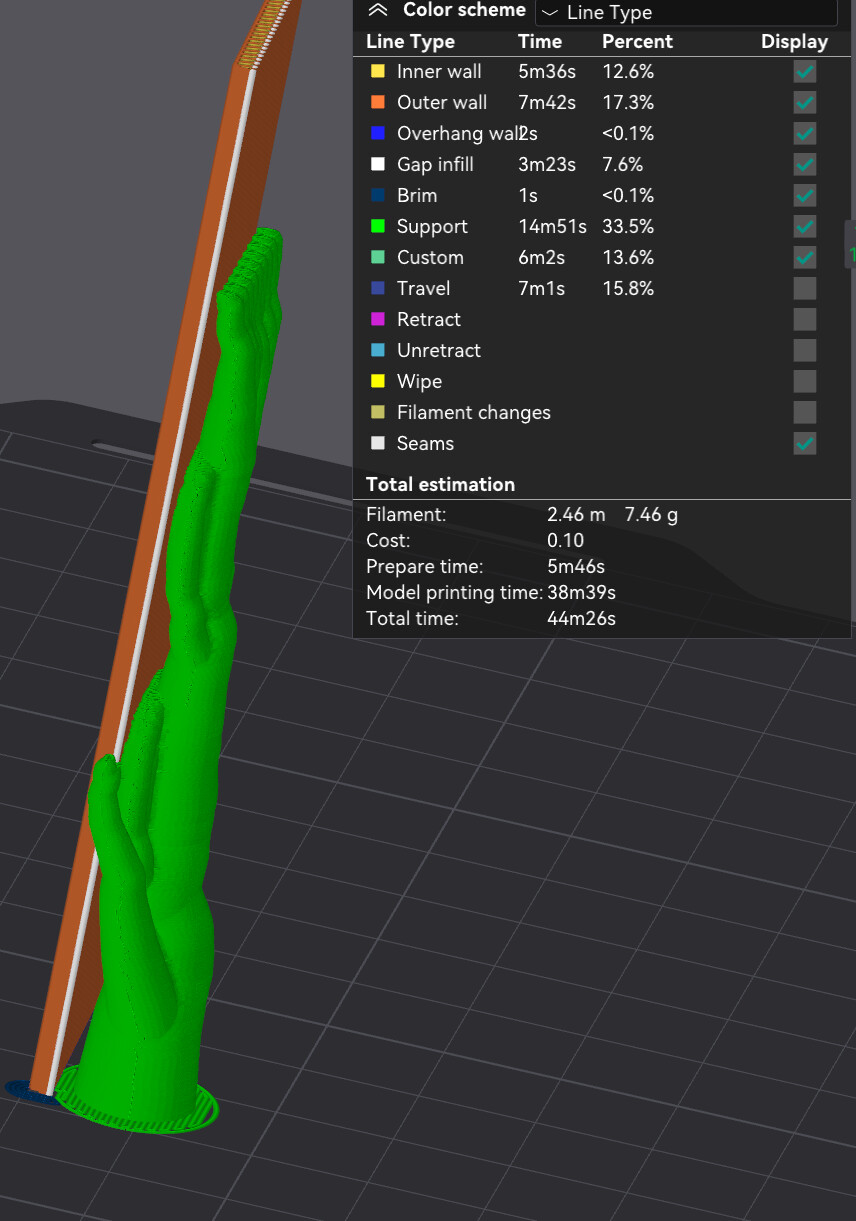

  2. Once you do that, paint on some spots for where you believe the supports need to go.
  3. Then you set the support to Tree(manual) and Organic.

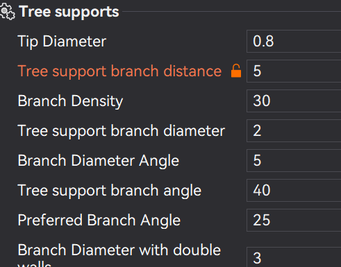

  4. Scroll down and set the tree support branch distance to some value, I chose 5 but you want it to stand some distance away from the fin for easier detachment.
  5. You should get something like this

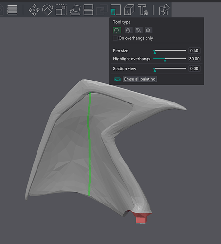

Had this same issue where supports weren’t generating for a vertical wall even with support painting. It turned out that all that is needed is to paint in a line (by holding down click and dragging with the tool) instead of just dots. This worked for me using default tree support settings.
