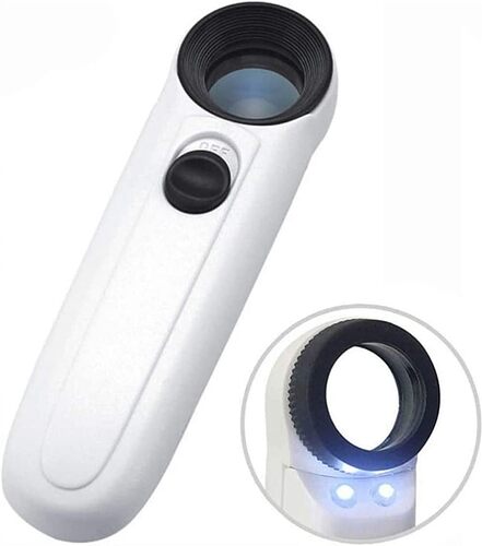

One last trick I learned from Len Dizzle of “Filament Fridays”
  • Don’t rely on your eyesight, use a camera and blow it up on a screen
My personal tip. Use a lighted jewelers loop to really get a great look at details. This is even better than zooming in with a camera.
Here are my favs.
https://www.amazon.com/dp/B0BP6L3X6C/
https://www.amazon.com/dp/B08RRZ6CFN/

@Olias Thanks for the idea with the jewelers lense. I guess I’ll buy one.
