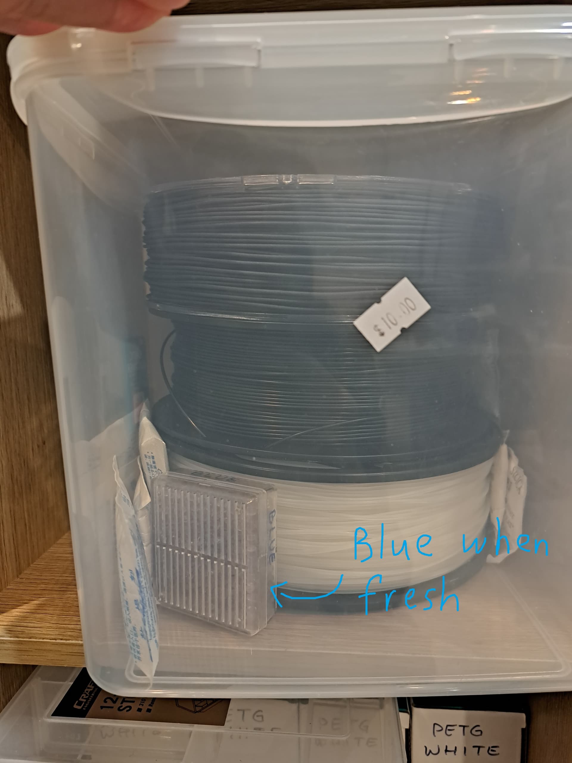

I did some experiment with 3kg PA6 spools + about hundred gram of dry silica beads + hygrometer inside a sealed container. I wrote down the %RH level of air inside every hour after filling with fresh dry silica beads. This is the result after about 4-5 months.
Please notice, all 3 spools had gone through oven at 80°C for 16 hours before putting inside of this storage. Same for silica gel beads.
