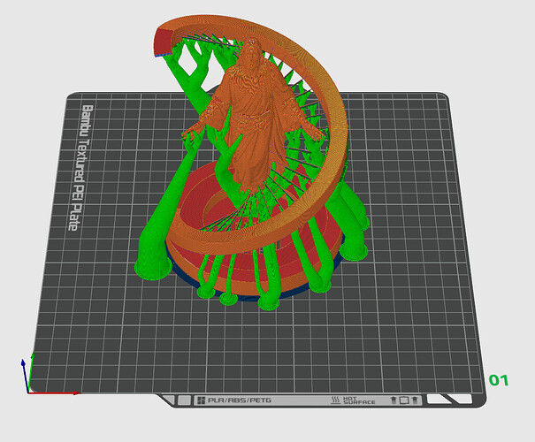

The strings are very fine, and I probably had wrong slicer settings which I will review.
But it will come down to how do I remove the tree supports from the strings in the print? The strings are very fine. Should I try to free the strings before going to the larger pieces of support? X-Acto knife or some other tool?
I’m very discouraged but I’m going to keep this particular print and, hopefully with some suggestions here, learn better how to handle support removal. Then I will try the model again.
I have always used automatically generated supports. So I mark the spiral and Jesus for supports but not the strings? I have not done this. I will look for videos and pages on this but if anyone has links I would appreciate them…
You can change the support threshold angle to 25. The 3MF file has it set to 2. If that dont work you will need to paint the supports on. I don’t think I had to paint them though.
