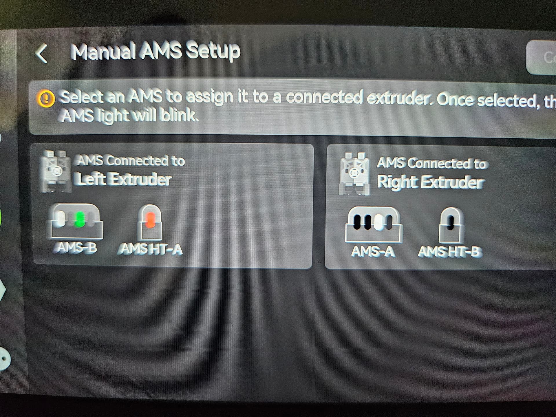

I know there’s some logic to how Bambu assigns AMS labels, but trying to always hook mine up in that order whenever I have to do some maintenance seems like an unnecessary pain in the butt.
You can see from this image of my H2D’s screen that my 2x AMS 2 Pros and 2x AMS HT’s labels are opposite. Everything is hooked up the way I want it, I just want to change the label of my AMS 2 Pros so that the AMS unit hooked up to the left nozzle is AMS A.
I have my AMS 2 Pros mounted next to each. I have my AMS HTs mounted next to each other. It makes sense to my brain that everything on the left = A and everything on the right is B. That’s how the HTs are setup by default/accident, but the 2 Pros are opposite. They’re connected to the correct nozzle, but assigned the wrong label. How do I switch the label? I thought I saw somewhere you could do this from within the H2D menu or slicer, but I’m not seeing it now.

You do it by disconnecting the 6-pin cable from printer and connecting them in the order that you want. First one connected to printer will be A, then B, C etc.
Also when you use the drying function, all four will be arranged on the screen in the order you connect them.
You’ll have to reset all you AMSs and re-connect them in the right order otherwise the AMS ID assigned at first connection will never change. It is a PIA so the best way (what I did) is simply to disconnect PTFEs and 6-pin connectors and reverse your AMS2 and AMS HT and reconnect, it is a lot easier and faster.

Don’t move your PTFEs and 6-pin cables, just physically move your AMSs. It’s not the cable ports that get the ID but the AMSs themselves. If an AMS has been assigned A it will always be A whether it’s the 1st, 2nd or 6th in the chain (unless you reset them all in AMS menu and re-arrange).
@SupportAssistant yes please make this happen.
Adding this here just in case someone finds themselves in the same situation. An ‘Arrange AMS Order’ feature was added under Settings→AMS Options. Leave all AMS units connected while confirming the reset, then disconnect them and reconnect in the order you want them identified.
