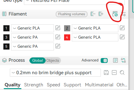

Ui all, I can’t seem to find the menus, pathways to resync the AMS. When I select a filament and load when the print starts that selected filament unloads and another one loads and starts the print. Any help would be appreciated.
B
@user_879366783
The sync button that I believe is referenced in this thread is located here,
Also, make sure you choose what filament you want to print with in the slicer by selecting the model and pressing the number key that matches the location in the AMS. Then make sure that the correct location is shown in the pop up dialog when sending it to the printer.
Hope this helps
