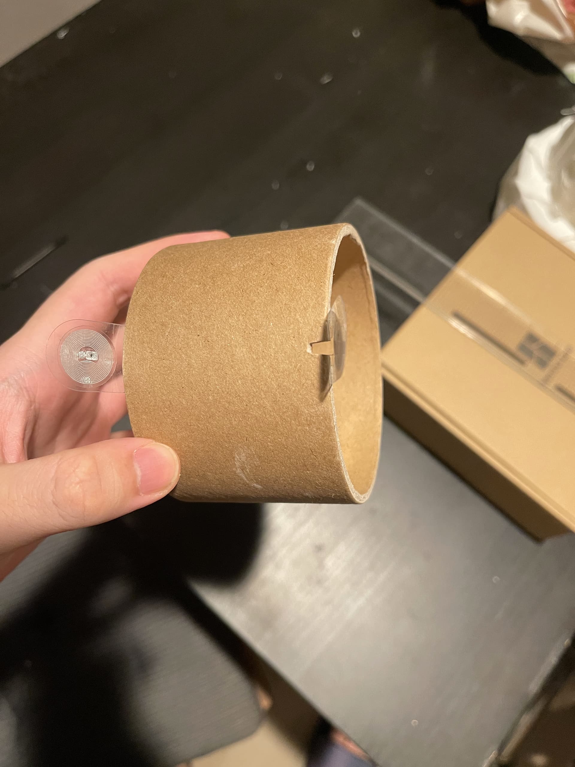

While going through this I decided to save a few spools and compare them. Below is a pic with 3 different spools.
From left to right.
Oldest spool, filament was bent to 90* and stuck in one of the holes. Notice the 4 holes.
“Bad” spools. Tape either covering too much of the filament or applied incorrectly. Notice there are only 2 holes.
Newest spools. Tape only covers about a quarter inch of the filament. Notice there are no holes in the spool.
All of the spools I had issues with had 2 holes from the time I started observing empty rolls. Mind you, this is just a single users observation and may not be indicative of the entire production.
Point being, when you put a new roll on take a look at the inside of the spool, if it has 2 holes, set yourself a reminder to watch for the end of the spool.

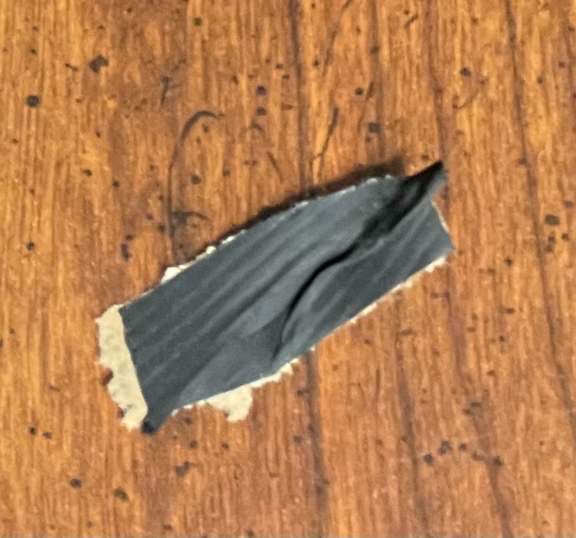

I just encountered the same issue. The end of the filament (PLA Basic Black, shipped to me in the fall, I think, this year) pulled the tape off with it and I had to fight the AMS from sucking it in. At the end, the AMS gave up but thought there was a clog as there was nothing to pull back out. I ended up have to take the AMS apart and pull the remaining filament out and then reset to resume printing with a.new roll. Attached pic of the tape.
