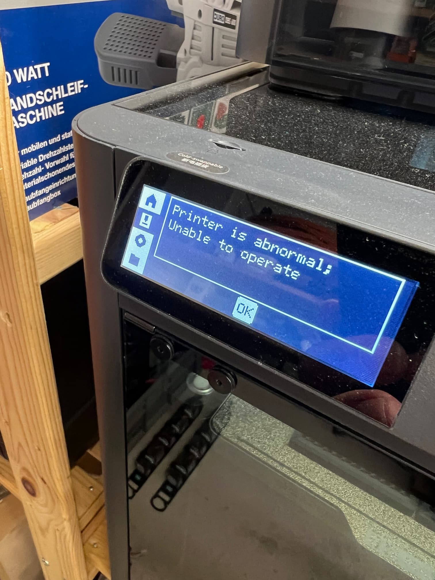

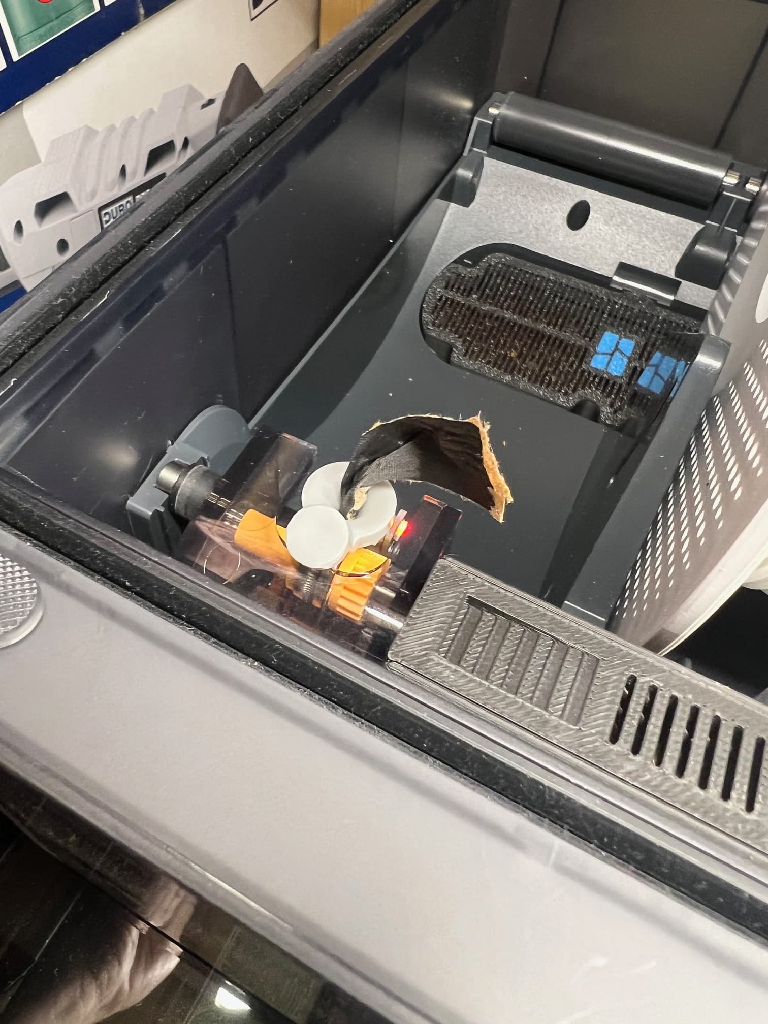

Every time the filament runs out, the AMS gets clogged. There’s a piece of tape at the end of the filament. The printer displays an error message, and the print has to be aborted! This is very annoying. I bought the AMS so that the print automatically starts from the next filament roll. :triumph:
This is my biggest gripe! I’ve just got a P1S and every issue I’ve had has to do with the crazy tape at the end of the spool! Waste of time and money (business) and causing mechanical issues! Instead of me trying to save filament, I’ve wasted more by failed prints. A great way to make customers waste money!
Welcome to the forum mate.
You do have choices:
  1. People have been using something like this to solve the problem. AMS Saver Snag Cutter V2.0 by Hexavalent MakerWorld: Download Free 3D Models
  2. Don’t use Bambu filament. Plenty of other filament manufacturers out there that have good filament and don’t use tape.
    I’m sure there are more choices, but I think these two are the most popular.
Thank you for the advice! Snag cutter it is. I appreciate the response :smiley:

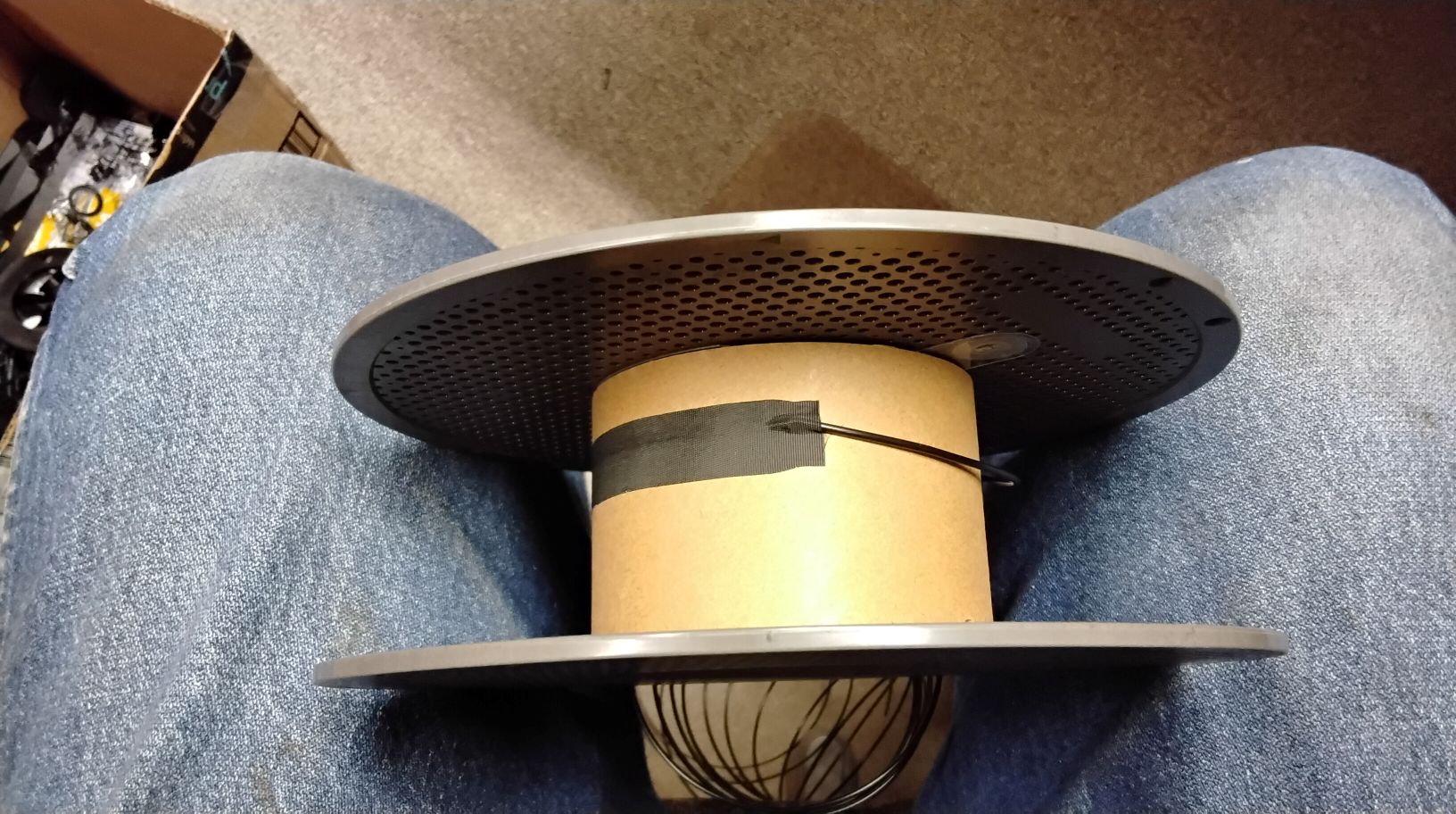

I bought this roll of Bambu ABS in January or February 2025. I had about 10-15 feet of filament left after finishing the last print, so I decided to unreel it and see what the tape situation was.
