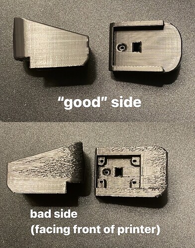

Just got my P1P a few weeks ago, printed some test objects out of the box and it seemed to work fine. Started my first “real” project this week, and I’m noticing terrible print quality on some walls. For reference I’m only using PLA/PLA+. The walls that print poorly are only on the side that faces the front of the printer, no matter how I orient the part. The epicenter of the wall distortion is the front right corner of whatever I print. It seems that the problem gets more defined the more wall loops I add, as I printed a benchy with only two walls and the quality was much better (some distortion in the same spot though). I’ve tried recalibrating, using different filaments, removing the aux fan, messing with settings etc. I think this has something to do with either vibration or the new firmware update, as all other sides of my prints look great.
The same part printed in 2 different orientations with 6 wall loops. ESUN PLA+.

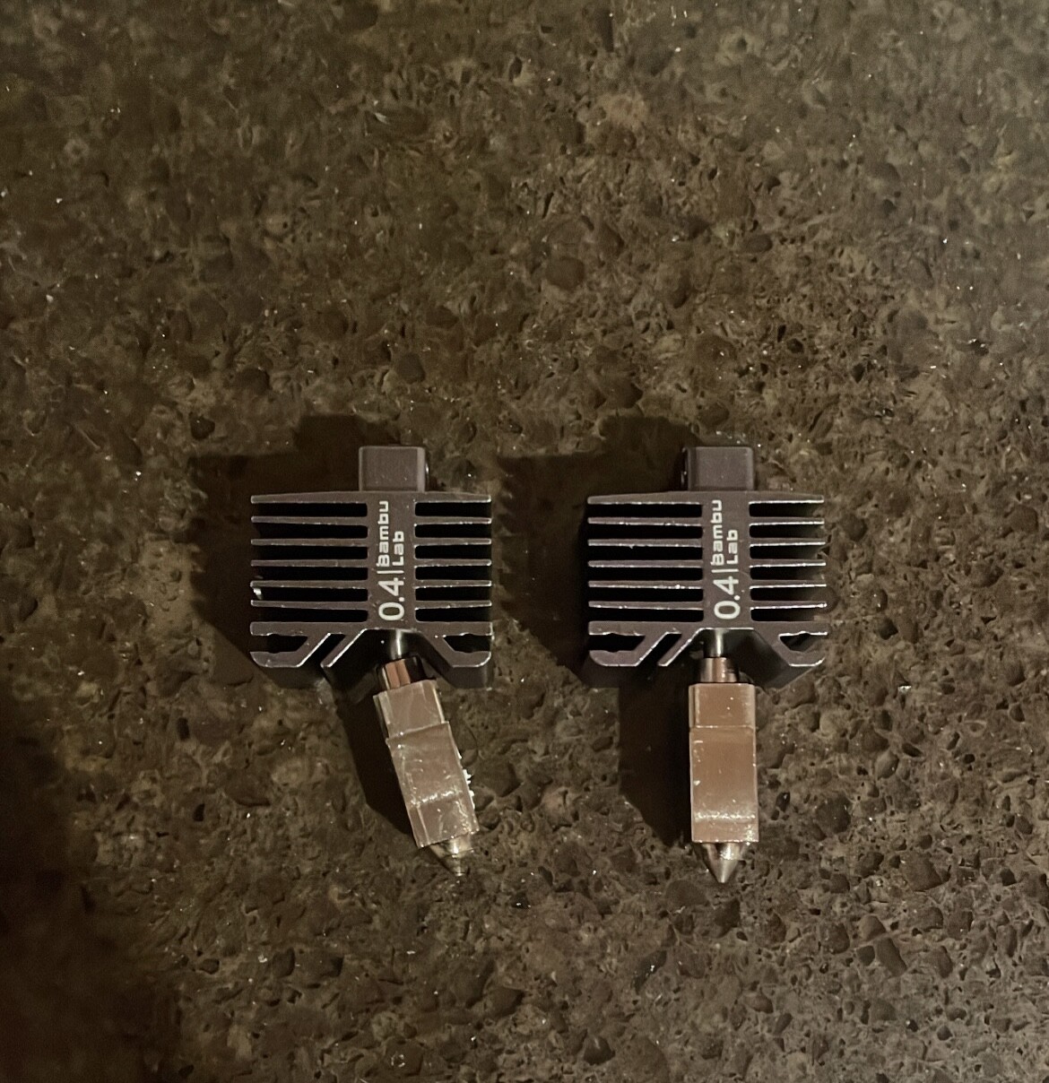

I think I may have found the problem
Ouch, what do you think caused this? Z movement bed strike or hitting a well adhered print?
I didn’t know they did a mill print nozzle :rofl:
It was the result of a print bed strike. A couple weeks ago I ran calibration with the print head moved out of the default position and it scraped the bed for about a second. Somehow I didn’t notice any difference in print quality until now.

For me it was the nozzle. Affter the exchange to the spare one, print quality was good again.
I had the exact same issue and was also fixed by replacing the nozzle that was bent in the same way.
