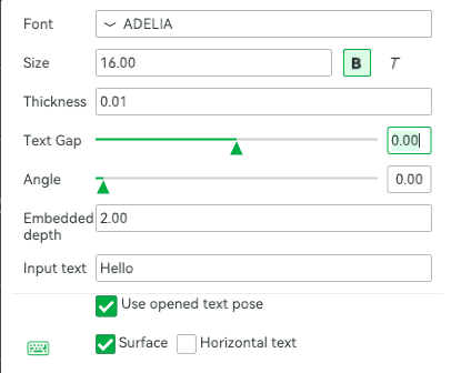

I have created a modified version for you.
HuskerCoaster_Colorized_v2 text test.3mf (1.1 MB)
There has been an issue with uploads recently. If the link doesn’t work, let me know, and I will share it a different way.
I tested it and it fails. I have created a WeTranfer link for you. It will only remain live for 3 days due to limitations of that service.
What I have done:
  • I removed the unnecessary top layer that was complicating things
  • I removed the painting you did; this complicates things
  • I set the layer you painted with a single solid colour, which gave back what the removal of the painting took
  • I tweaked the thickness so things line up
  • I changed the layer height to 0.2mm from 0.24mm, which was complicating things
  • I fixed your text layer.
  • I added an editable text layer you can edit as much as you want without any need to convert it to an object.
I set the text values as shown in the screenshot, taking note of the thickness and embedded depth values.
  • Delete your original text layer. I left it in so you could see it.
  • Then, change the font, text, and style as you wish.
  • Move it to where you need
