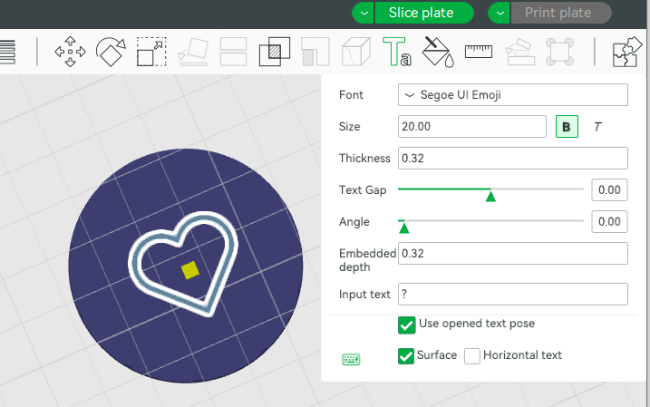

If on MAC you can use the apple symbols font it has many useful ones like the one you were trying to use :zap:or like :heart:
I get an error when I try to upload the screenshot showing the proof of this working, for whatever reason, so you will have to try for yourself
To add emojis in Bambu Studio on Windows 10, follow these steps:Open Notepad and set the font to Segoe UI Emoji (pre-installed with Windows).
Press Windows key + Period (.) to open the emoji keyboard panel.
Select your desired emoji, then highlight and copy it from Notepad.
In Bambu Studio, switch to Text Edit mode, select the Segoe UI Emoji font, and paste the emoji into the text field.
Note: I couldn’t get the emoji to work by typing directly into Bambu Studio’s text field, but you can try it to skip the Notepad step if it works for you.
