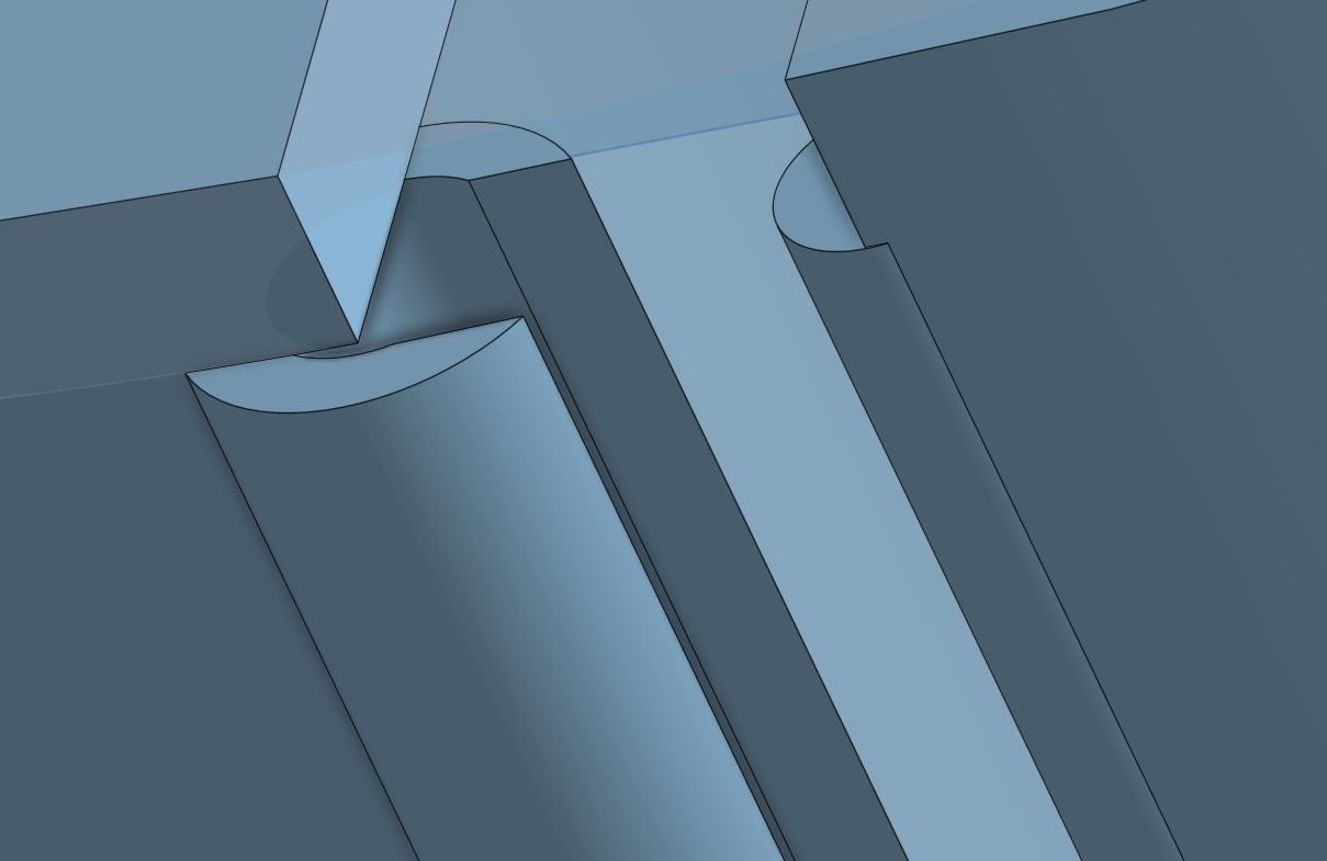

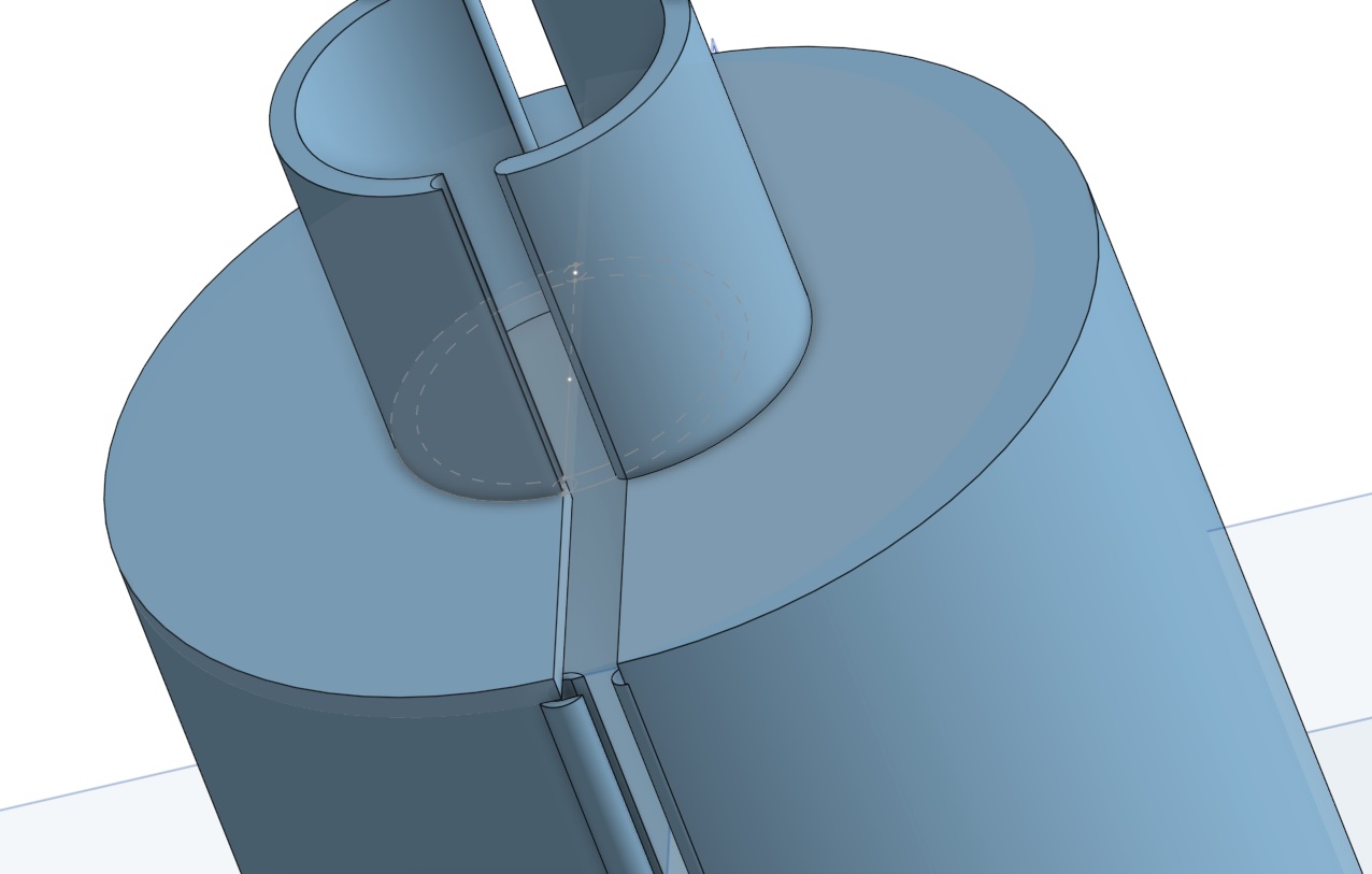

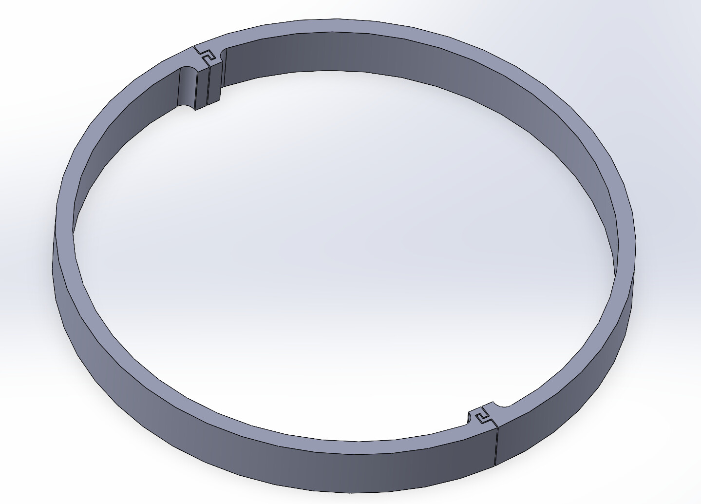

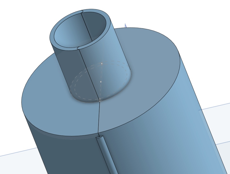

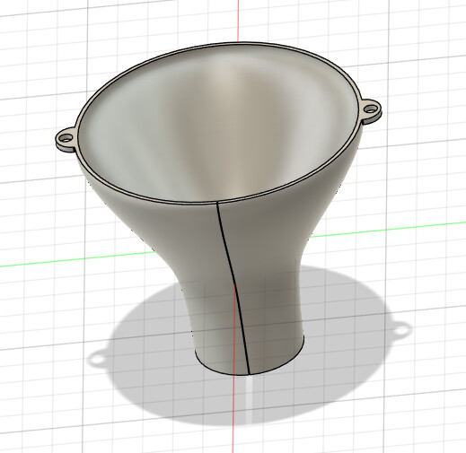

The two halves of a cylinder do not fit together seamlessly
Define what you mean by “cleanly”. We might be able to come up with a good solution for you.
By cleanly I mean seamlessly.
Push the joint into the model, instead of the edge of the cylinder.
If you make it thin enough you could just make a solid part with a slit on one side. Then pull it open, put it over the wires and let it come back together.
You can even push the joint into the inside of the model to give you more room to make the joint more beefy. This way you can make the outside smooth as well.
Like I said.
Great minds think alike
Important to point out that the size of the joint is one of the reasons that they are having a problem. Mocking something up now.
You’re probably right
If it was made with TPU, uses @PrinterMcgee idea and has a surface that can be glues, problem over.
My concern is, @proape is fixated on the previous solution and not open to new ways.
If that changes, I will also create another mock-up.
Right now, I am concerned further efforts will equally be ignored.
That does not correspond to reality. I am very open-minded :wink:

But that wasn’t really the topic, it was how I can print this cylinder neatly!
