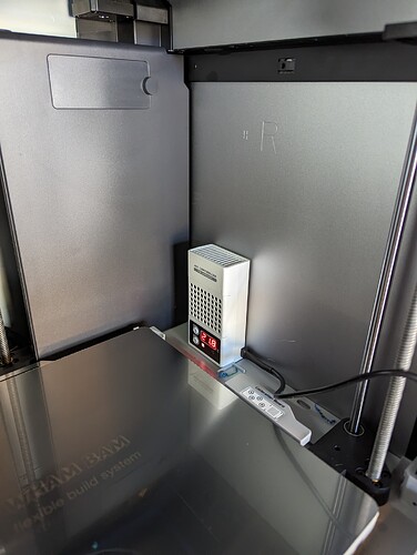

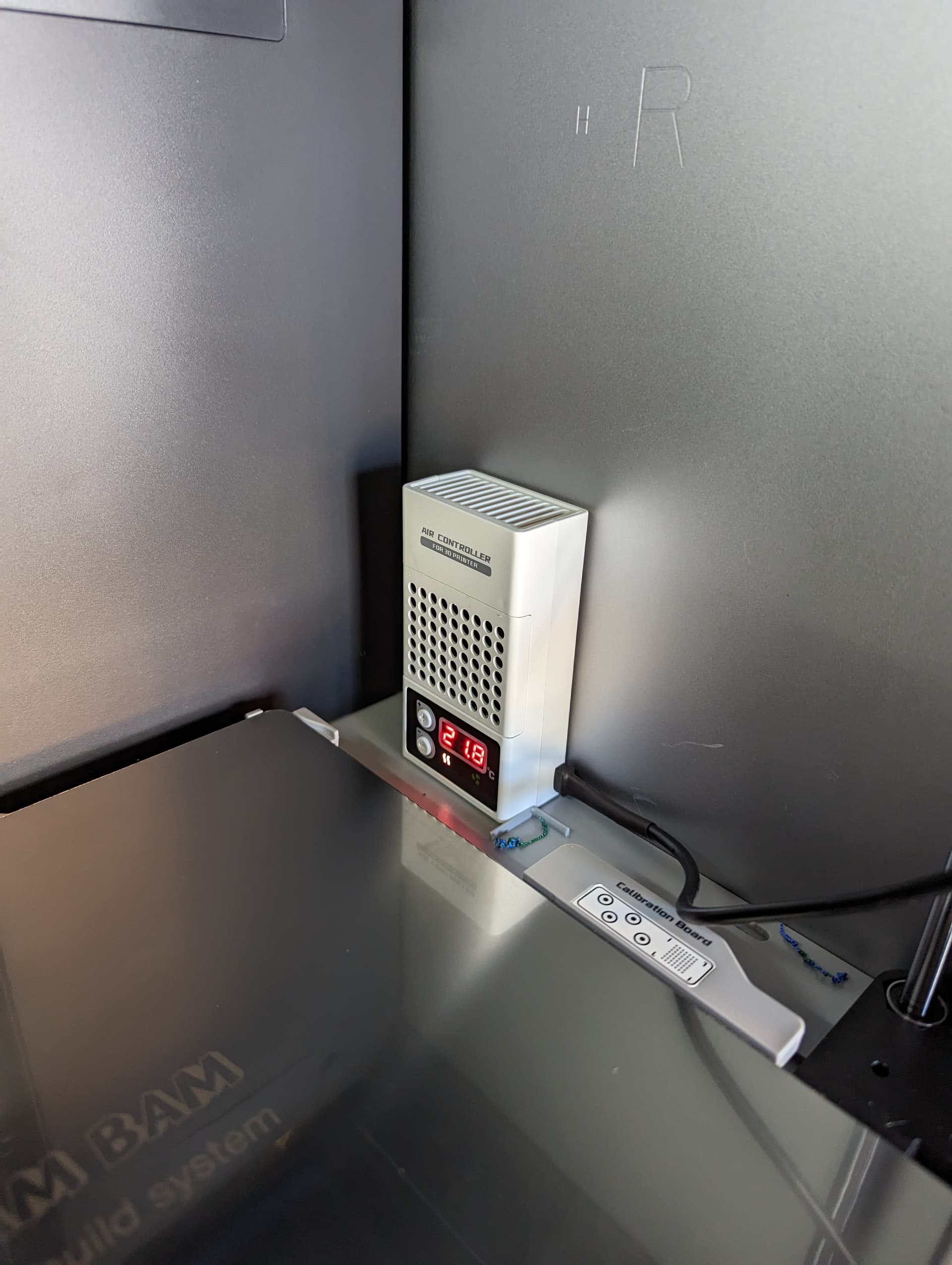

I found this item on Amazon and it’s seems like it would work perfect if you manually turn it on every print. I don’t think the temp will get up to 60C for dinner of the materials though. I also need to find a way to route power too.
Mini Heater for 3D Printer, Resin 3D Printer Temperature Controller Heating Thermostat Temp Control for LCD DLP 3D Printers https://a.co/d/6ftNWFW
