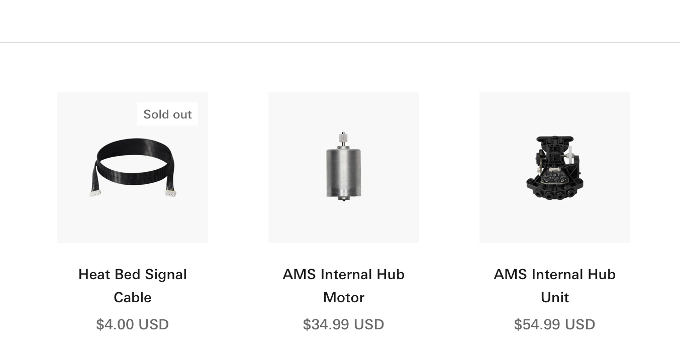

I think it will happen eventually.
They added two new AMS parts in the last couple weeks and a new heat bed cable in the last few days. I suspect more replacement parts of all kinds are coming soon.
