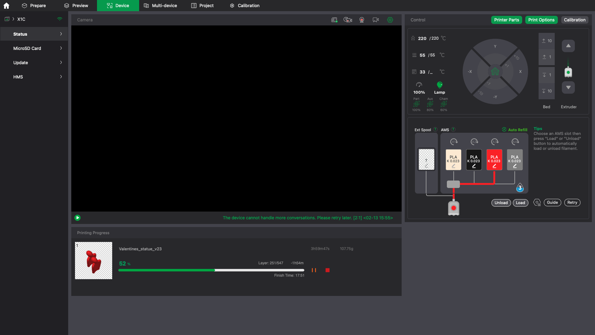

This device cannot handle more conversations
I read everywhere that people were facing this issue on X1C, and
it got fixed to some, but it’s still happening with me (newly introduced). What’s that all about?
I can only view the print on either the phone or the desktop app, and no longer on both.
In studio the live view will time out from what it classes as non activity

Thank you, I did enable it and disable it, but it still won’t work for me.

Well, I tried the old “turn the machine off and on again” way, and it somehow worked for me, but they definitely need to do something about it.
Here was my issue and the solution:
I had too many instances of Bambu Studio connected to my P1S on 2 different computers.
I closed all the instances of Bambu Studio on the upstairs computer and restarted the printer, then opened just one instance of Bambu Studio on the downstairs computer that was having the problem, and then it resolved it.
