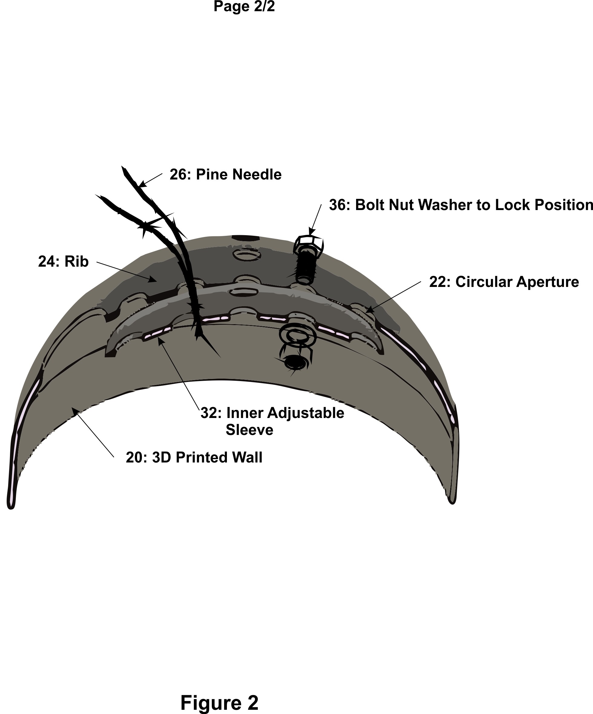

  1. “Needle-Gate” Filtration (Fig 2): Uses a debris-diameter logic rule. It doesn’t just make holes smaller; it creates an anisotropic constraint that prevents linear media (like pine needles) from orienting with fluid flow.
  2. Bioregional Moiré Adjustment (Fig 2): A dual-layer sleeve system (32) that allows users to manually “tune” filtration density for their local environment before locking it with a standard fastener (36).

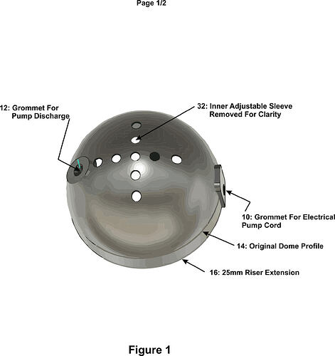

  3. Automated Asymmetric Ports (Fig 1): Automatically calculates the elliptical projection for off-center discharge vectors (12), generating the correct geometry for TPU vibration-isolation grommets.
  4. Procedural Riser Extension (Fig 1): A “Z-Axis” logic that adds a 25mm skirt (16) to increase internal volume without losing the original dome’s structural integrity (14).

I’ll take the ‘too complex’ comment as a compliment on the draftsmanship. The reason there is a line drawn for ‘pine needles’ is because that is a real-world failure point I’ve encountered and solved.
If you’ve ever had to clear a pond pump intake in the middle of a storm, you know it isn’t an abstract ‘scaling’ problem—it’s a physics problem. My ‘implementation language’ is specific because this isn’t a vague concept; it’s a filed functional logic for a TPU-based dome filter designed specifically to reject linear debris like needles and leaves.
To simplify it for the thread:
  • Standard Scaling: You make the filter bigger, the holes get bigger, and the pine needles get through.
  • My Logic: You make the filter bigger, but the Needle-Gate logic (Fig 2) keeps the aperture fixed to the debris size while adding more surface area.

If you have a functional housing for a water pump and you switch to a taller model, standard scaling in a slicer would distort the entire object, making the filter mesh too large and the structural ribs too thick.
With the Riser Logic (Fig 1), the slicer identifies the base and simply ‘extrudes’ the vertical walls by the extra 25mm needed to clear the new pump height. The rest of the engineering—the dome strength and the Needle-Gate apertures—remains identical.
