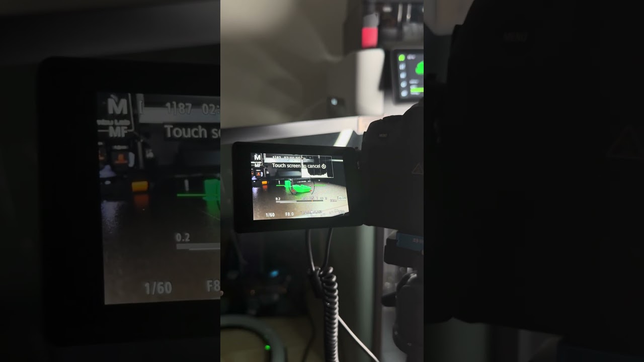

Sorry to hear that. I’m still experiencing the exact same issue, even after contacting support and repeatedly pointing out that this is a problem with the board or its firmware.
I’ve tried everything… Replacing cables, replacing the board (which I had to pay for), even filming the malfunction — but talking to support feels like talking to a brick wall.
I have also taken over 100 picture with a remote trigger just to prove that it’s not a problem with the camera or cables.
They blame anything else instead of actually taking responsibility. I have yet not seen any tries to actually send over a new firmware or accountability that they are looking for a solution.
I’ve also tested on an A1 with the same result, and I want to stress that the problem occurs regardless of which camera, cable,printer or cyberbrick control board I use.

Video showing the failure to trigger the camera — at around 30 seconds in, you can see the missed shot:
