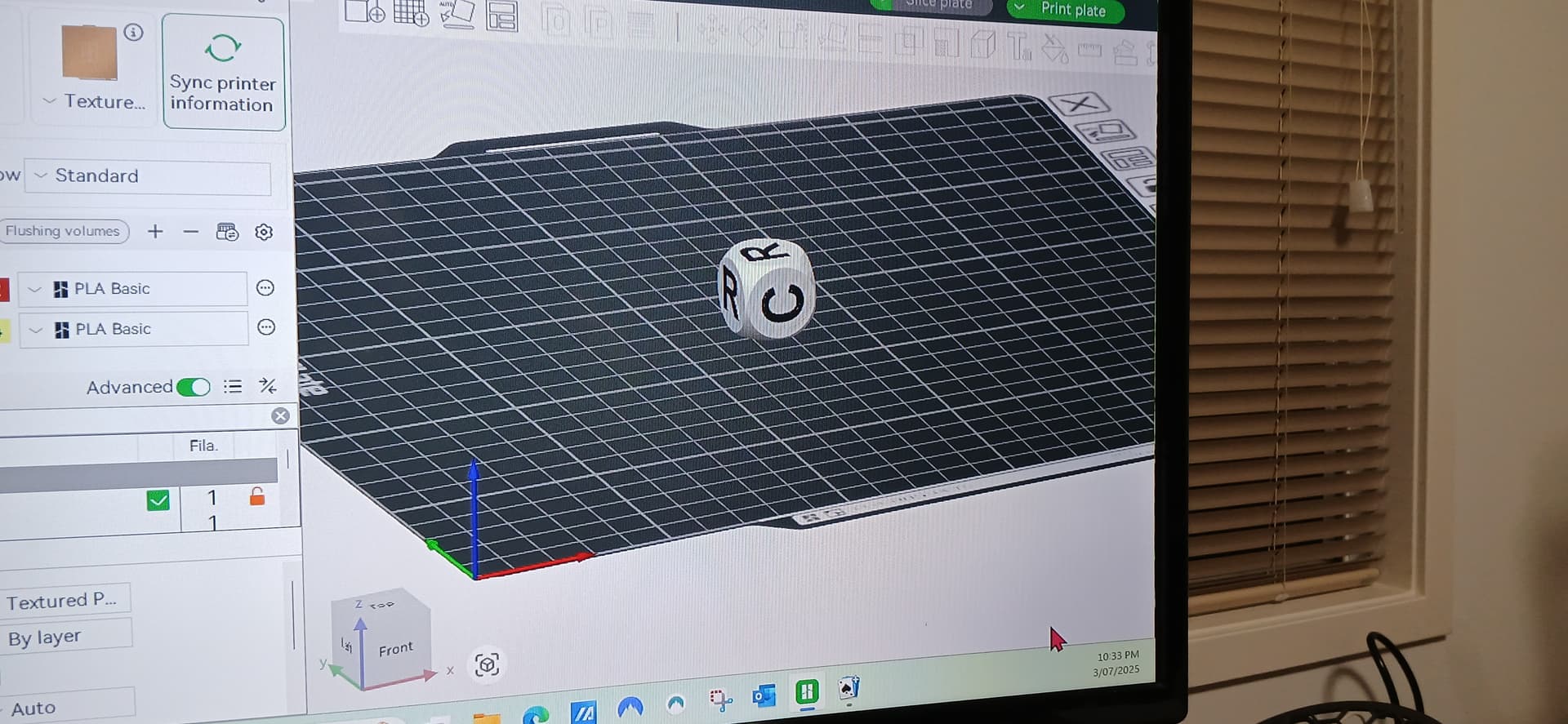

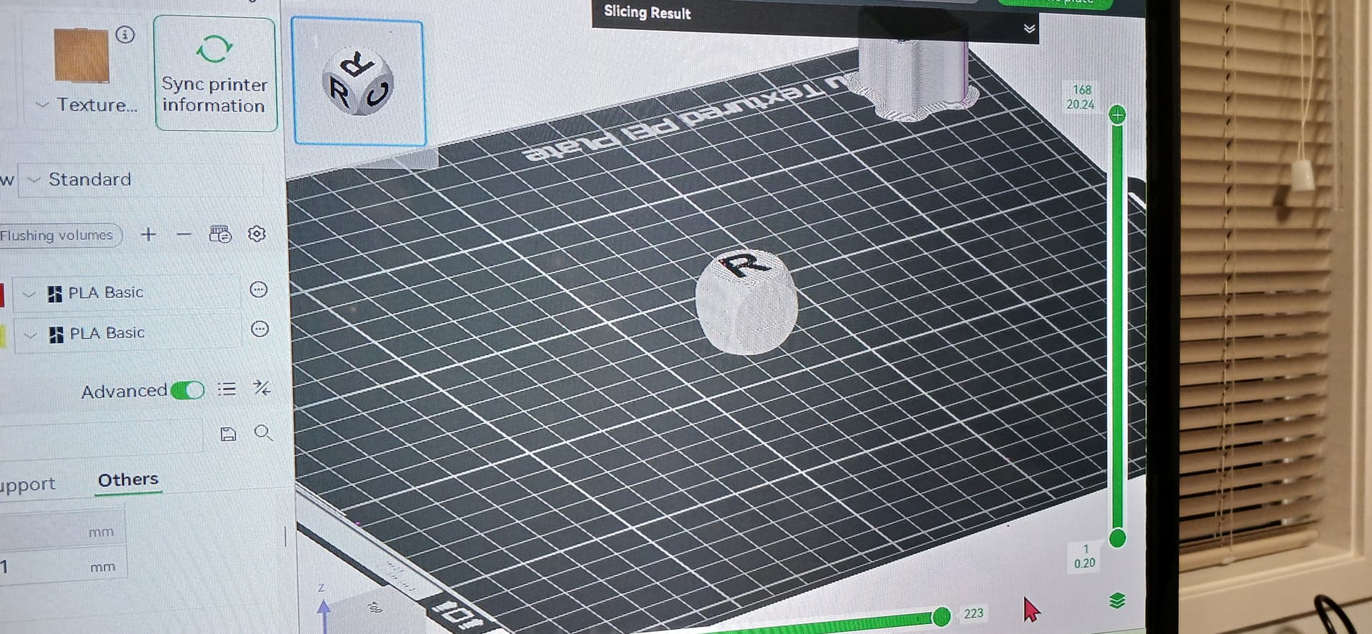

The last comment i did in bambu lab adding the colour. It will print what is in the top and bottom side in the dice but nothing on the side. In the sliser i see what is going to be printed which is now the top and bottom and nothing else, and in the side of my screen it shows the slicer dice with colour on all sides. Not sure what the little screen means.
Attached is picture. First in prepare mode, second in preview.
