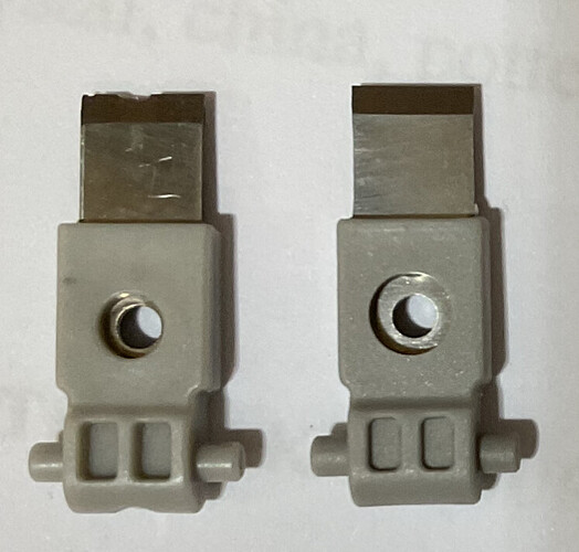

The first time the filament broke (just below the extruder PTFE tube), I chalked it up to wet filament (brittle?).
The second time, it was another brand new spool of filament. The third time, it was brand new Bambu PLA.
While learning how to remove the stuck filament from the extruder, I took most everything apart. It turns out that with the right very small needle nose pliers I was able to grab the stuck filament from the top and pull it out. Easy.
Put into perspective, one broken filament after 600 filament swaps is not too bad, but why?
I noticed something when taking the extruder apart. The cutter blade was chipped. I don’t know if this was the cause of any problems, but thought I would post.
The picture is a new blade next to the one I swapped out, and THANK YOU Bambu for including a couple spares!

i guess somewhere pushes it to the side, by moving the extruder head
The printhead moves to the left front corner of the machine and it presses the cutter lever arm against the left side of the frame, which pushes the cutter in to slice the filament.
BBL chose to do it this way, I suspect, because pulling the filament back without cutting it would require the hot end to stay hot, so the filament won’t pull back cleanly, it’ll “string out” and then you’d never be able to push it back in to the extruder again. Cutting it clean eliminates both the pulling back and the reinserting problems you’d get if you didn’t cut it. Probably the only way to do it reliably enough to make the AMS viable.

If the blade was chipped I’d wonder where the chip ended up - if it ended up going into the filament path it might have caused a clog.
I think the nibbled blade is a sign of wear and tear, especially when carbon fiber, ABS, ASA or other stable filaments are cut, material fatigue occurs more quickly.
