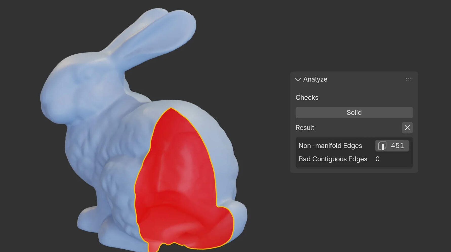

Blender is definitely the way to go. Why? Because AI models generate meshes. With the help of a few tools, Blender can correct the most serious errors made by AI. For example, it can close small gaps that confuse the slicer and repair faulty models. For this, I highly recommend this plugin:
Even if you don’t want to get that deeply, you should at least familiarise yourself with one feature of the plugin: checking models for errors and performing manifold processing. Unfortunately, AI programmes almost always produce 3D models with tiny gaps or unconnected edges.
Checking manifold can often save you hours of headaches when troubleshooting.

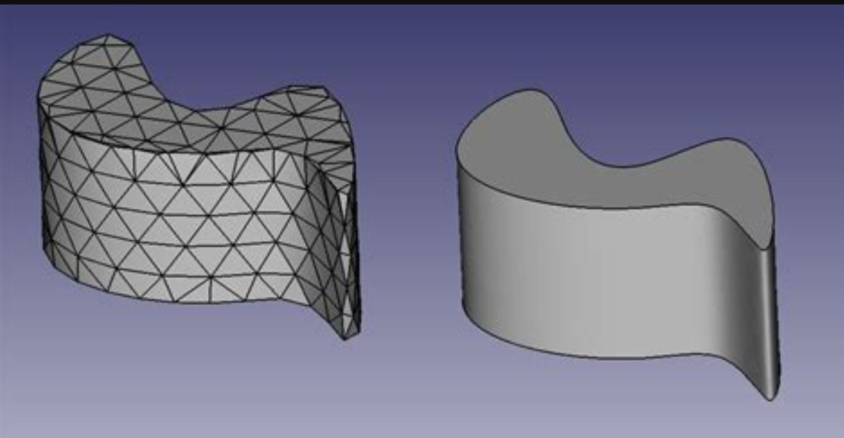

It’s important to bear in mind that you need to consider your workflow. AI always generates meshes. Programs like Blender are specifically designed for meshes. CAD programs often have problems with meshes, however.
If you’re not familiar with “mesh,” think of it as an empty shell - that’s why it’s so important that it’s closed.
Left: Mesh - Right: CAD
Also, as Bullocks already mentioned, you can easily remove or smooth out unsightly or unnecessary spots.
