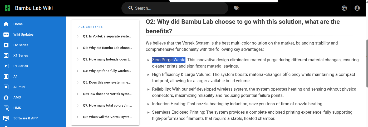

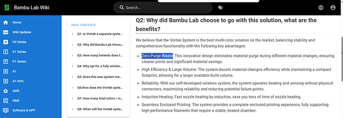

IIRC, Bambu promised zero-poop, not zero-purge/zero-waste.
Right. Still priming, rather than purging.
I presume there will be a bit of retraction before the cut is done, Hopefully by the time priming has finished the cut will be far enough into the melt zone to fuse back together again.
While a disconnect between the old and new filament may seem like an issue remember that retraction is done to remove the pressure the filament in the melt zone has on it. It doesn’t actually need to remove the filament from the melt zone, only give it space to allow it expand upward instead of staying in compression and as a result it is forced out the nozzle orifice.
Exactly, there is a difference between purging and priming. I’m pretty sure all the multi head systems (XL/U1) currently still need a prime/wipe tower on the bed.
If you’ve used the auto refill via AMS, the extruder will quickly purge some filaments. I think this is to even out any flow inconsistencies from what is essentially two piece of broken filaments in the ‘connecting’ spot.
Technically it’s still ‘zero purge’ if Vortek just ‘purges’ this same amount on to the prime tower :smirk:, but we’ll see.
Sorry, I used the wrong wording. What I should have written is that Bambu never promised a zero-prime system, not a zero-poop/zero-purge/zero-waste system.
Indeed, they highlight that they ensure significant material savings, but are not promising zero-waste, zero-prime.
Well spotted :heart:
