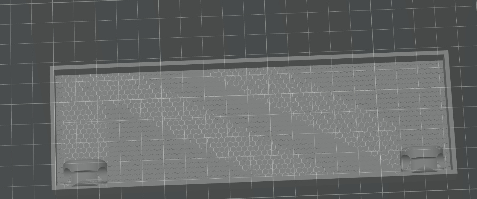

I wanted to print something that has a hexagon surface pattern on top.
I created this hexagon pattern, it is 0.2mm high, and starts at 2mm. I am printing with 0.2mm layer height, so in theory, the 11th layer should be printing this hexagon pattern.
It shows up fine in the “Prepare” tab in Bambu Studio. However, slicing doesn’t show it, nor does it print. I don’t understand why.

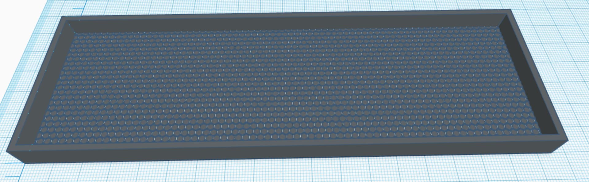

This is the object. The bottom is 2mm high, and the 0.2mm hexagon pattern starts at 2mm.
Here it is in Bambu Studio. Shows some shading, but the pattern is there.

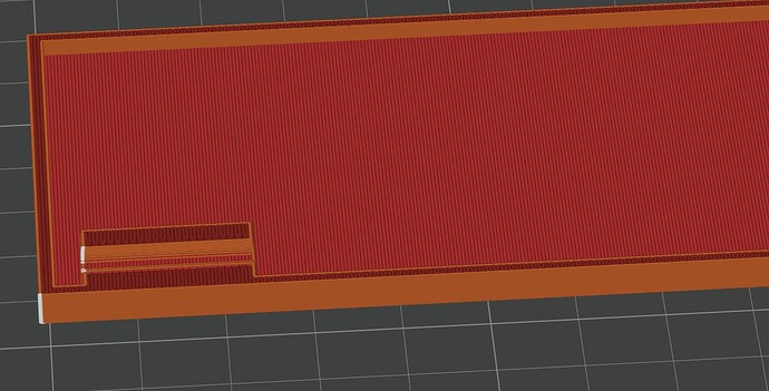

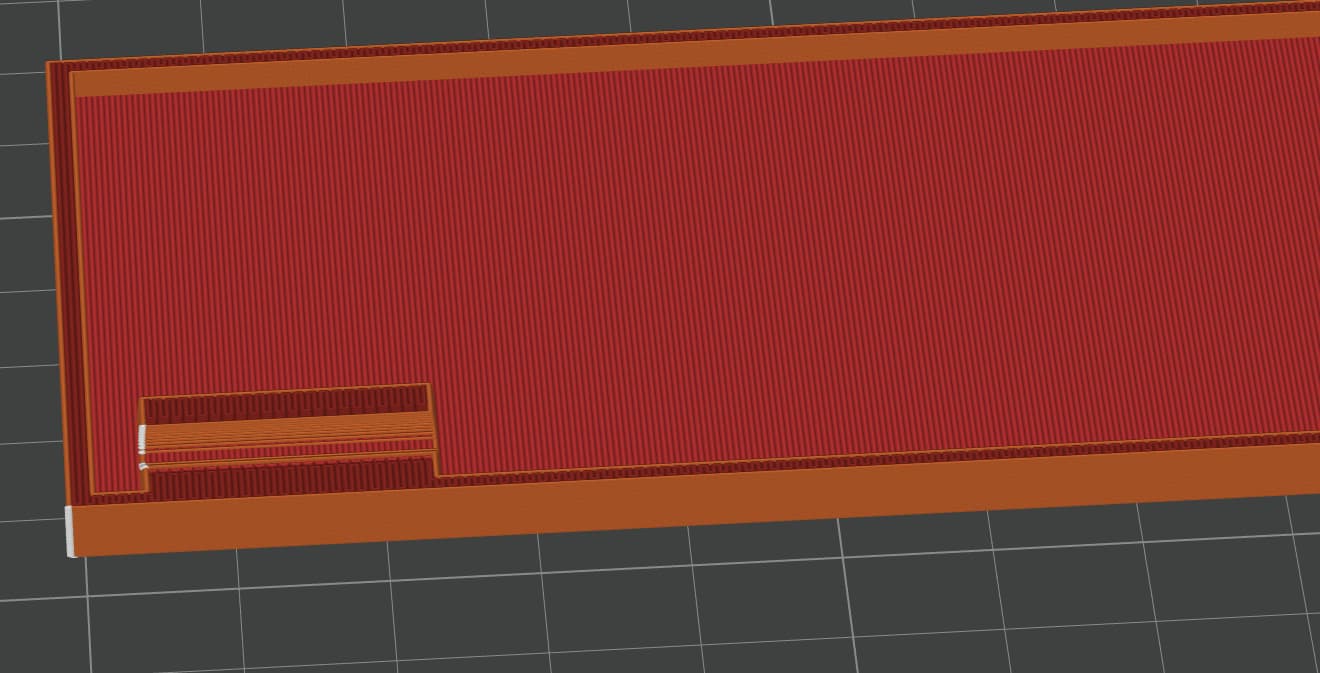

But when I slice it, the pattern is not there, with 0.2mm layer height. Not even with 0.08mm layer height.
ok but is the line width within the hexagon pattern bigger than the nozzle diameter you are using?
did you try slicing with Arachne wall generator selected?
How wide are the raised hexagon sections? They need to be at least .4mm or the slicer will ignore them.

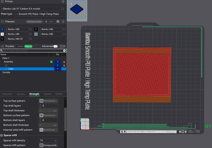

There is a better way to do this by adding a cube with the top and bottom layers set to 0 and using honeycomb infill.
This^

Thanks! Arachne seems to show the pattern!
They were (are) 0.2. I will try the cube you are suggesting, thank you!
