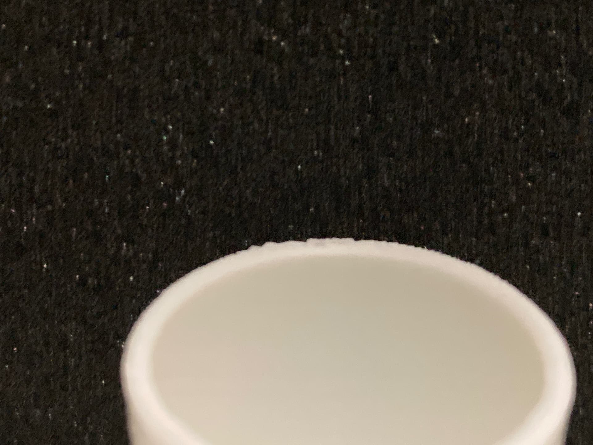

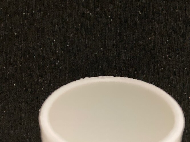

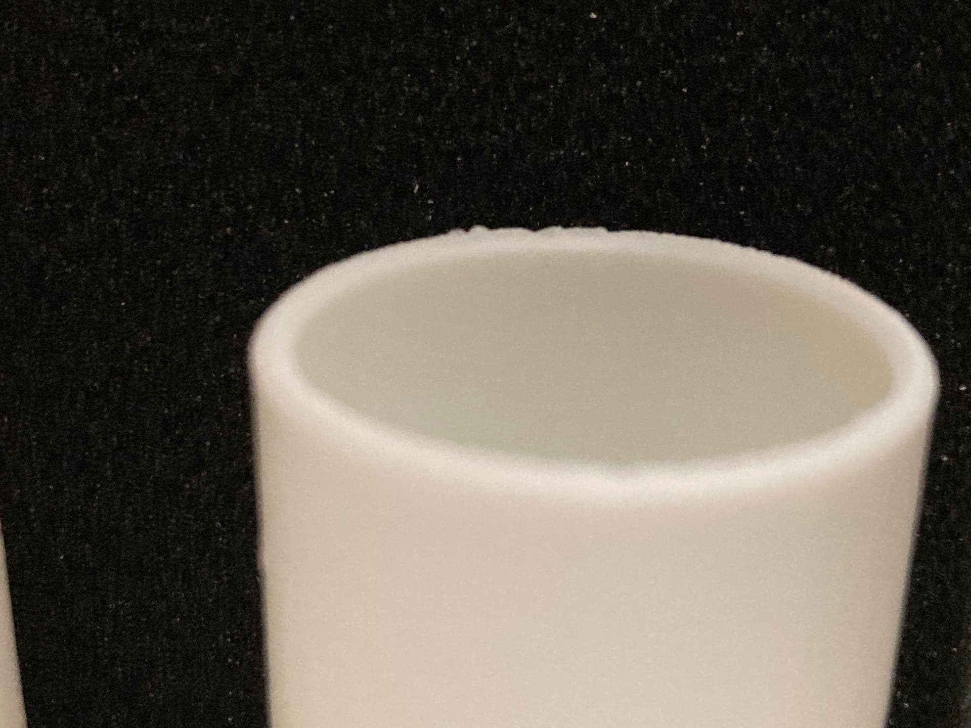

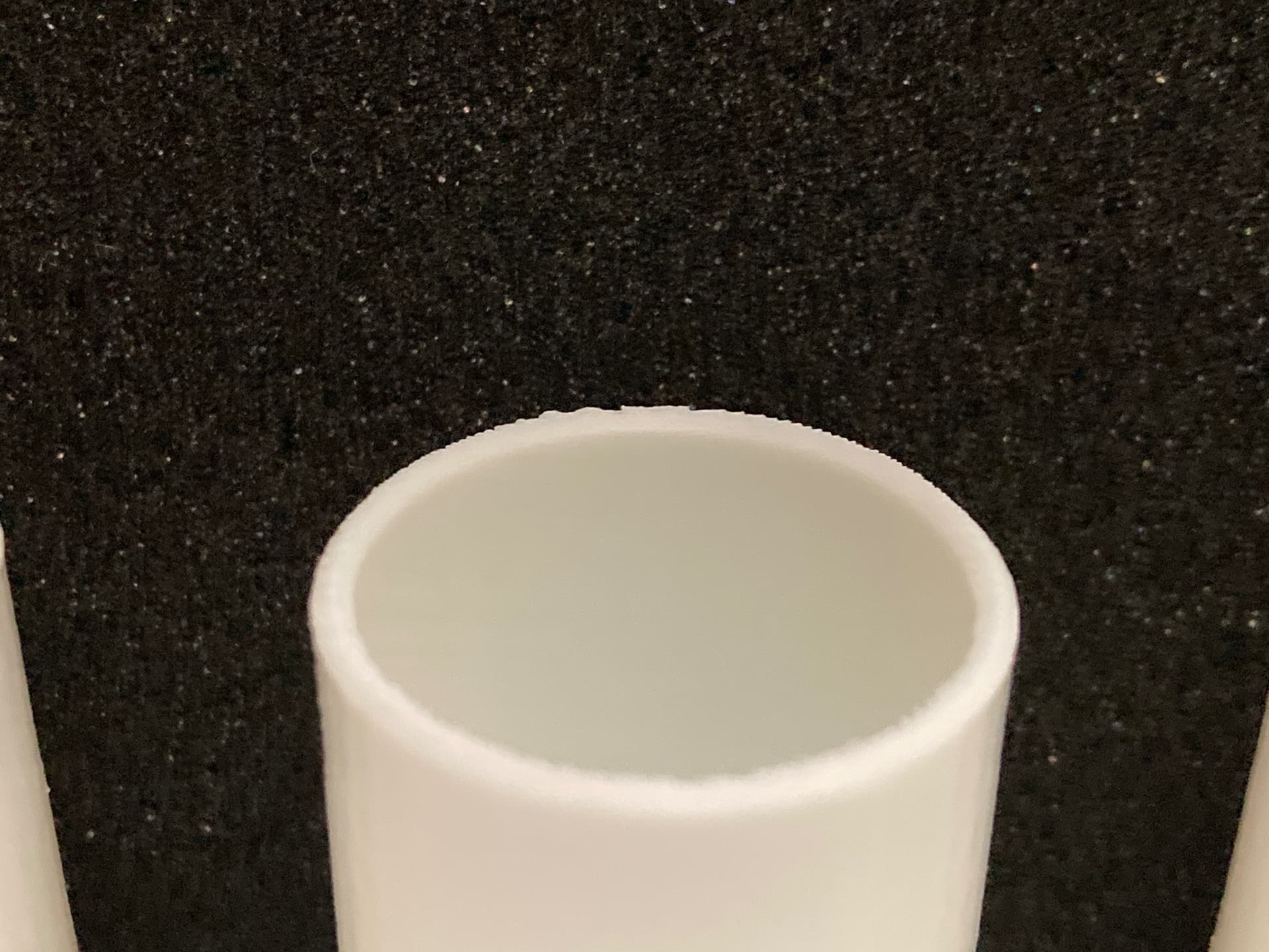

I put a black backdrop behind the cylinders to try and show the rough edges.
.16 layer height on X1C, cylinders are angled at 53°
I have ironing set to top surfaces. I have top surface layer speed set to 200 mm/s.

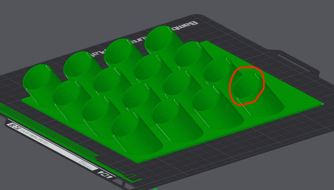

The rest of the print is smooth. Only the top of the cylinders that is a problem. Is there a setting that could help fix this issue?

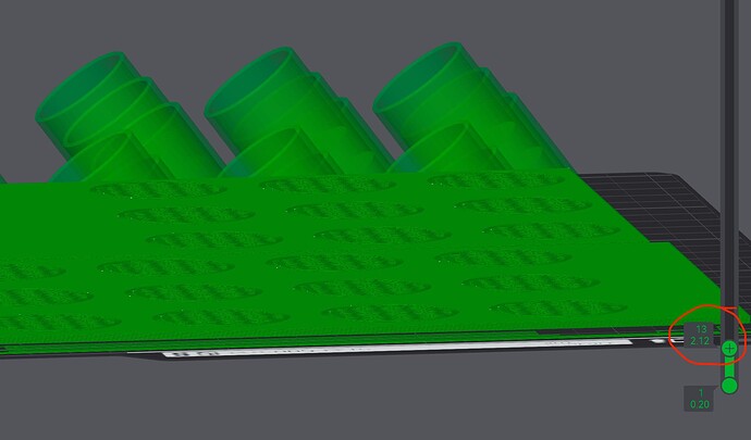

- Add a layer height modifier and set the dimensions to cover the cylinders portion.
- Select the layer modifier if not already selected.
- Now, disable the ironing for that region.
I can try this.

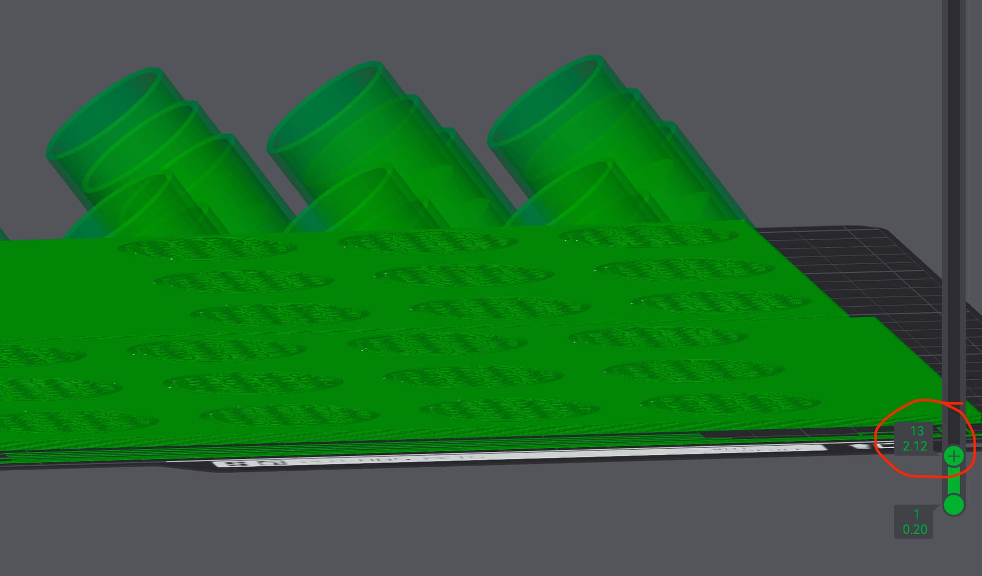

Would the best way be to slice it and use the bar on the side to find the height?
Then go back to “Prepare” and use “Height Modifier” to adjust the settings?
The cylinders are faceted a bit as well so hoping to correct that also.
You can use the bar on the right, just remember the modifier uses mm and the bar denotes layers on the top and mm on the bottom.
Use the bottom value in the little box as you slide it up as the lowest of the two figures you provide.
You could use the same modifier to reduce the layer height for the selected range to improve the quality of the tips of those cylinders.
Alternatively, you could use two different modifiers (which can overlap) to make the changes exactly to the areas of focus.
You can have essentially unlimited layer height modifiers and any combination can overlap with any number of setting changes.

I was not aware Ironing only works for surfaces perpendicular to the build plate/nozzle. Thanks for pointing that out

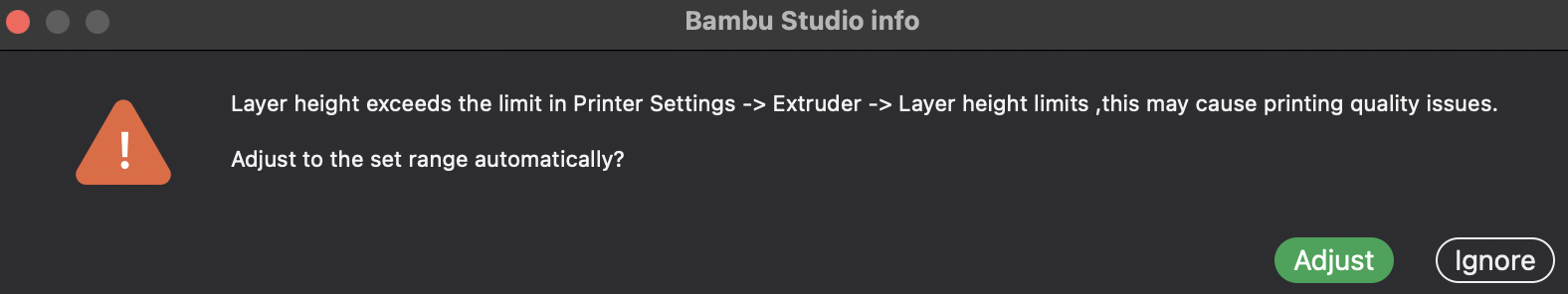

I get an error going to .08, I can go to .09 with no error message
The wall generates is unlikely to be the cause of your issues here and is mostly used to fix issues where the walls of complex shapes like letters need to be fuller than the originally designed model considered.
It is essentially irrelevant to this model, but a great feature when actually required.
If it warns on 0.08, 0.09 will be fine. You could go for 0.1mm as it is 50% of the standard 0.2mm and simply math equation (I like those), I pointed out earlier that your presumption of the thinnest possible wasn’t true, not necessarily suggesting you must exceed it.
