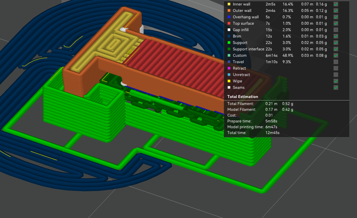

I am printing some clips that require strength in a particular direction.
Initially I printed the vertically and they just snapped (because the because the inter-layer adhesion is quite weak) I am printing the part sideways for this reason.
I noticed you can set the Infill Direction to 90 which is helpful for getting the internal extrusions to print in a direction that makes the part stronger.
How can I set the skin layers to also print in this direction? This would make my part stronger.
At the moment you canm see the red fibers are in a direction that provides no strength. I’d like them rotated 90 degrees or cross hatched at 45 degrees.
rotate the object before slicing
