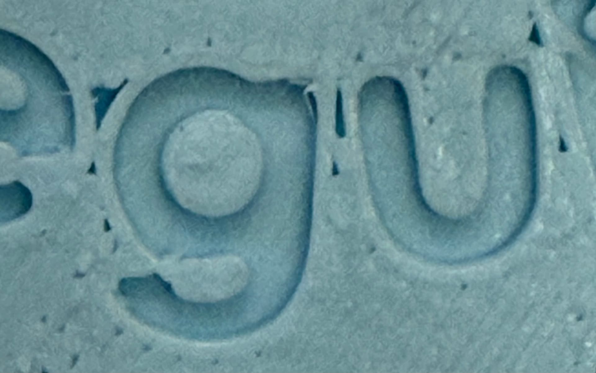

Top surface divots near debossed letters
I’m printing matte PLA disks with debossed letters and getting divots in the top surface near the letters using my new H2D with all default parameters.
I tried these changes:
  • top surface width from .42mm to .35mm
  • top shell levels from 5 to 3 (with 0mm thickness specified)
  • top paint penetration from 5 to 3
  • top surface speed from 200 to 100 mm/sec
  • top surface pattern from monotonic line to concentric
    No joy. Any suggestion?

I did a “Flow Dynamics” calibration from Bambu Studio, followed by a “Flow Rate” calibration. It didn’t help. Here’s a closeup of what’s still happening.

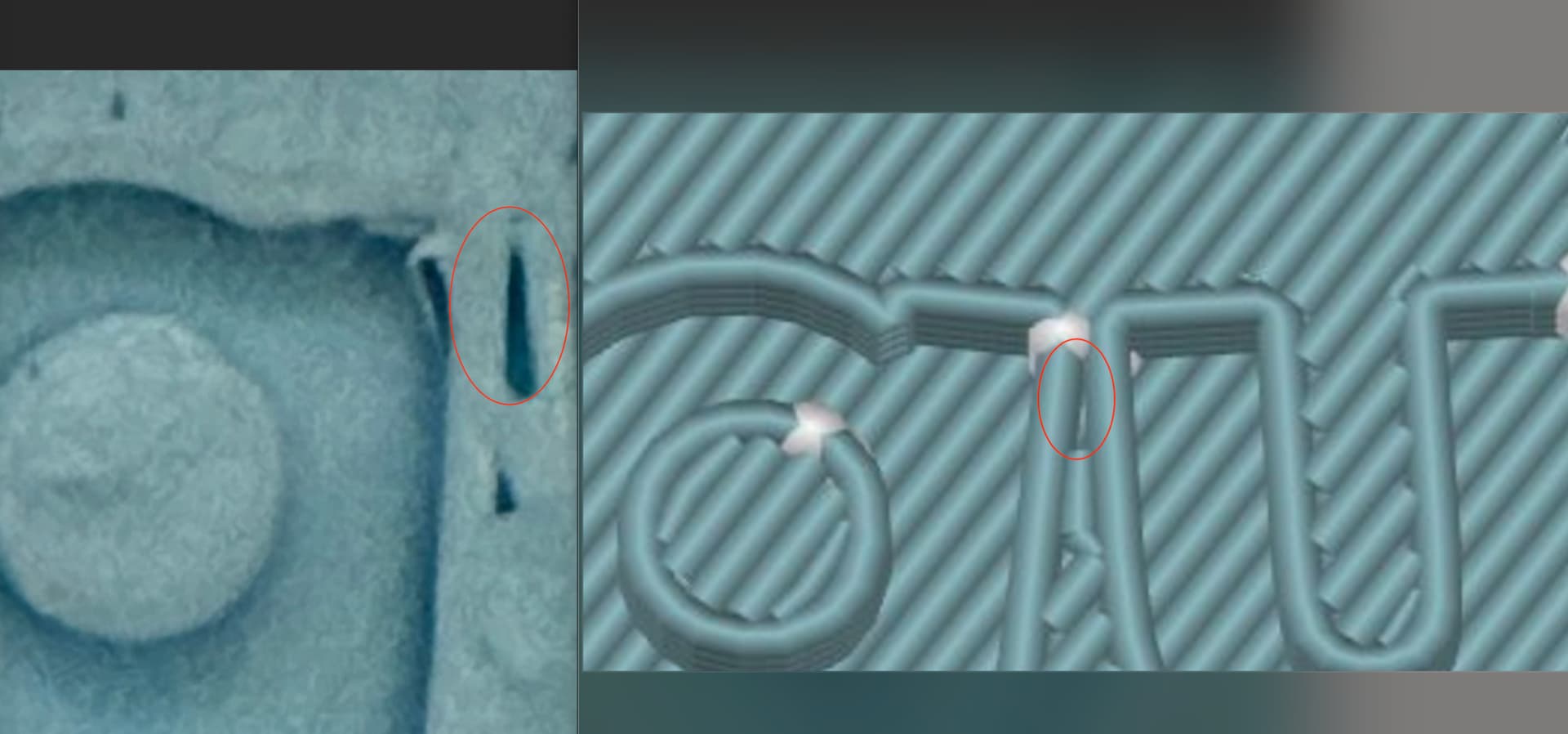

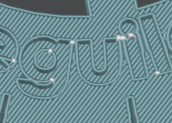

I’m not sure what you mean by “a picture of the sliced file”, but here’s a piece of the top (13th) layer from the preview that corresponds to the photo above.

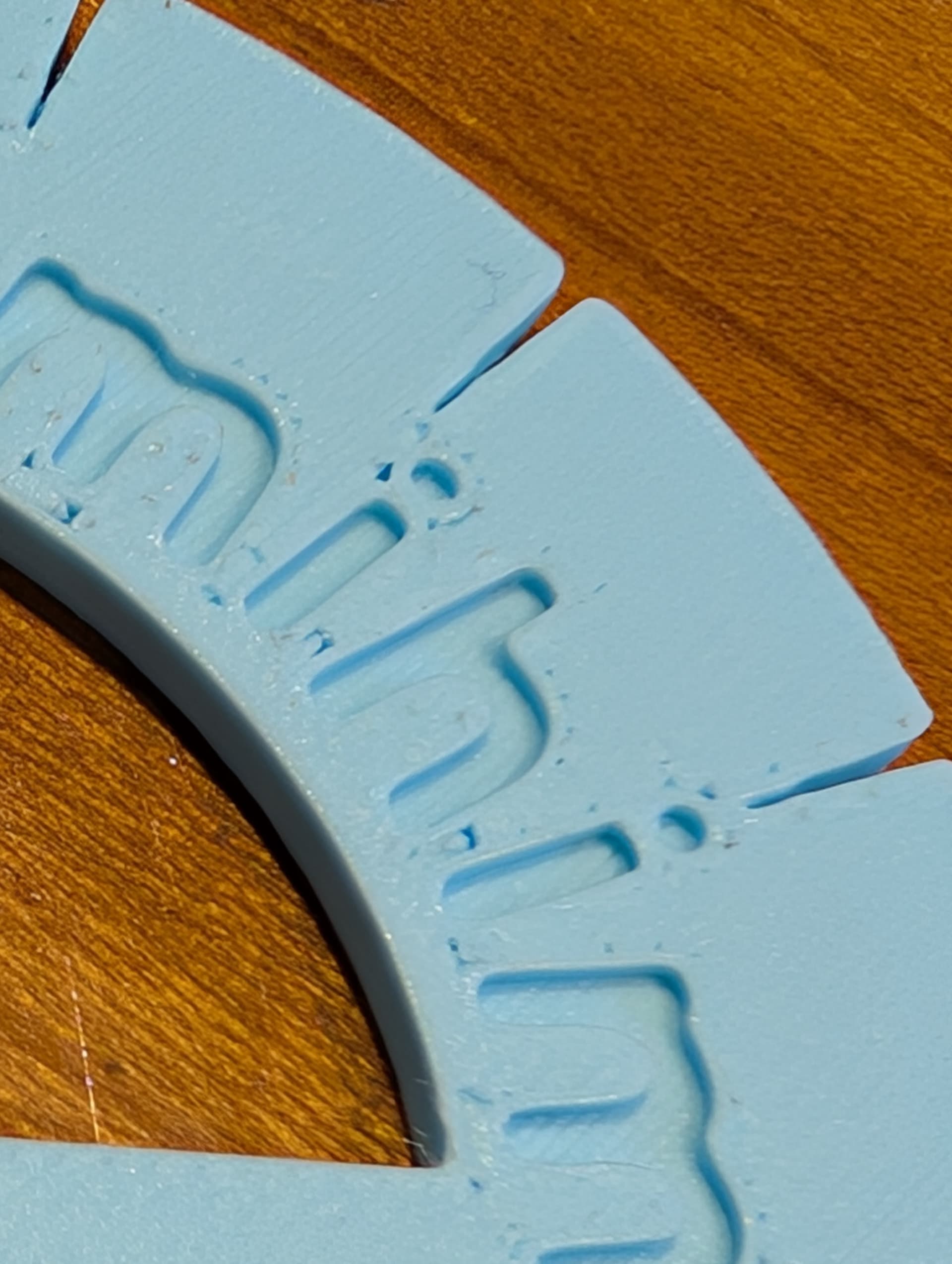

This is somewhat normal when doing letters.
You need to bring the line width as small as you can. or spread the letters out more
You can change by-layer the layer settings. there are guides on youtube and also you could try adaptive and select the bottom layers to be as fine as possible.
You can see it’s telling you
“LINE TOO THICK!!! IT NO FIT!!”
You can also apply a lower one wall modifier to the text if your part requires more than two outer walls. However, as Unloco mentioned, you’ll need to increase the letter spacing some. After that, you can fine tune the infill/wall overlap for your filament if necessary.
This is why I wanted to see the sliced file because it will show you in the slicer that there is going to be a gap due to settings or text spacing. You can try to mess with settings and then look at this view and see if it helps minimize those gaps. if the gaps are really large, it won’t be able to fill it in with just extrusion. If they are very tiny, you will probably never see them in the print
Those letters are too close together. If you can change the letters to be more spaced it’d be better. Besides that make sure to be printing at a high quality small layer like .08 with wall generator set to arachne. Also try slicing in concentric for top layer infill just to see what you get. Concentric will fill by following the outline of the letters.
