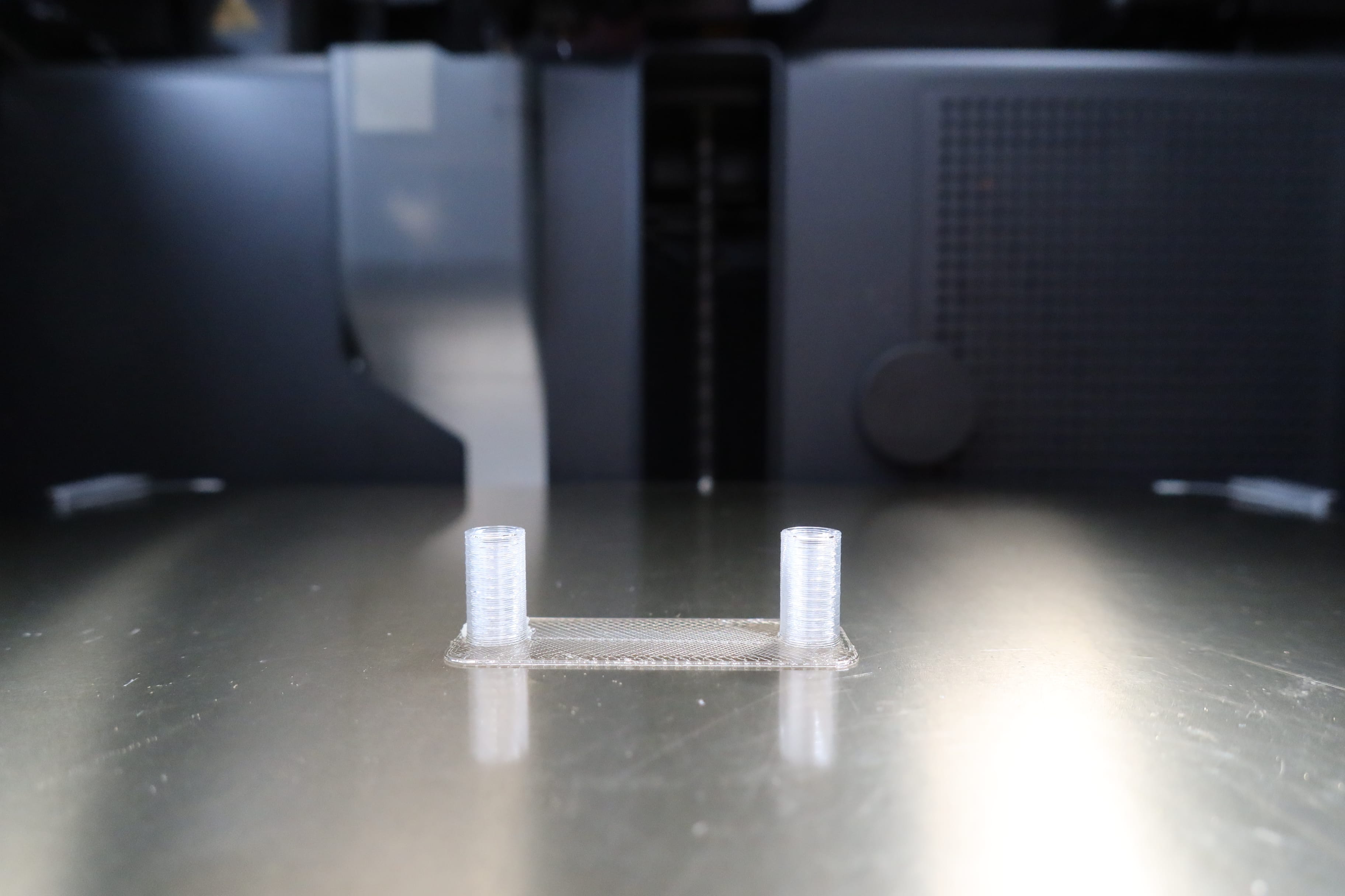

There is stringing on my model printed with Extrudr Flex Semisoft filament, using the filament profile provided by Extrudr. The retraction length is set to 0.6 mm. The filament has been dried and I print directly out of a filament dryer.
I then printed the retraction calibration model from the Bambu Studio “Calibration” menu with the same filament profile and a range from 0 mm to 1 mm. To my surprise, there is no stringing at all:
Both prints were made right one after the other. I know that people will say “Dry your filament”, but I specifically want to understand why there is no stringing on the retraction test model and stringing on the real model. Any ideas?

The Y-model is printing at 33 mm/s and the retraction test at 10 mm/s. The temperatures (nozzle / bed) are identical.
I will print a larger Y shape and see what happens at larger distances.
This is interesting, when I print the same model at lower speed, there is less stringing. After drying the filament some more, it is gone.
