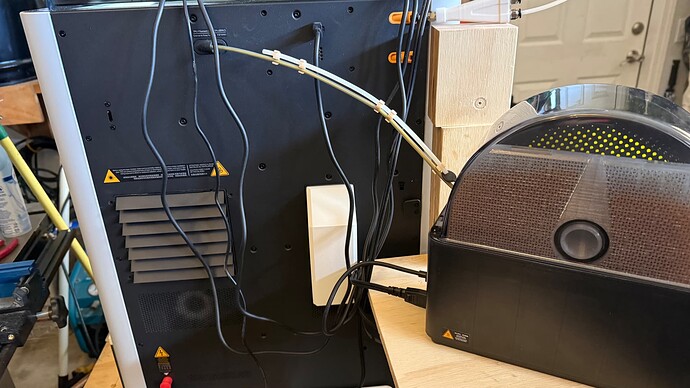

This is my setup. I’ve printed from the top but this seems like the best setup and is also how I print carbon fiber filament
Note the teflon tubing is two pieces to allow easy feeding of the filament.
The spool is suspended on a shaft with a bearing, that has less drag than using the two rollers inside the Ams ht
The exit angle is also part of keeping the drag down.
The bearing support doubles as a container for extra desiccant
