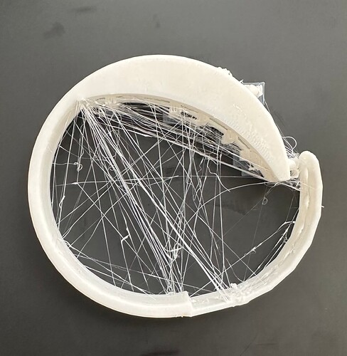

Hello all, I gout a new filament and dried it for 8 hours at 75C in the oven, settings for perimeter crossing checked, reduced printing speed to 30mm/s but all that does not seem to help. I used TPU 98A before and that worked well but with this new 95A not good. Does anyone have some ‘blessed’ settings for a 95A ?

Next, you’ll of course need to calibrate the filament, at least flow dynamics re stringing.
Regarding settings, enable “wipe on retract” in the filament settings.
Final tweaking can then be done on retract length (Bambu recommends 0,8-1,4mm) and, to some extent, retract speed (20-40mm/s).

Make sure to have “wipe on retract” enabled. In my experience, that is the first, most effective step. I use retract settings to then get rid of the remaining hairs.
The retract settings did a lot of improvements - will adjust further
That does look a lot better :heart: :+1:
To further reduce stringing, you can try to calibrate flow dynamics. The Pattern method with my mobiles magnification works best for me. This will tackle the tiny hairs left when a print path has stopped, but there’s still some minor oozing.

retract length of 1.2 mm and ‘retract on wipe’ now results in completely string free print - very happy!
