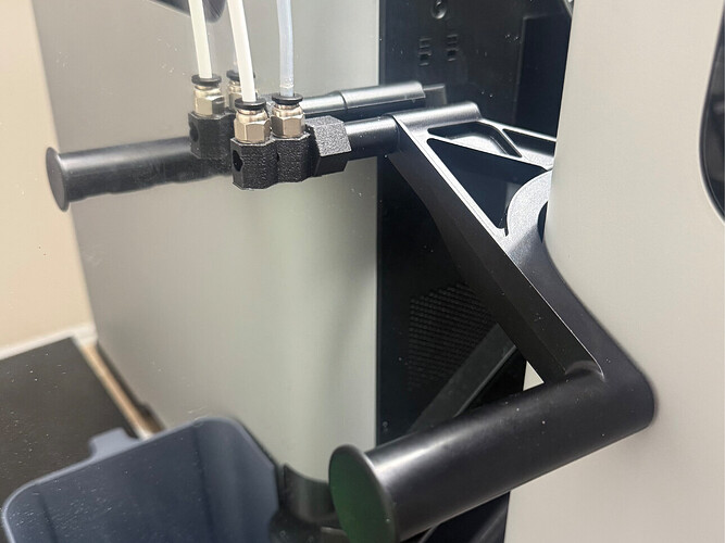

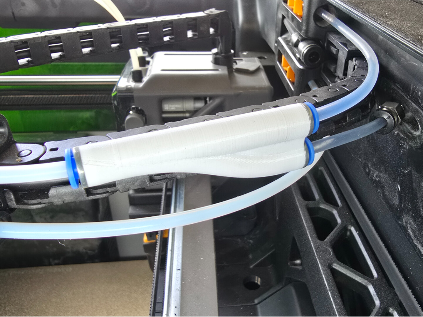

@MalcTheOracle - this is what confuses me please, if I want to set up to print TPU and some other material and leave set up then I route the 95A through the dedicated slot to the right nozzle and connect the AMS to the left nozzle. But, I believe Bambu suggests doing most of your printing from you right nozzle which means if the bulk of my print (i.e. electrical enclosures with seals) is not the TPU then I am not printing the bulk of the prints with the correct nozzle. Also there will also be non-TPU prints using the AMS on the left nozzle, again not using the correct nozzle. Seems like a catch 22 situation. Don’t use TPU in AMS and must be on right nozzle but don’t use AMS on left nozzle for bulk of printing so there is no optimal solution here and I think this is the frustration here after shelling out $2300 in my case, there should be a Bambu level of easiness solution here
The simple solution to this is a splitter inside the chamber and dual feed tubes on the external spool. That how mine is setup and its always ready to print TPU without doing anything to the printer.

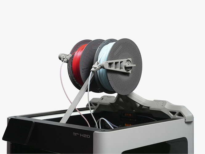

You don’t even need a splitter. unplug the right ptfe and drop the filament straight down. Use a shelf above or print a spool holder (what I just did) 95 from sunlu worked fine. Printed well and hadn’t been dried in a month. (in bag for that time) 12 hour print. no hangups like I’ve always had with same on my external mount for my X1C. I think the OP protest too much.
Printed with 95A, 90A 85A, and Siraya Tech TPU Air down to 65A print settings and I’ve never had anything but perfect prints on my H2D. It just needs a direct, low-resistance path to the right hotend. Bambu provides a model for this exact purpose and it’s never failed me
