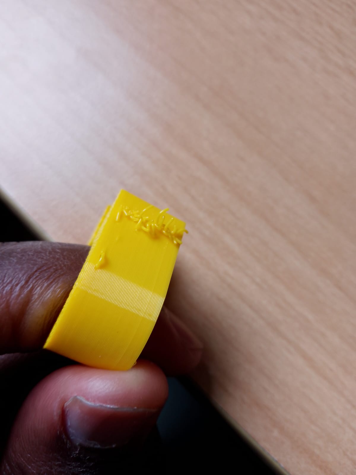

Hej,
I printed out with generic TPU and the filament are bumping out as shown in the picture.
any idea what caused it?
REgards
MAmo
Do you have timelapse turned on?
FWIW, my understanding is that printing TPU slowly gives the best results. I imagine that due to the flexibility it doesn’t just leap out of the extruder when the filament is advanced, and will tend to ooze.
I agree with this. It looks like it’s leaving the print to do a time lapse photo and then coming back. Since TPU oozes you would get a little string every time it leaves the item.
Either this or you’re doing two items at the same time. I try to only print one TPU item at a time to avoid this.
